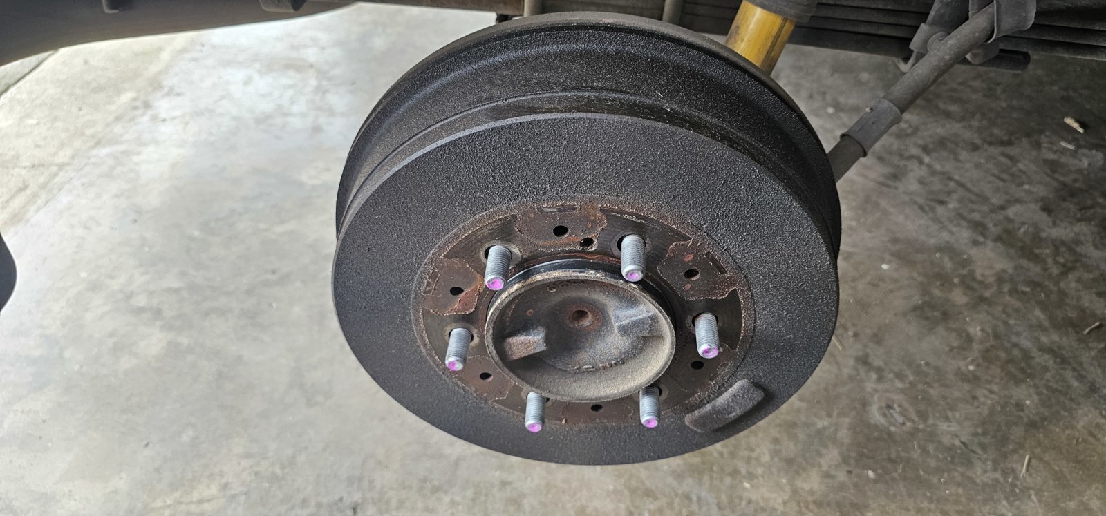

    Was rotating my tires yesterday to find my passenger rear Axle shaft seal is leaking.
    Must have just started as there are only a few drops on the inner fender and overall it's not too oily
    Of course its just beyond the warranty -42k
    Anyone else have a seal go fail so early?
    Also, dealership quoted $680 to replace.
    Seems quite steep. Since I aim to do it myself, is there some 'trick' or special tool needed to justify the high dealer cost?

    Is the only evidence of a leaky seal some oily substance on the inner fender?
    Also I’m not sure what I should be looking at in your pic of the outside of the brake drum.

    KDMax pro 9.0
    X2 . Im not sure where to look at also .

    OP, before you spend a bunch of time and money on this, I think you should make sure the seal is actually leaking.

    I can't imagine what else it would be.
    Smells like gear oil.
    The drum has a nice film of oil vs the other side which is dry as a bone and orange with surface rust from the lovely coastal air.

    I personally would not suspect a failed seal until I inspected the seal. Oil on the fender could have come from the ground, to the tire, to the fender.
    Your pic of the drum doesn’t look like an oil leak; at least not one I would worry about. I would need to see dripping oil to get worried.
