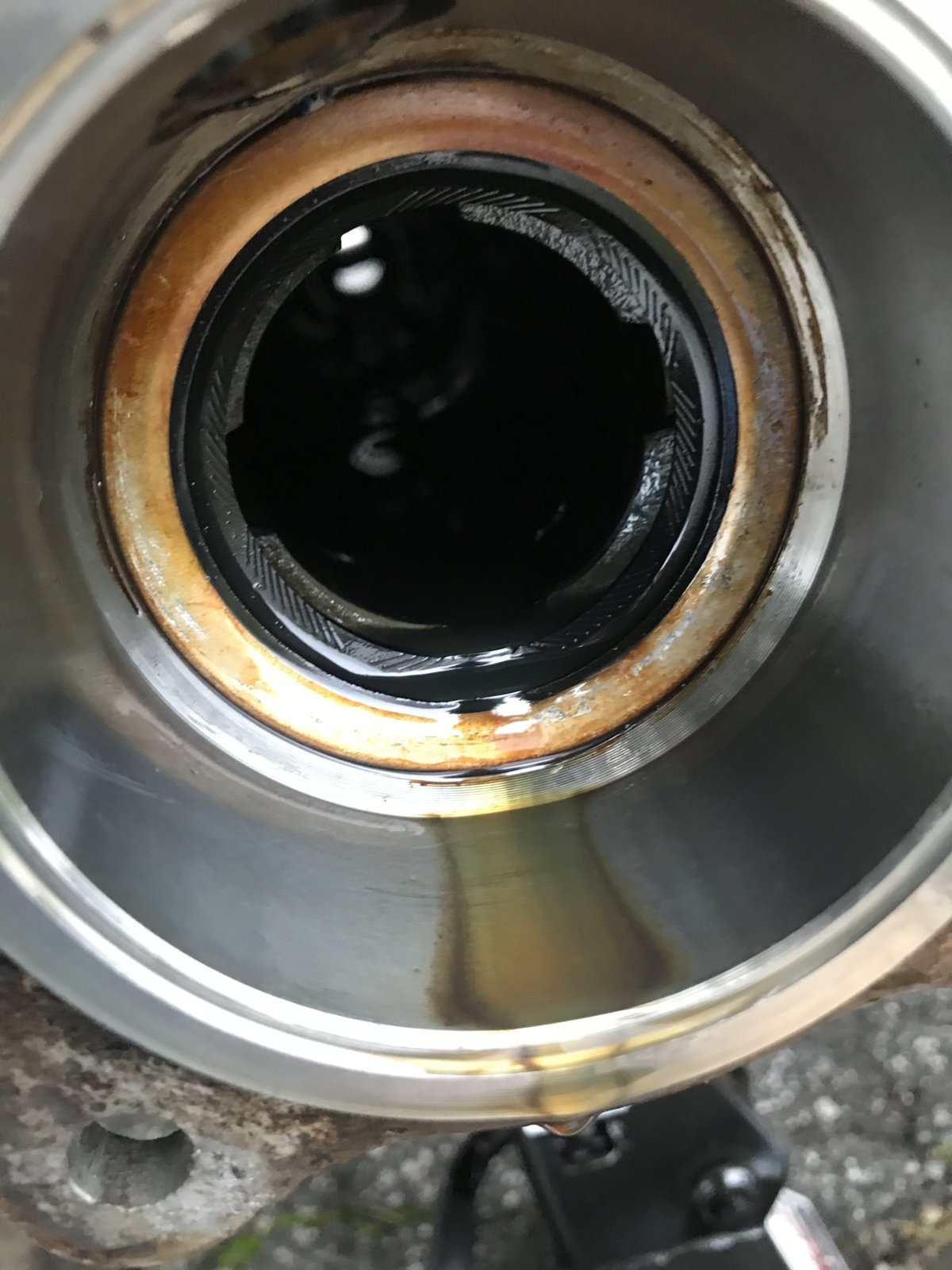

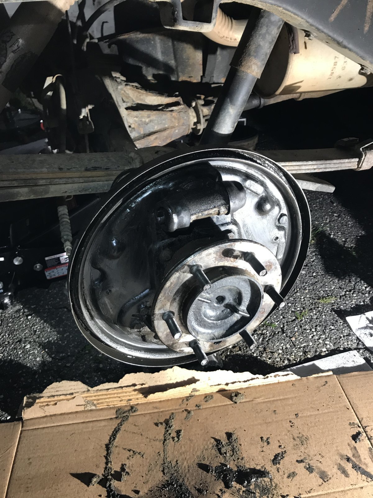

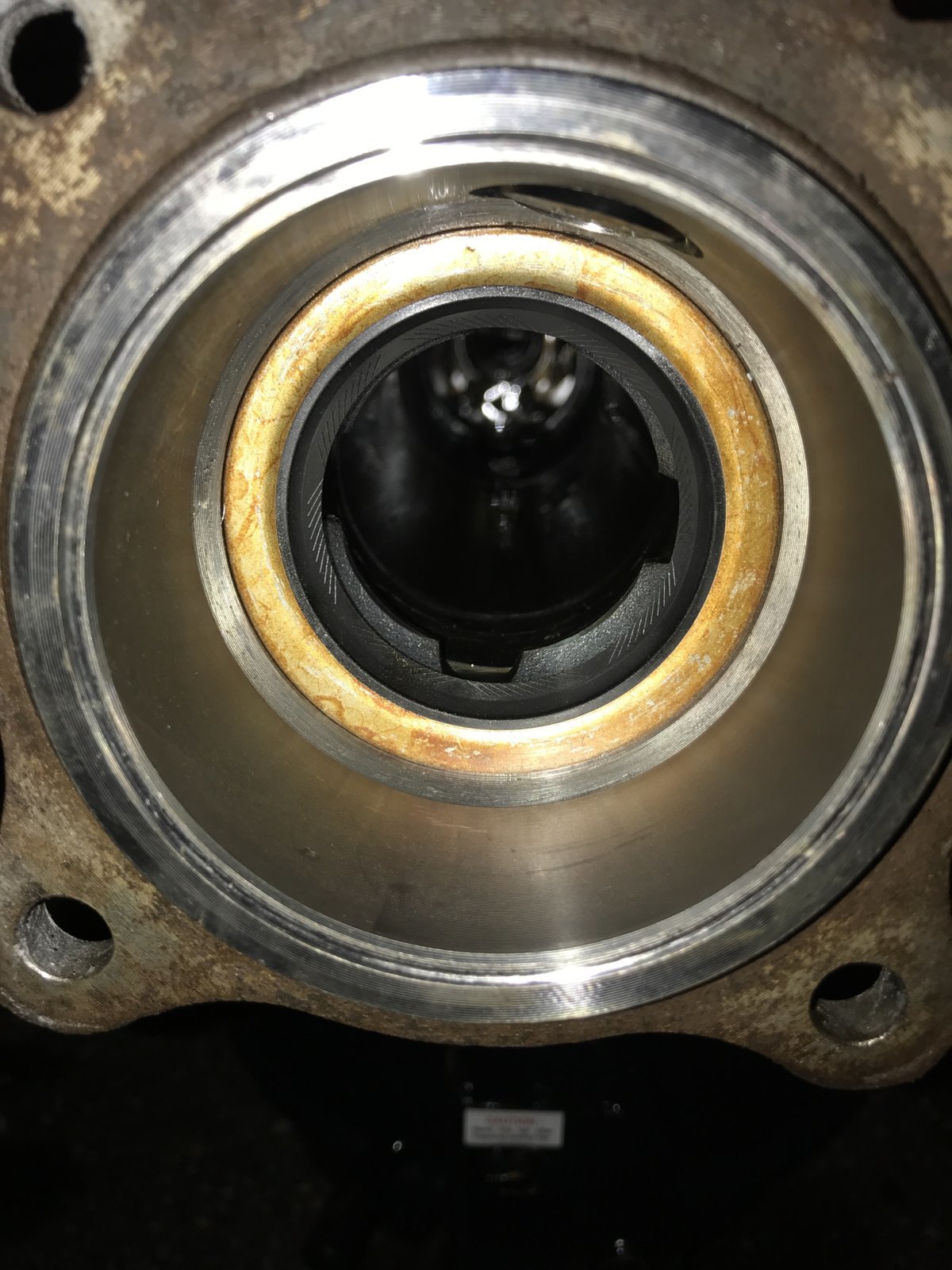

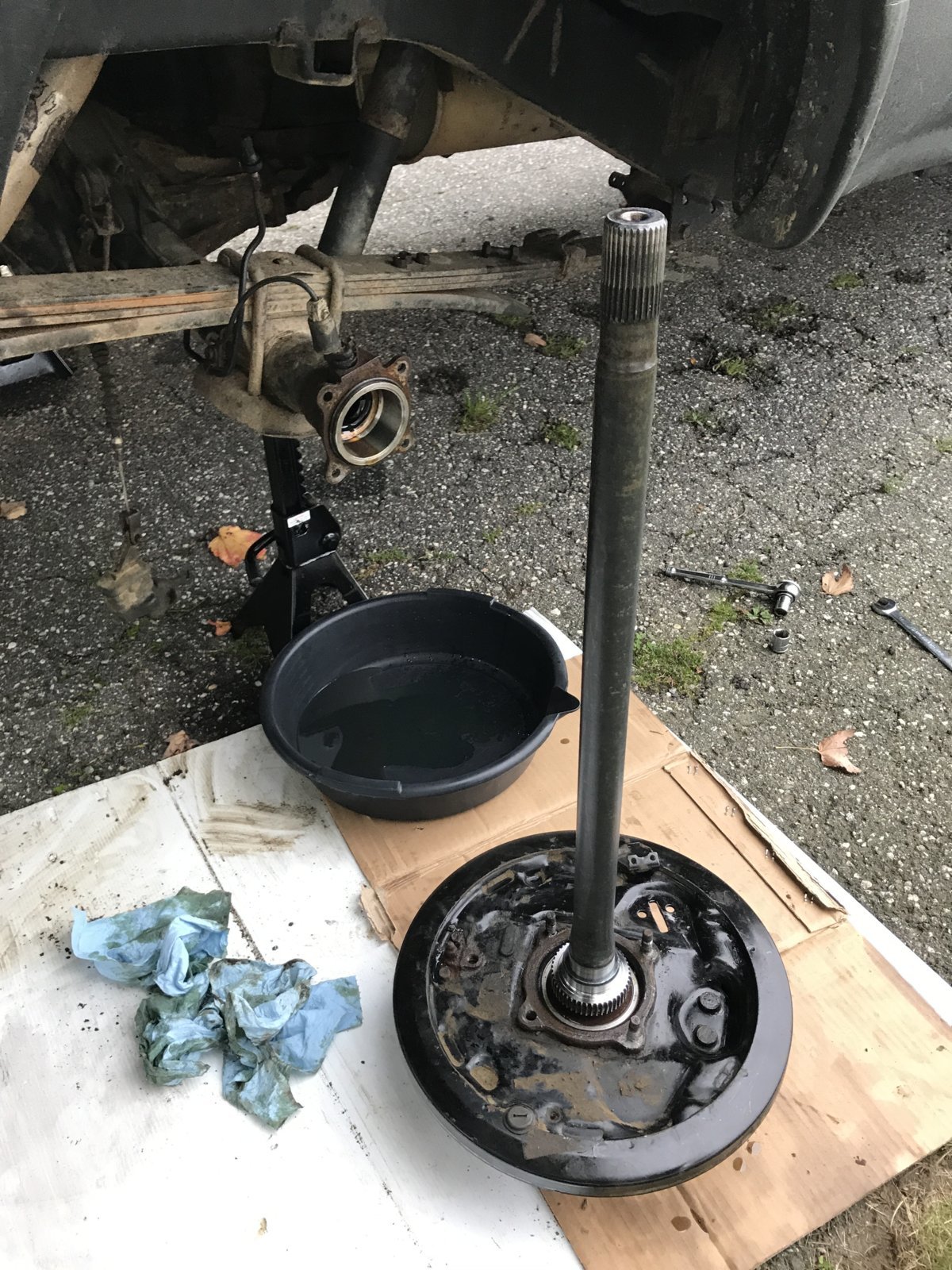

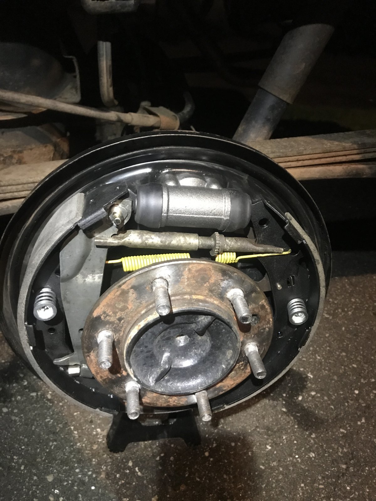

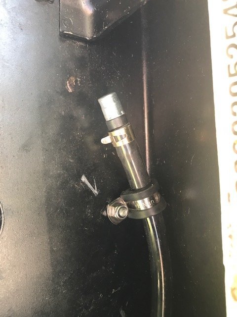

    For those facing this in the future and out of warranty: This is a common issue with Tacoma's and it happened to the drivers side on my 02 years back. I was quoted over $700 back in 2010 from a local shop because they "need to be pressed". This may be true but not necessary to complete this repair.. I ended up bringing it to a buddy and he fixed it in about 30 mins..
    In 2017, I noticed it on both sides of my '03 once I got in home from buying it. I fixed them both in the driveway and it's not that difficult to repair.. You can unbolt the the axle and the whole thing will slide right out. The seal is right there.. pry it out with a screwdriver.. hammer a new one in with a socket and Bob's your uncle.. The only complicated/time consuming part is all the clean up to the drums if it's been leaking a while, brake line snapping when removing so needed to replace and replacing the brakes/bleeding etc..
    Pics for reference:
    IMG_4781.jpg IMG_4894.jpg IMG_4895.jpg IMG_4905.jpg IMG_4904.jpg IMG_4914.jpg
    The cause is likely the breather got clogged with gunk and the pressure build up popped the seals. From time to time to can "flick" it to make sure it's operating correctly. And it's pretty easy to replace all together..
