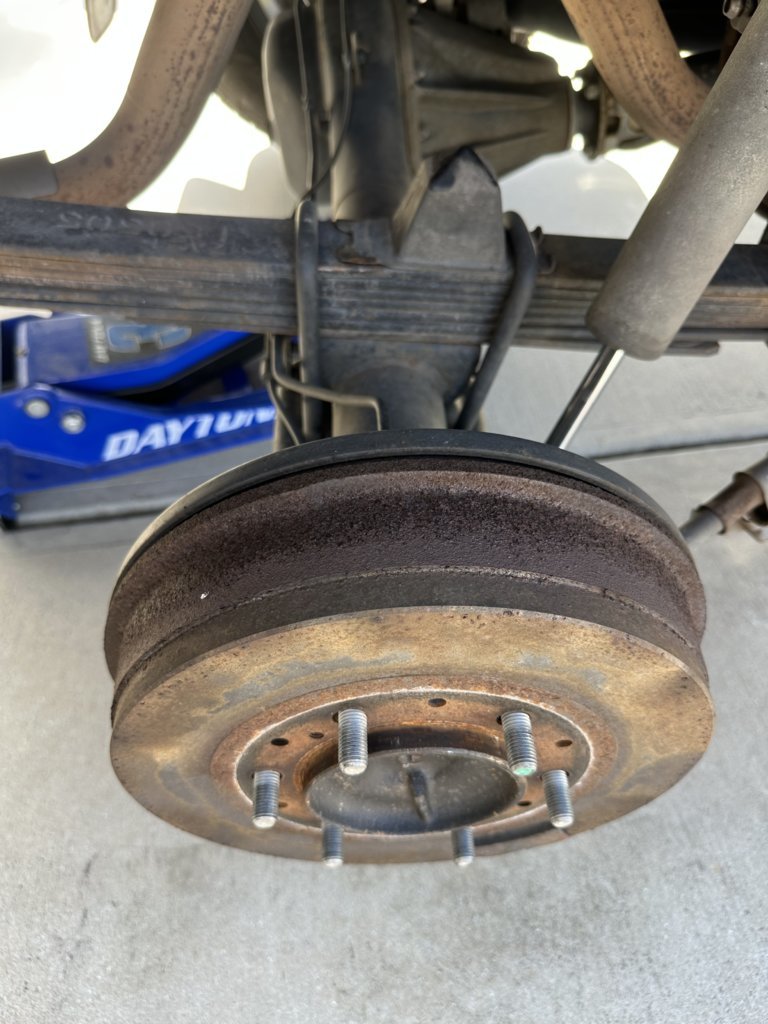

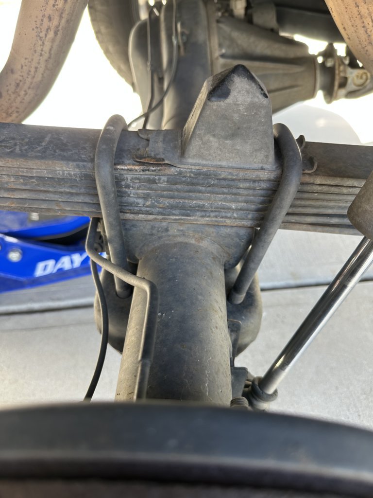

    Another vehicle turned left into the right side of my 2015 Taco a few nights ago, doing some damage to the back of the rear passenger door, cab just behind the door, and bedside. It was a low speed collision so the damage is moderate. The right rear tire was on a slow deflate post-accident. I went out of town the day after and today was my first opportunity to put the spare on and see if the truck is driveable. The body shop won’t be able to take it for a couple weeks. Insurance is all good including a rental, but I’d like to know if towing the boat is a possibility so I don’t lose the opportunity for the next two weeks.
    After taking the wheel with the flat off I found the axle had shifted rearward along the right leaf spring. Presumably the axle pin is sheared. I’m no expert but I see no evidence of frame damage. The left axle/leaf spring is in the correct position.
    Could drivability be as simple as replacement of the bump stop, axle pin, and u-bolts? And of course a repaired or replaced tire.

    We've seen hangers bent and axle tubes bent but this looks like the u bolts took all the energy. I'd say its possible all you need is the ubolt, pin and stops as well.

    Thanks! If that’s the case I could easily do the repair myself. However that might complicate the insurance situation, so will see if the body shop can just do it up front, and let me have the vehicle back until they’re ready for the body work.
    Besides, best for a professional to inspect the entire rear suspension / frame / drivetrain.

    OP, it would seem your diagnosis is spot on. Do please take care of it before towing or much else for that matter. Good luck with the insurance.

    The axle housing and axle shaft should both be checked to make sure they weren’t bent. Likely they are OK, but if not, you want it fixed on their dime instead of dealing with tire wear or vibration issues in the future. I’d push for a new wheel bearing on that corner too, it’s taken enough of an impact to compromise it.

    Towing is a good point. I need to request a flat bed tow so the mangled geometry on the rear isn’t an issue.
    Good ideas, I’ll definitely ask for those to be inspected.

    I am not expert compared to some of you guys and visually it looks like the axle pin broke and the leaf springs shifted....
    ...but OP said that the impact was from a left turn into the right side of the truck. Which would cause a side impact with forces being side/side-left/right.
    But the retention tabs for the rear u-bolt looks to be completely flattened.... like the collison force caused the leaf pack to slide forward... and not side-to-side.

    Haven’t seen the report. The state trooper who came to the scene wrote me a ticket for improper passing. No ticket to the other driver for no signal. He told me that if the other vehicle had come to a full stop I’d have been legal to pass. That didn’t make sense to me at the time, I’ve since asked a recently retired trooper who said that’s not at all how it works. He said he would have written the other driver a ticket for no signal and nothing for me. Luckily the insurance company doesn’t care about the ticket, just the points of impact. Which show that the turn happened after I was established and almost past the other vehicle.
    I had the exact same question, and my theory is that since my vector of travel was forward, perhaps the force vector of the other driver’s front left corner was rearward as an equal and opposite reaction, based on the geometry. I think the rear of the cab/ front of the bedside took most of the right to left impact. Also the center pin is a heck of a lot thinner than the ubolts, so easier for things to go in a front/back direction than sideways.

    You need to have everything checked thoroughly. I had a trailer take a low speed quartering side impact, and it bent the spindle. If the force was sufficient to shear the pin, need to check the geometry of everything.

    TLDR, check your leaf pack center bolt, by the looks of the pictures that shit sheared off due to the force and thats why all is out of place. Cheers :fistbump:

    Insurance has completed the estimate and paid out.
    It includes replacement of the leaf springs on both sides since they come as a pair.
    I’m contemplating doing that work myself and pocketing the labor funds. Is this a silly idea? I installed them originally, no issues.

    If the insurance company pays for the parts/labour and you can do it yourself, I would. As you know, replacing springs isn't that hard or time consuming.
