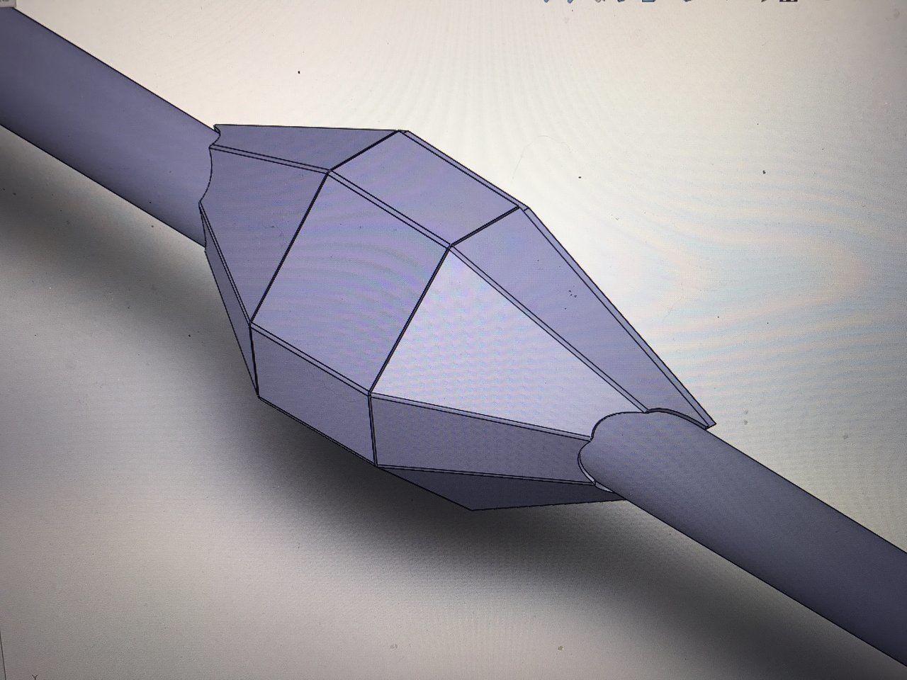

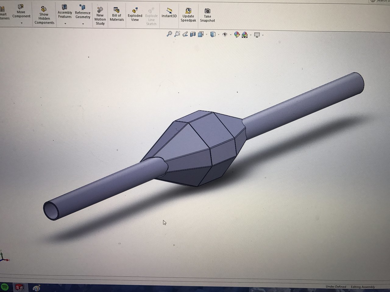

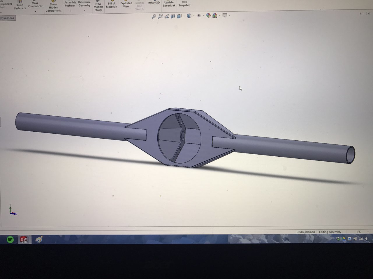

    Had some free time tonight. I have always wanted to make one, maybe now is the time haha. See if I can make a sweet 2nd gen Tacoma axle... Started playing around with Solidworks to get a start on what it would be to make it. Pretty simple design really. A 7 parts from 3/16" plate, one from 3/8" plate and some 3.5" tubes. Maybe add a truss. Material wouldn't be too bad of a price but after welding the face would need servicing and the housing straightend if it tweaked at all during welding. A solid weld fixture and a slow welding process could eliminate most of the movement. Not sure this will ever get made but a fun thought experiment. Maybe give it a test run if I find some spare time.

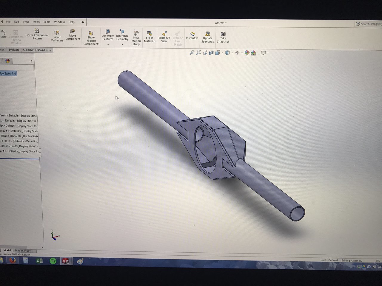

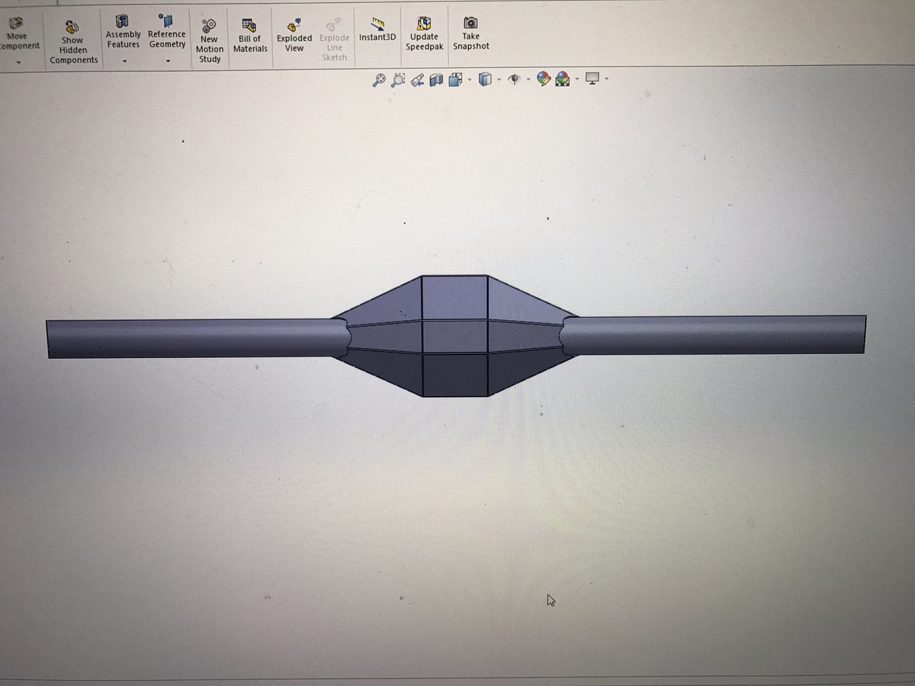

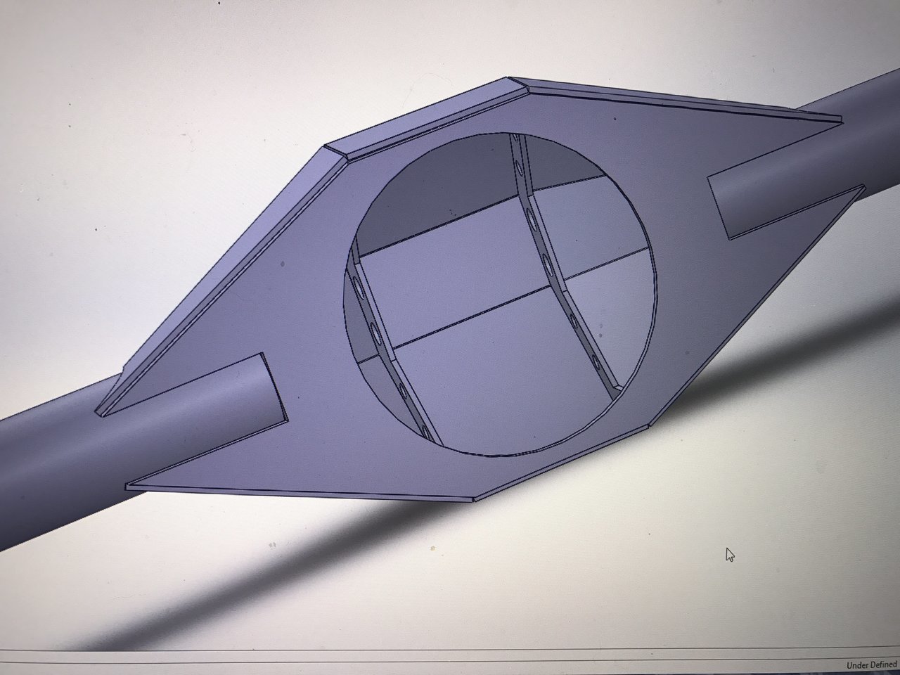

    Few more
