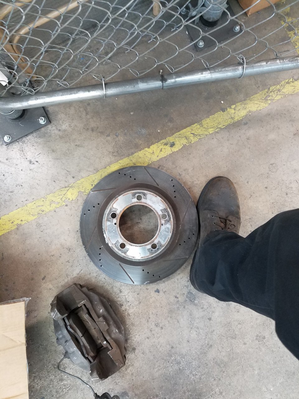

    Yes, i an running the 4th gen 4runner caliper, 5th gen rotors and ebrake mechanism hooked up to the stock ebrake cable.
    The 9 inch is good but expensive to set up. It has more gearing options and even race application lockers. You can also just get a housing and shafts for a full float landy to center it. Lots of options
    Looked at it and it hung way too low on the diff. The whole reason for changing the axle housing was to gain the brakes and more clearance. The diamond axle i mentioned uses the factory sensors and factory Toyota calipers.
