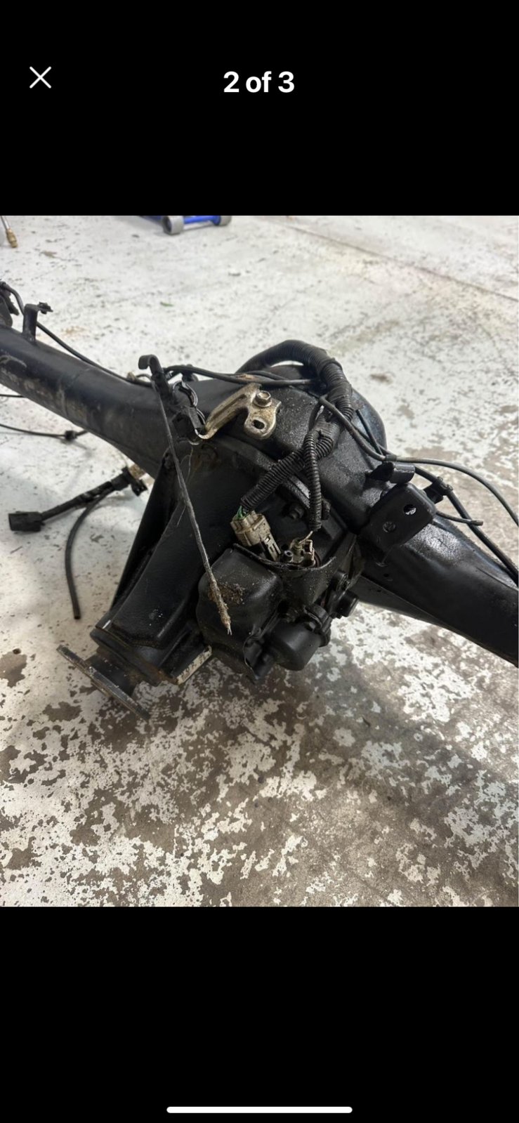

    I’ve found a rear axle off of a TRD off road, I think!, that I would like to put on my 2015 SR5, has anyone else done this and how complicated was the wiring and the switch’s to get it to work correctly! This is going to be new to me, Id appreciate some knowledge from someone that done it. Thanks!!!

    Does a “Sport” come with a factory locker?

    I think they do that’s why I’m wanting to add it to my SR5, they don’t have it, mine is just 4x4 with no locker.

    No sports with locker, correct me if I’m wrong they all were LSD or open.

    I’d don’t know I’m not sure I just know the axle has it, or I think it does.

    Sport does NOT have a Locker.
    Off-Road does.
    The Off-Road uses an 8" gear and is OPEN differential.
    The Sport used an 8.4" with Mechanical LSD up to 2008. And Open in 2009+ trucks.
    The axle pictured is from a TRD Off-Road. It should have a 3.73 gear ratio if it came from a 2nd Gen Tacoma.

    Thank you! I’ll change it, I was told wrong on what it came from then it is 3.73 gear ratio.
