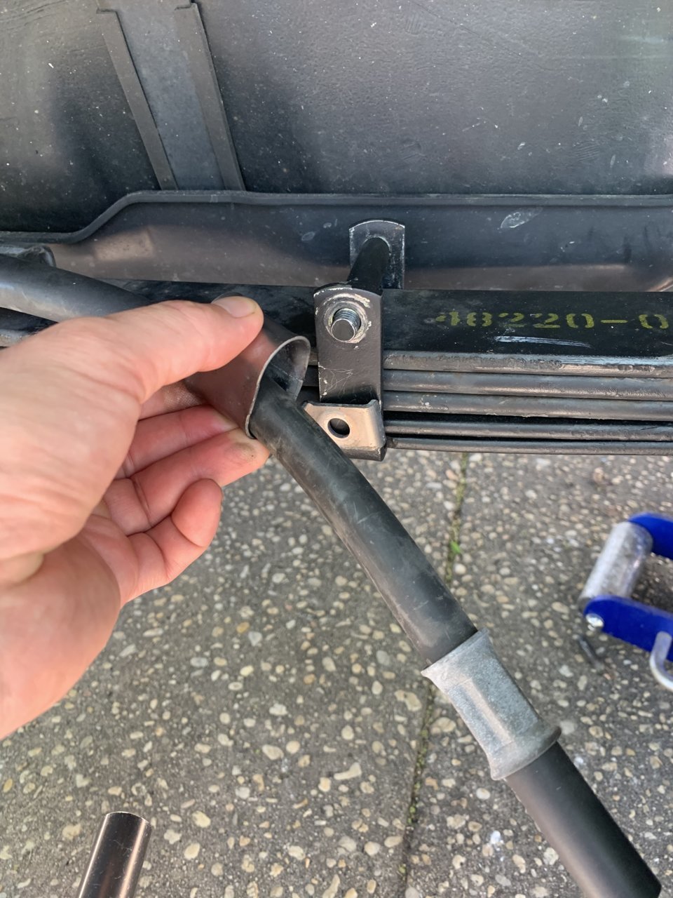

    1D6A7F82-8FA5-4740-8CE3-01AE662AB381.jpg I’m curios, what do you guys do with the ebrake clip? It no longer fits onto the overload bolt. Cut it off?

    Bump. Going to take my rears 400 miles south of the border and have the local guy do the install. Any tips especially the ebrake clip?
