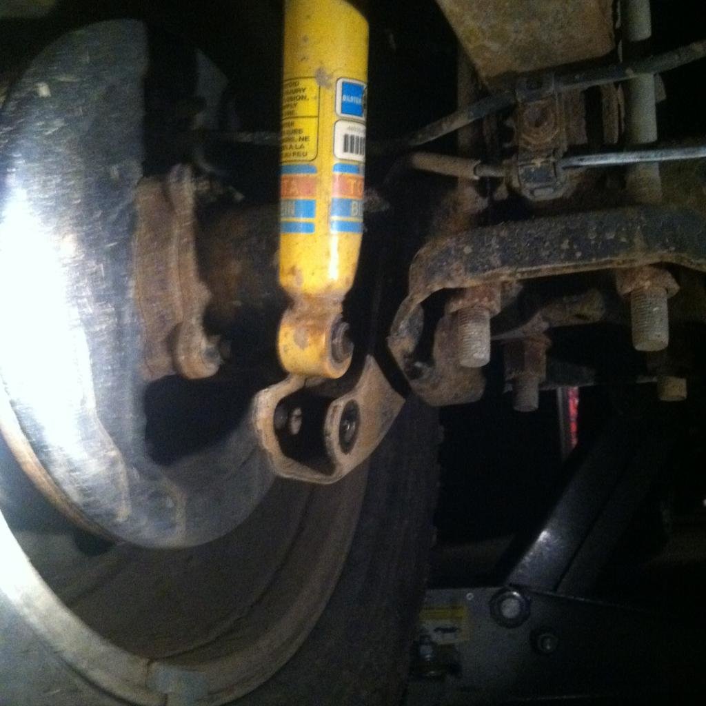

    Also, here is another bit of interesting information....
    This is what a stock shock (same length as a 5100) looks like a full extension vs a 1.5" add a leaf at full extention -
    4E19052D-35BE-4A13-A185-4B2FCEE464BA_zps_bea910d1ddbcff5b00dfc62d35989ff409c4aa6a.jpg
    You're losing 2" of flex with the stock shocks.
