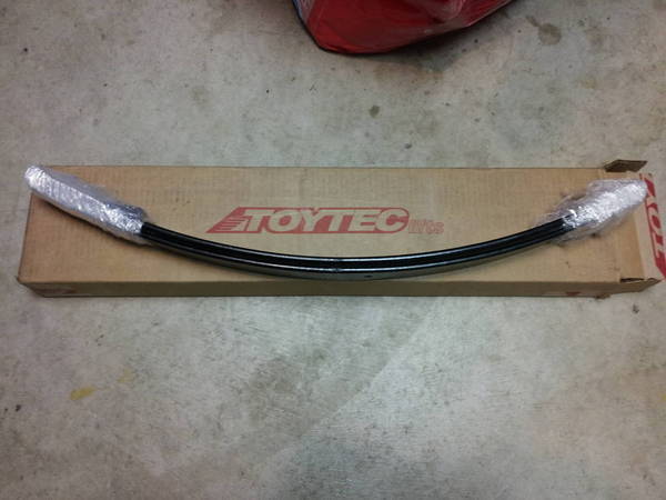

    lucky
    lucky Well-Known Member
    Jun 21, 2008
    #7468
    340
    NB, TX
    07 PreRunner
    TRD 2 CAI Firestone Ride-Rite TSB Leafs Toytec AAL 5100's and OME Blue LED dash
    I just bought the 1.5 AAL for TSB leafs from Toytech, and the Bil 5100's front and rear from Downsouth. Downsouth reports the extended length rear shock must be used, and an extended bump stop must be added to prevent the shock from bottoming. They accidentally shipped the standard 5100, so they are also sending me the extended 5100. I'll have both, new in box, in a couple days. I'll take some pics and measure showing the differences and post to this thread. Great customer service at DownSouth, by the way....
    Also, it is recommended to at least customize the rear brake line mount if you do not install extended brake lines....
    My AAL has arrived but the 5100's are not here until the 9th. I'll be doing the install on the 14th. Thinking about using these bump stops..
    http://www.ebay.com/itm/Energy-Susp...her_Vehicle_Parts&vxp=mtr&hash=item48425a2e19
    Anyone else do a similar setup?
  12. Jan 6, 2012 at 7:42 AM
    lucky
    Jun 21, 2008
    #7468
    340
    NB, TX
    07 PreRunner
    I'm sure everyone has seen these already.... here they are..
