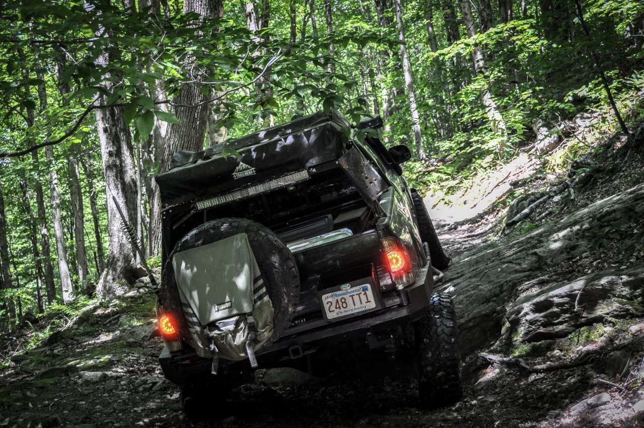

    Dakar heavies, b110, superbumps and rago shackle hangers here. Trim your leaf packs correctly and its smooth sailing. This is on 35's.
    dirtnsmores likes this.
