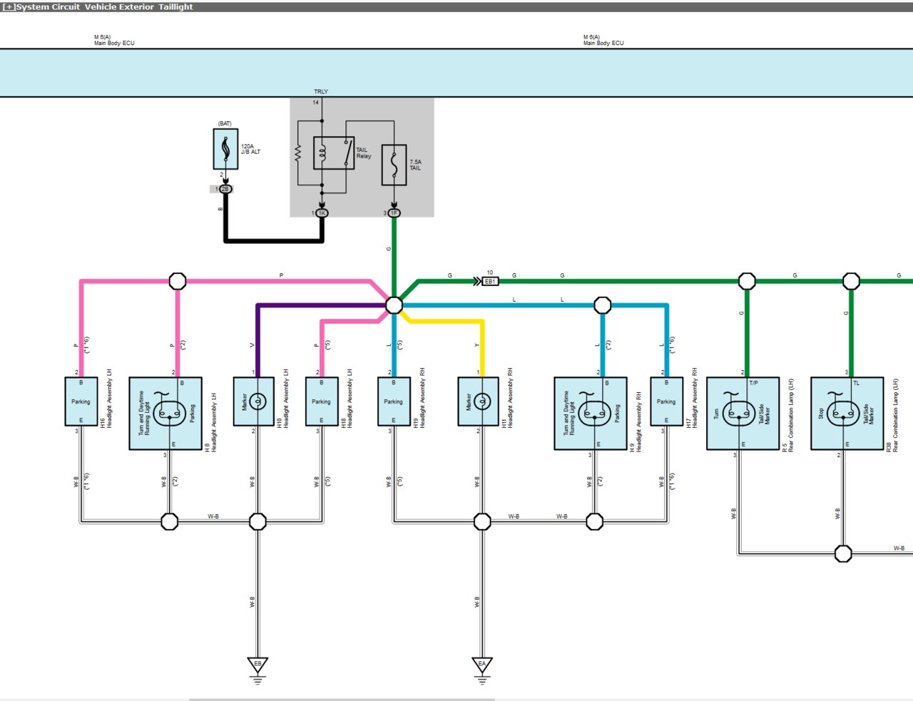

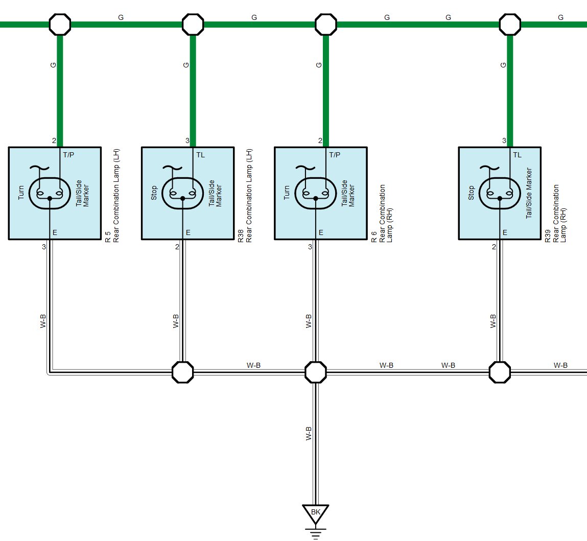

    Post up a location to see if TW member is close by who can assist.
    You want to make sure you have a stock harness and bulbs in there before you take it to a dealer. If they find funky eBay LEDs you can be hit with "none Toyota parts, $150 diagnostic fee". Lots of eBay crap, so they need to spend time to diagnose and return to stock. The common ground point, so if everything else is good it's a bad socket. Just odd.
    There is a tail light relay that powers up the green wire. White/Black provides ground.
    This sounds like the Combination Socket has a connection issue.

    This sounds like the directional bulb is searching for a ground. As ktbell444 suggested, us a multi meter to check that the black/white wires in the sockets on that side have good grounds.
    All sorts of weird things happen when a circuit loses a ground.
    Also make sure that the bulbs are the correct type. If you've already done that, a lost ground is the most likely suspect.
