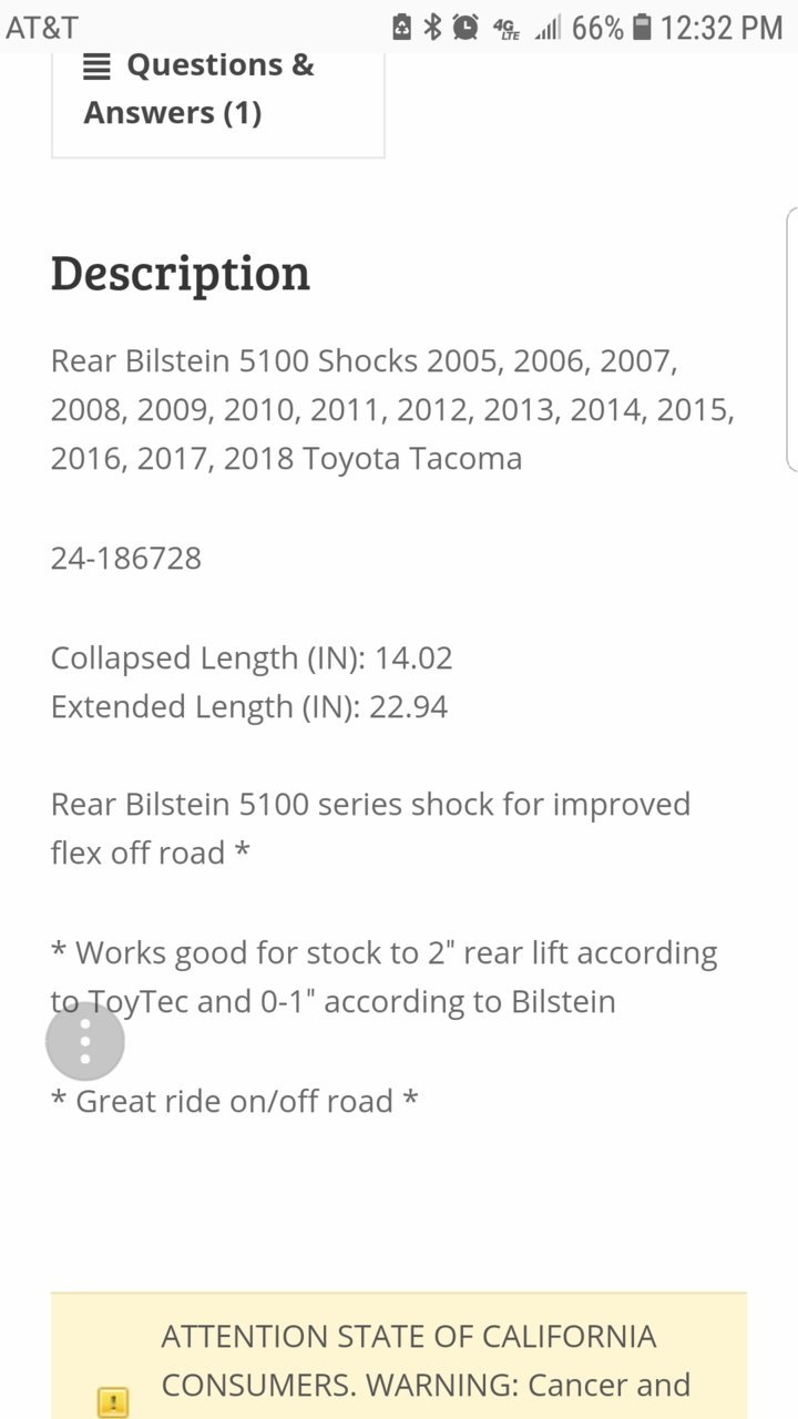

    One of the people on the site measured them. Here is the info. Do some googling and you can compare to other shock lengths from the aftermarket.
    "Thanks! So I noticed the list had the rear stroke and collapsed length mixed up. Basically, these are similar length as base Taco suspension.
    I also converted to inches:
    Extended Length
    Front: 555mm (21.85")
    Rear: 595mm (23.43")
    Collapsed Length
    Front: 443mm (17.44")
    Rear: 357mm (14.06")
    Stroke
    Front: 112mm (4.41")
    Rear: 238mm (9.37")"
  11. Oct 20, 2018 at 10:36 AM
    Sch0227
    Sch0227 Well-Known Member
    Sep 6, 2017
    #229254
    446
    Steven
    Dallas, TX
    2017 TRD Parts bin
    Sharks with lasers
    They're longer than these so you should he good.
