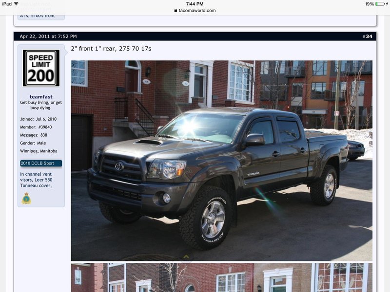

    Probably have to take off the front flaps and do some trimming....Really depends how much lift you have up front right now....Take a picture of the top of the coil for us.
    Or measure the spacer if you see one on there

    Wish I could post a pic of the one I was looking at

    You have email I can send pic to chad? Not of mine but the pic I got off here
    ChadsPride likes this.

    Thompsoncentre
    Thompsoncentre [OP] Active Member

  8. Dec 14, 2016 at 2:35 PM
    #28
    Thompsoncentre
    Mar 6, 2015
    #150272
    30
    There we go!

  9. Dec 14, 2016 at 2:36 PM
    #29
    Thompsoncentre
    Mar 6, 2015
    #150272
    30
    I want that set up!

    Id just get a 2" strut spacer (not coil spacer) and a 1" shackle or block in the back if it is a daily driver a block and strut spacer wont change ride quality much at all if any. Daystar makes some nice kits that do just that for 125ish bucks.
