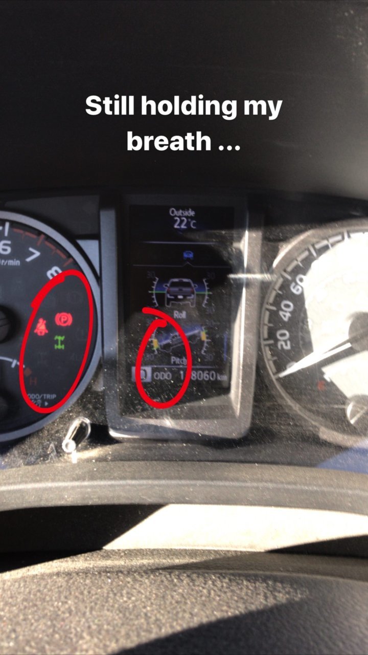

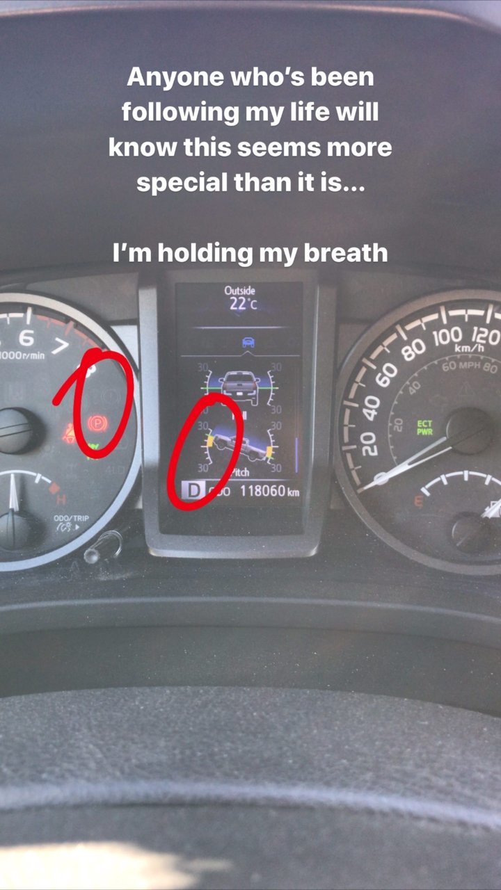

    3E3E3627-2D77-4D0F-B3D6-CC9C44327DA6.jpg Update
    Today I loosened the console adjustment screw all the way off, and removed the wheels to tighten the star wheel on the disc/drum. Before I worked on the back wheel I lifted the handbrake 2 clicks (youtube video suggests doing that), then I got one side snug by adjusting the star wheel and In doing so the other side was snug too, then snuggled up the console but until the truck held in drive mode (2wd) 5 clicks.
    went for a test drive and there was drag so I loosened the console adjustment screw 1 1/2 turns. It held on 7 clicks in 2wd. Tried it on a aggressive slope up and it held on 9 clicks, and again on a decline and it held on 10 clicks (4wd in gear going forward).
    when I got home it felt like it was dragging a little bit so I loosened it 1/4 turn in the console. ... wait and see, still trying to source a new brake cable but today’s test makes me feel a little better. F8E85D30-DAF4-423F-9013-434E53469424.jpg
