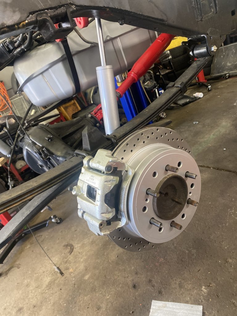

    I have a 2003 Tacoma with the SOS ebrake option and for me is by far the best investment I ever made on my truck, there is some adjustments and tweaking to do the ebrake adjustments, but well worth it in my opinion. I only purchased the kit without the pads, or rotors or calipers, I wanted my own OEM parts from Toyota. The parts in the pictures are actually from rockauto or ebay, I then replaced them with OEM TOYOTA FJ Cruiser Calipers, Pads, and also the ebrake OEM shoes inside of the rotors, in my opinion the aftermarket CANADIAN Crossed Drilled Rotors stopped better than stock OEM TOYOTA FJ Cruiser rotors. If you need anymore infor on my conversion just let me know.
