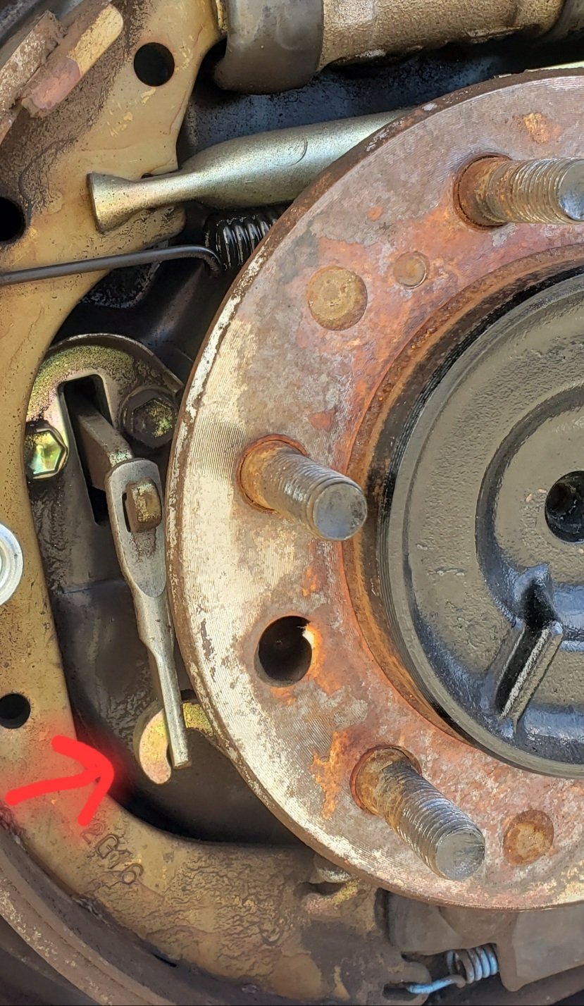

    The only time I had noticeable brake drag from a rear drum it turned out to be from a lever that connects to the bell crank. I don't know what it's actually called but the end of it can be seen in the photo. The part of it that can't be seen is on a pivot and was seized on mine causing brake drag.

    Do you mean that the part would move but would not return when you released the e-brake handle?

    Yes, if I remember correctly that is what was happening. Not sure how much if any movement it actually had. It took quite a bit of effort to get it freed up and off to clean it up.
