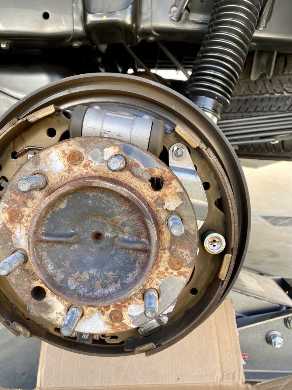

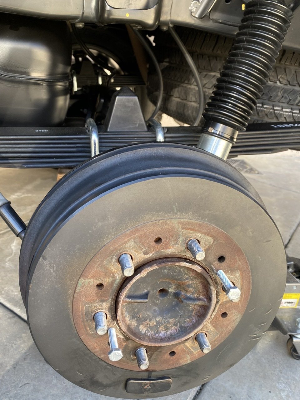

    I’m having a hard time removing the drums, any tips? I already did W-40, some persuasion with a heavy hammer, nothing. I don’t go wheeling with the truck, they shouldn’t be stuck.

    The drums have two 8mm x 1.25 threaded holes. Wire brush and scrape the hub/drum joining surface well. Penetrating oil well. Thread bolts into holes on drum while tapping and turning the drum untill it loosens from hub and clears shoe contact. You may have to back off brake adjustment from rear of backing plate.

    Not sure anyone has brought this up yet, but just to be sure - the emergency brake isn't on, right? If it is, you've got the shoes pressing against the drums and holding them on there.
    Assuming the eBrake is off, check out my post about changing your rear brake shoes:
    Step by Step Tacoma Rear Drum Brake Shoe Replacement
    Look for the section "Removing the wheel and brake drum" - essentially, you can use two M8-1.25x50mm bolts threaded through the drum to press it off. Make sure however that you've already backed off the adjuster - you don't want to be pressing against the force of the shoes; just of rust, etc.

    130k miles on them and they are fine. Vacuum and a brush to clean the dust and that’s it. Those marks on the drum are probably from the stupid dealer :mad: when I used to take it there for services. I used a wood block now.
