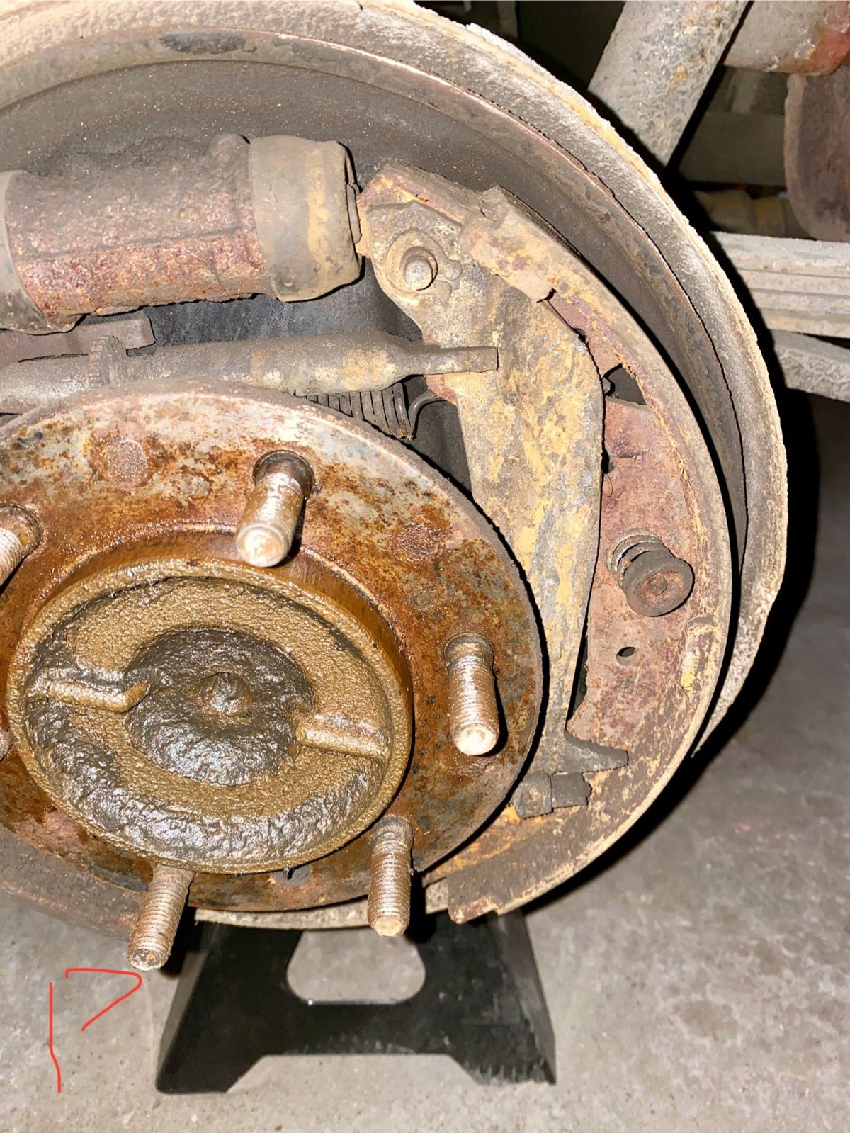

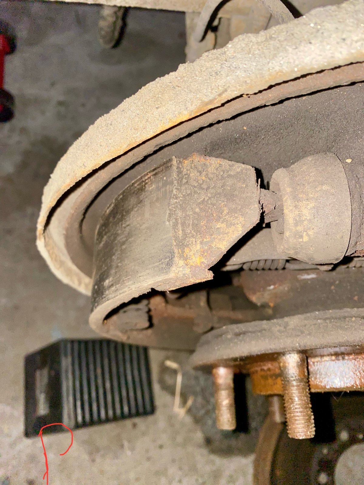

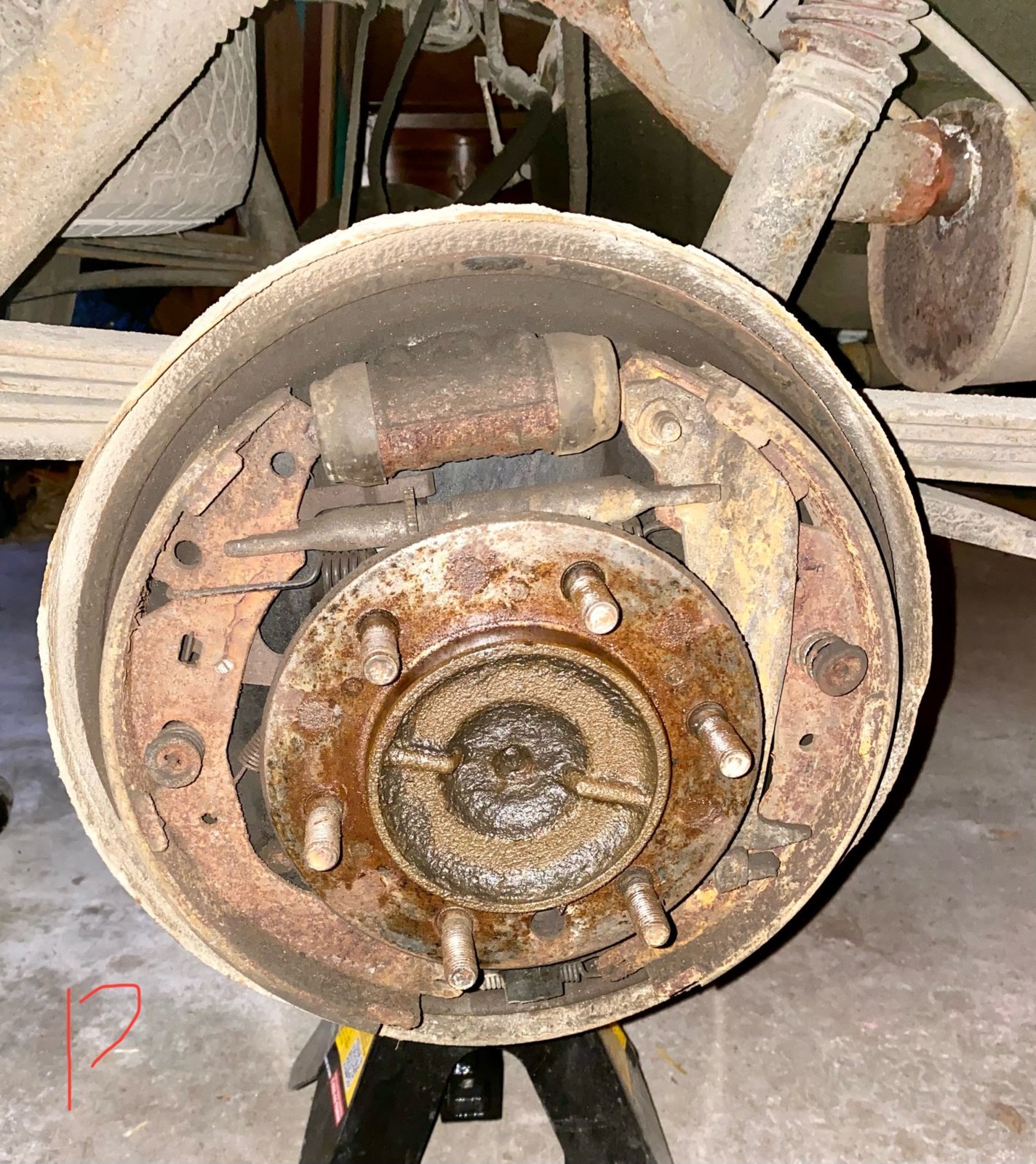

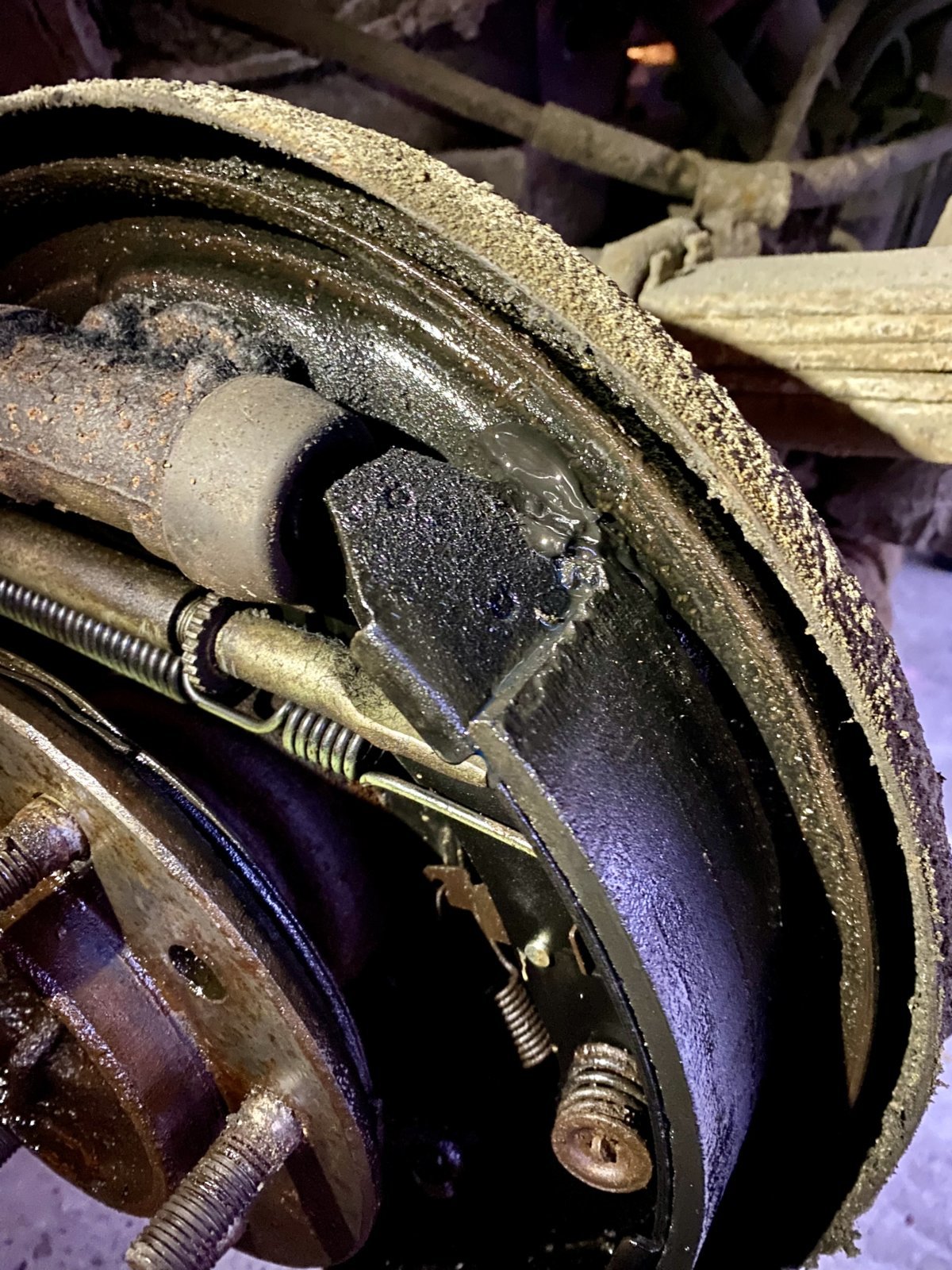

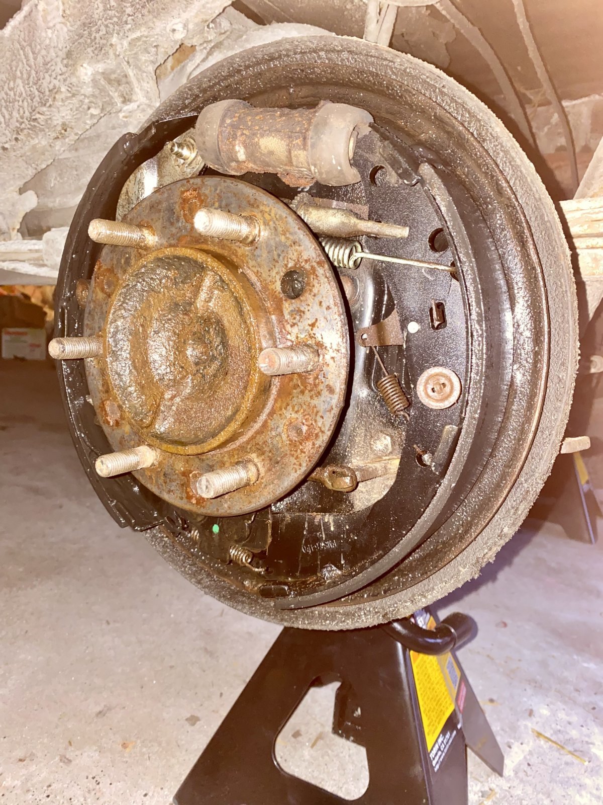

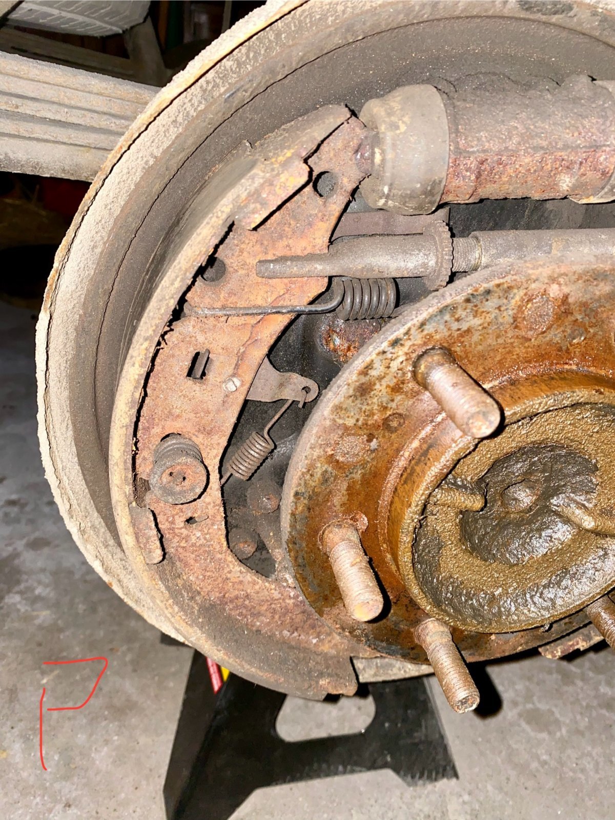

    Here are the photos. The first 3 are from the drivers side. It seemed to have more moisture in there than i expected, but I’m no expert. This is the side that had the tension from the stuck/frozen parking brake cord.
    The second group of photos are from the passengers rear side. I marked them with a red P on the left corner. When I opened it, to my very beginner eyes, I instantly thought this was the problem. Pads look all jacked up and worn irregular.
    took the photos before I cleaned them, will clean them and provide more photos if necessary.

    hard to tell in those pictures, but you have a wheel cylinder or axle seal leaking.
    Looks like differential fluid to me the way it built up.
    Anyways, you need new shoes and hardware too.

    Agreed that it looks like you may be losing diff fluid out of the driver side axle seal, and you appear to need new brake hardware and shoes.
    I'm guessing your original issue was actually a sign your wheel bearing is on its way out (seems rear wheel bearing failures can make themselves known through a number of different symptoms).
    Alternatively, perhaps your hardware is bad enough that one of the shoes was intermittently sticking. I'd pull on the bell crank and watch to see if the shoes seem to both actuate outwards symmetrically.

    Passenger side needs new shoes and hardware for sure. I'd inspect the drums on both sides as well, might have something to do with the issue.
    Driver side appears to have an axle seal leak. Not sure how oil/grease could get in there otherwise. Clean everything up on the driver's side with a degreaser. You might have to keep an eye on this as you work to resolve your brake issue. Could be your problem? Not sure.

    Yeah, that one side is all slicked up with gear oil looks like, it ain't gonna work, could be why the other side is so worn also because it was carrying the load. If you're a newby, make sure a take some pics before disassembly so you remember how it goes back together. One shoe is longer always if you haven't noticed.

    100% need a rear axle seal. Might as well do it right and replace the axle bearing, retainers, seals etc. It's labor intensive so get ready for a steep bill for that.
    Start fresh and get new brake shoes. Also new drums or have yours turned.
