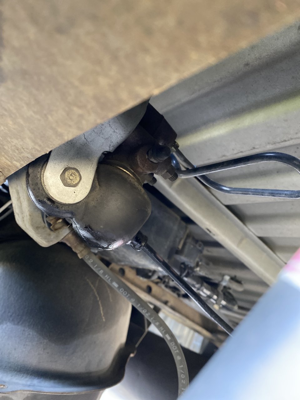

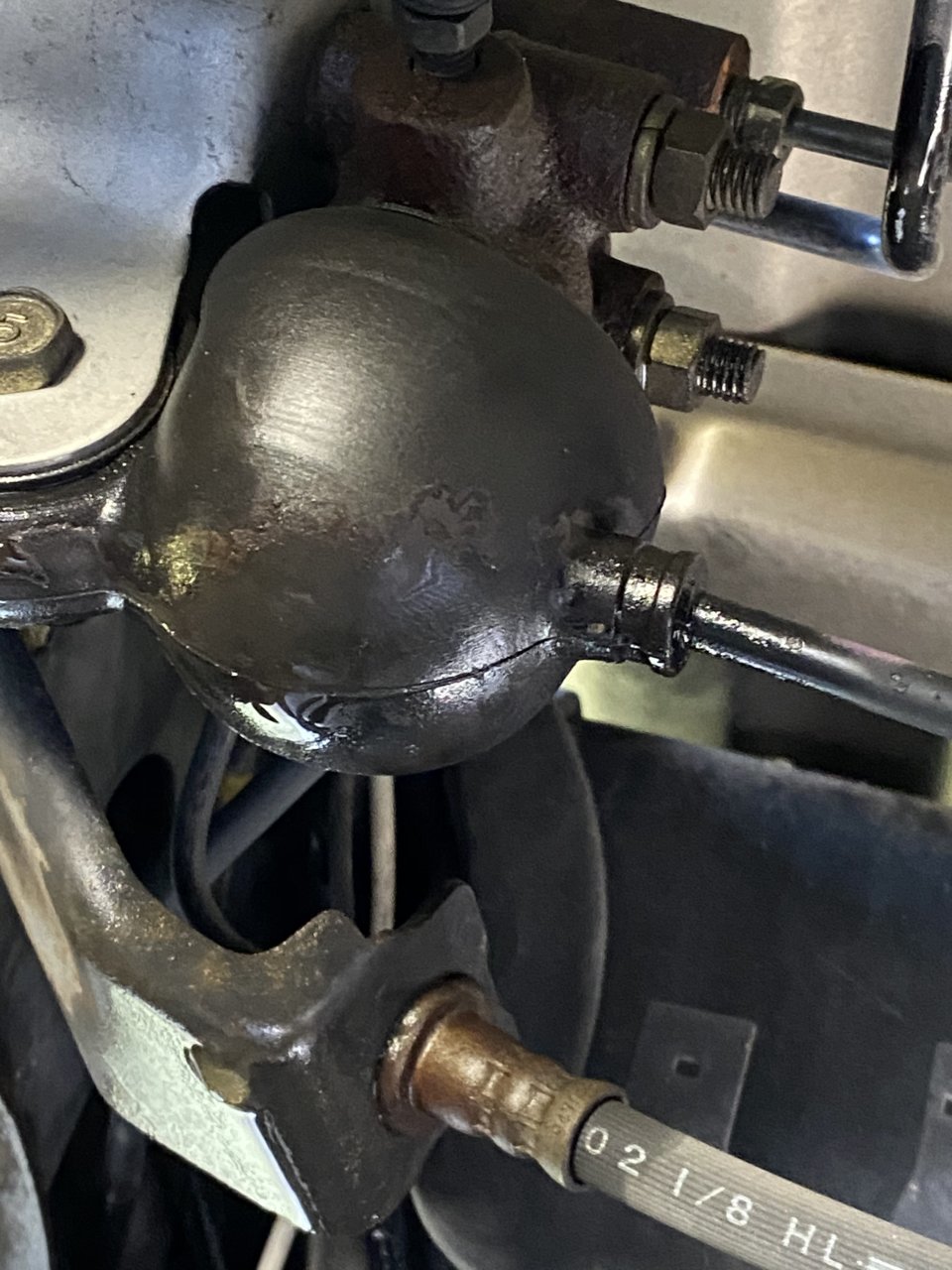

    The load added to rear has caused the load sensing brake proportioning Valve to fully open. Pull the rubber boot and check for brake fluid inside. Shouldn't be any. Does your Tacoma have a lift kit installed? Take a pic of the rear differential and post it. @Tacomajeff02

    How would I pull it off?

    Are the pix from a 2002 Tacoma ?

    Did you brake while the front was lifted?

    Might be the brake fluid has been seeping for years got the front high enough it poured out.
    If the LSPV had failed brake pedal to the floor brake reservoir would be empty or very low

    brake reservoir lost some fluid but i have refilled it.

    do i just pull out the rubber boot and the air should come out or?

    air or fluid?
