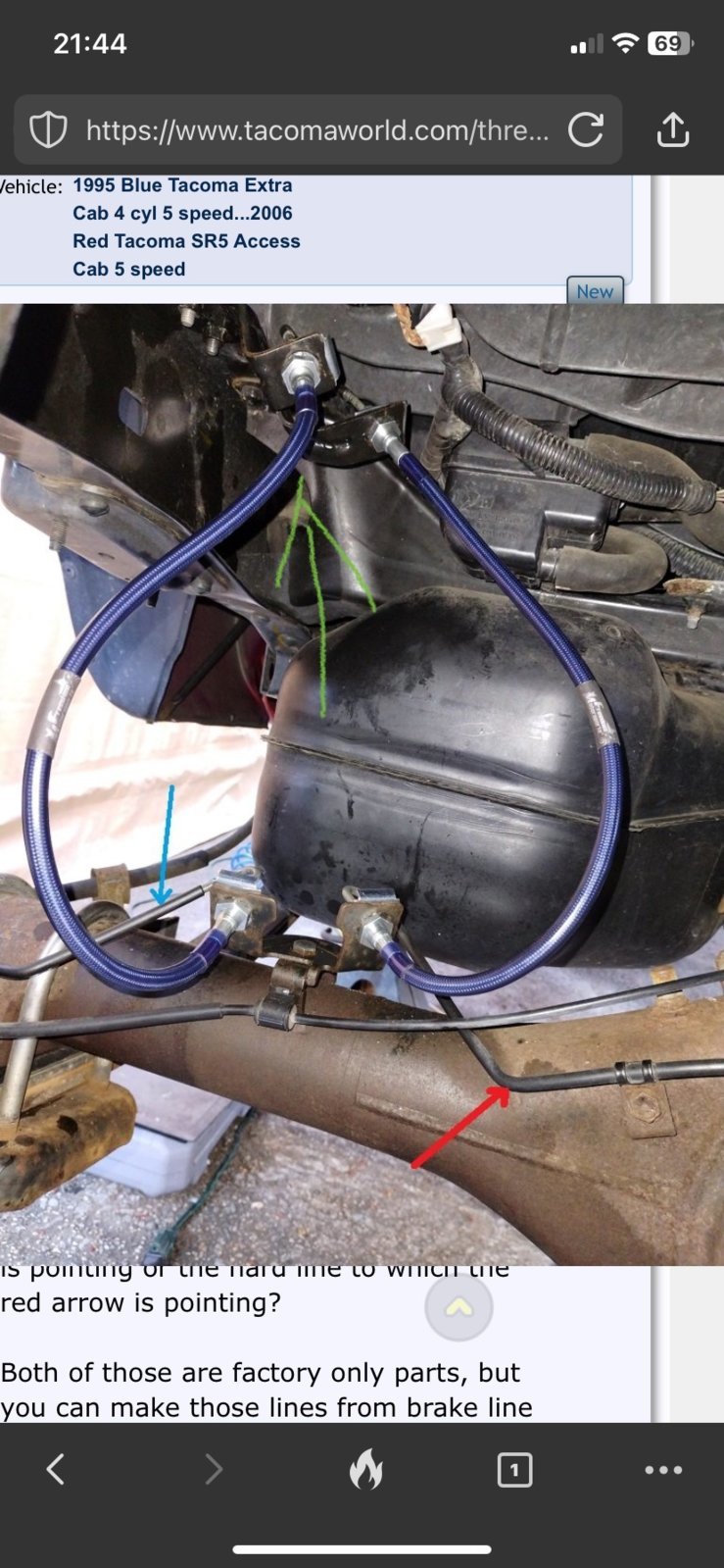

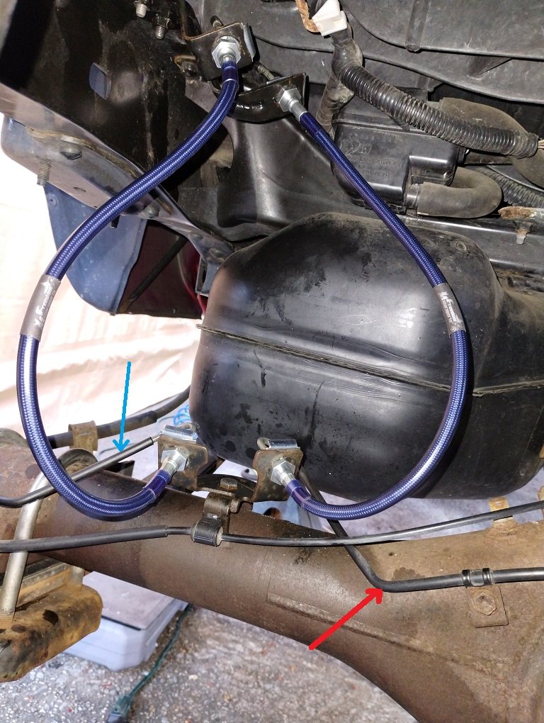

    Is it the hard line to which the blue arrow is pointing or the hard line to which the red arrow is pointing?
    Both of those are factory only parts, but you can make those lines from brake line tubing and fittings as those particular lines are easily accessible and easily routed (as opposed to some of the brake lines on the front firewall). The only bend that will be a little more difficult is the bend immediately coming off the junction with the bracket, in each case.

    Green arrow I cannot get off. Should I just make my own?

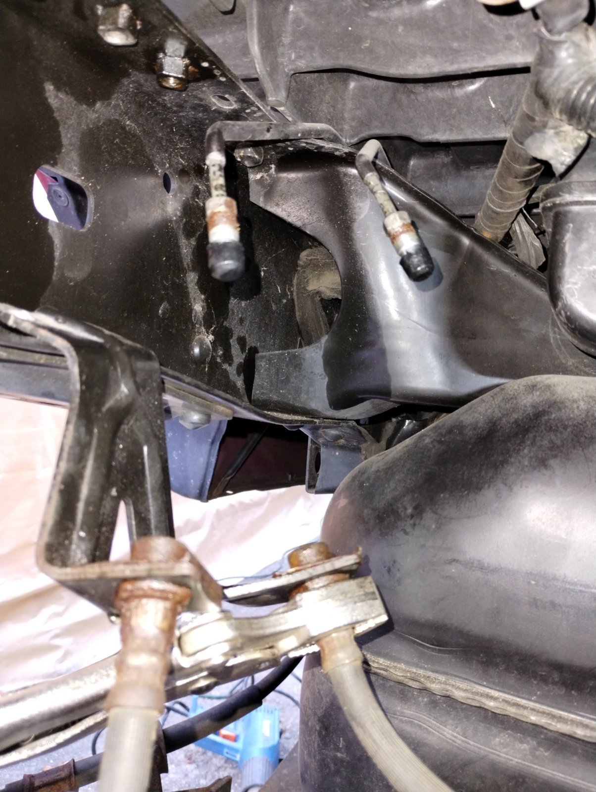

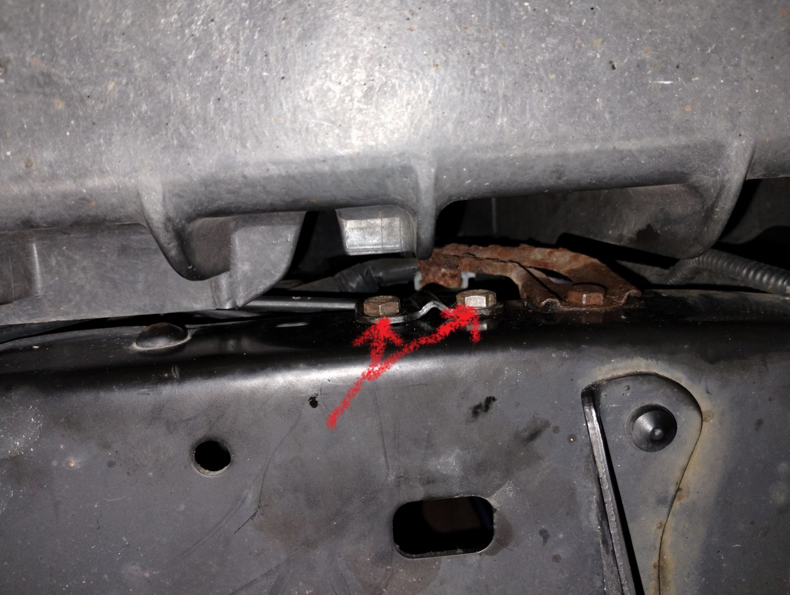

    Are you aware that you can get that bracket unfastened from the frame?
    To remove the bracket, you have to loosen two bolts which are located on top of the frame and can be accessed from the wheel well of the left rear wheel. It's the two bolts on the left in the photo, immediately to the left of the one rusted, separate bracket and bolt. You can get those off with a very short (shallow) 13mm socket or with a 13mm box end wrench.
    Here is the view from the inside, showing the two threaded holes (top left corner of the photo) after the two bolts have been removed, with the bracket dangling below and only connected to the old flexible rubber brake lines.
