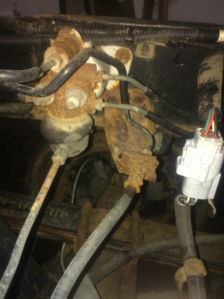

    Where can I get this bracket (the extremely rusted one)IMG_3676.jpg ? And can someone direct me to a link on how to bleed brake lines?

    I think the P/N is 4735535080: http://parts.villagetoyota.com/prod...T--FLEXIBLE-HOSE--NO5/2090222/4735535080.html
    You'll also want new bolts P/N 91641H0820 and new clip P/N 9046808035. (The latter can also be readily substituted with generic Dorman part.)
    Given the low cost of the parts relative to shipping, I recommend buying from your local dealer's parts counter and have them pick it out from their electronic catalog. This way you are covered in case it's the wrong bracket.

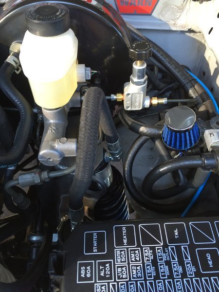

    It's cheaper to purchase a new Wilwood unit that will install next to the MC. Get rid of that useless OEM LSPV. A very easy install too.
    Look at Youtube videos to assist you with bleeding the brakes.
