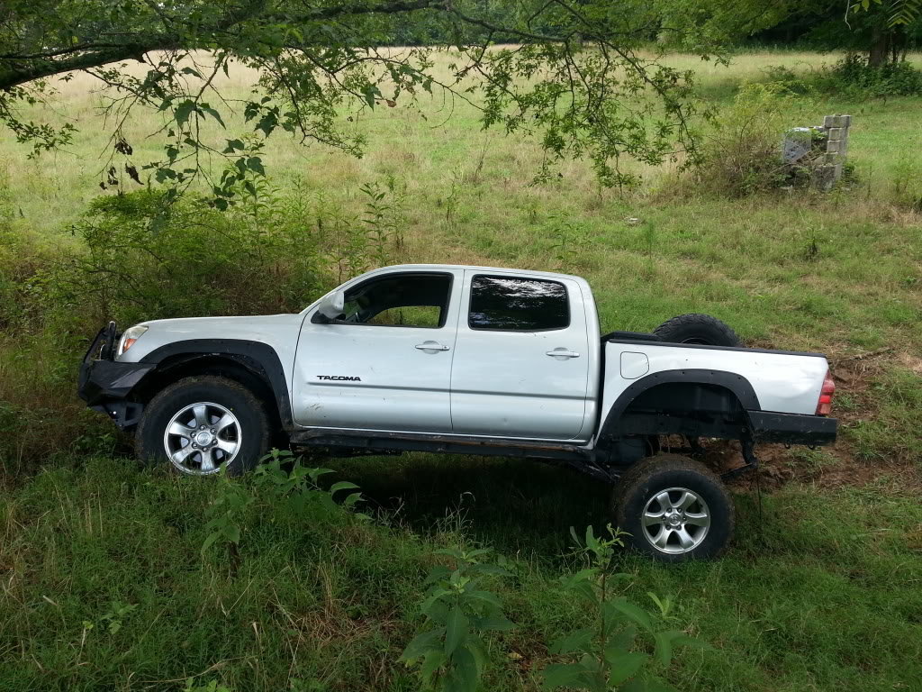

    [​IMG]. On OEM lines. If you adjust the mount you will gain all you need. Or you can spend $$$ on new lines

    I thought the brake flex lines were attached to hard lines. How do you adjust the mount without bending the hardlines?

    Holy droop. Are those invisible shocks? I am also curios to see how you did this with the stock lines

    Wow, I will be studying your build thread closely. I would love to have that much movement in the rear.
