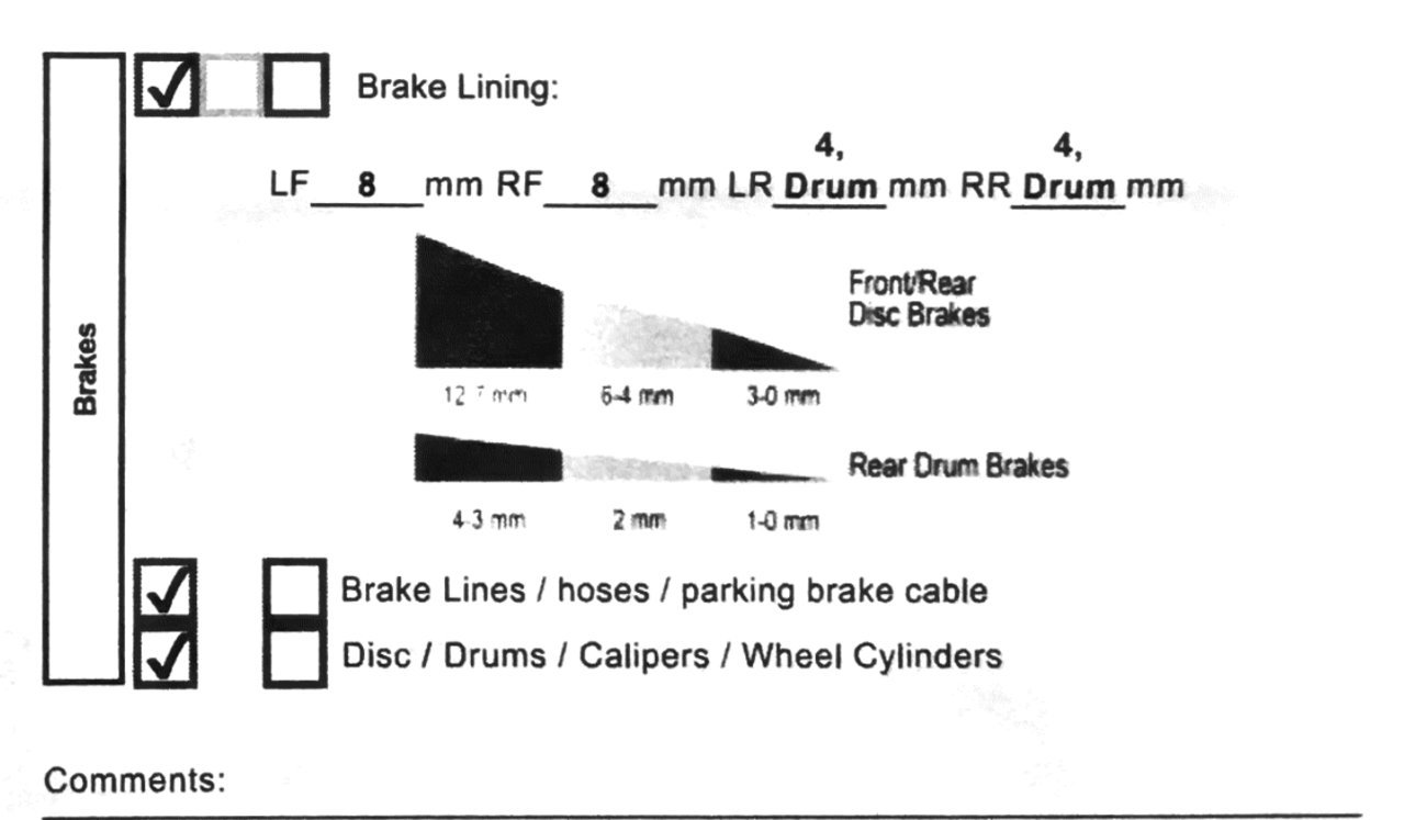

    Did they give a measurement in mm perhaps?
    This is mine at 60K.
