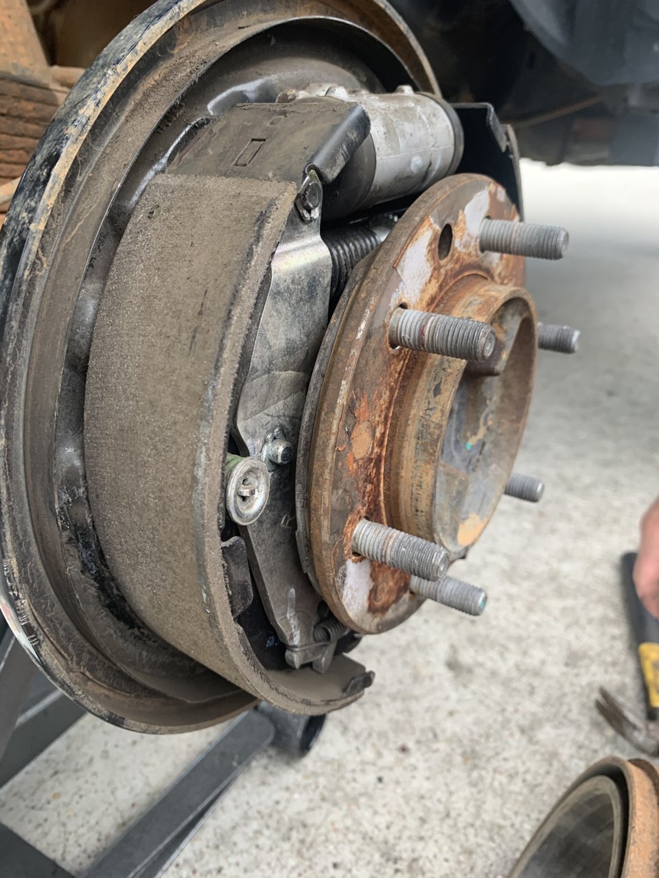

    I just changed my brake shoes and am now getting a rotating clicking sound from both sides. Also It looks like the pad is wearing only on that outer edge in the picture. From what I’ve read it’s likely a shoe to drum misalignment but not sure how to align them.
    I did have to loosen the tension quite a bit for the drums to slide back on. If I tighten them anymore they will not go back on. I’m doing something wrong here. Can anyone offer me a suggestion? D5F71096-608B-4D21-A68B-5991D40485C2.jpg

    OEM or aftermarket? OEM only.
    You're supposed to back it off 15 clicks from locked.

    Autozone shoes. They’re definitely backed off more than 15 clicks but any tighter and the drums will not fit back on.

    People always have problems with aftermarket.
    If a difference in size doesn't get you, the difference in friction will.

    15 clicks from locked with the drum installed.

    I had a similar issue years ago on an Olds. The Mechanic changed the Shoes but the drums looked great so he did not turn the drums. Turned out the original drums and shoes "wore in together" . The Drum and shoes actually wore not straight across the faces. When the new shoes were put in the old drum, the shoes would "slide" over and hit the closed drum edge and click ... Turned the drums and it was fine ...

    Check the runout on the drums, (spec is probable around +/-.008) and have them turned. Hardly anyone left does it but there are folks out there that will. I use to for $20 a side. Should be able to turn them.

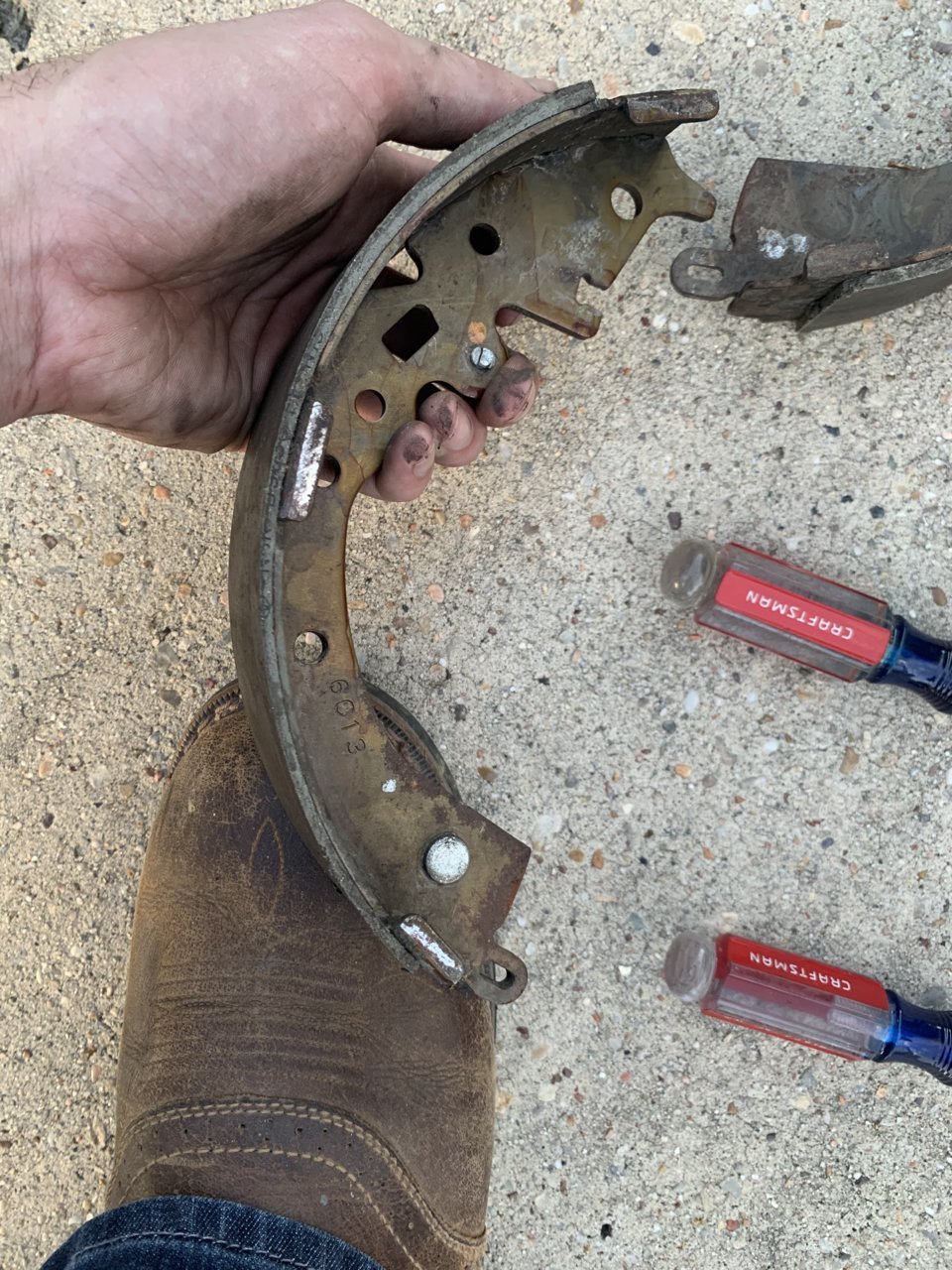

    They actually didn’t look that bad I don’t think. 67950137-7C6E-4303-ABBF-425ECC82D18B.jpgWorst case I’ll be putting them back on and trying to adjust again. I just put on new drums and I’m trying to adjust the tension from there currently.

    4.5mm is new, that looks like 3-4mm, they were fine haha.
    Best tip is one side at a time and analyze the placements.

    Those shoes look good, slap them back in and roll out. That clicking is the self adjuster and will be noisy for a bit....prolly at least 25 miles with some average braking.
