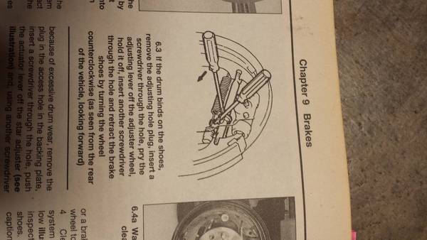

    Ok I'll adjust them. When working over the top of the tire, with a screw driver in the adjustment hole, do you turn the wheel up towards your face or down to the ground. I saw an anti reverse lever that can be pride forward? Thanks got the help everyone.

    Andy.G
    Andy.G Well-Known Member
    Jan 31, 2014
    #121972
    1,330
    Andy
    Virginia
    96 tacoma sx 4x4 2.7 5 speed
    Started automatic. Swapped to manual
  8. Apr 25, 2014 at 7:28 PM
    Trapperr
    Trapperr [OP] Well-Known Member
    Mar 6, 2014
    #124720
    1,002
    Reno, NV
    2002 Tacoma Double Cab 4x4 3.4l V6
    Thank you much!

    Don't forget you have to hold the release over as well to back them off.
  11. Apr 27, 2014 at 8:23 AM
    Trapperr
    Mar 6, 2014
    #124720
    1,002
    Reno, NV
    Well that went well. Got things all figured out. Now I know fur next time. Thanks again
