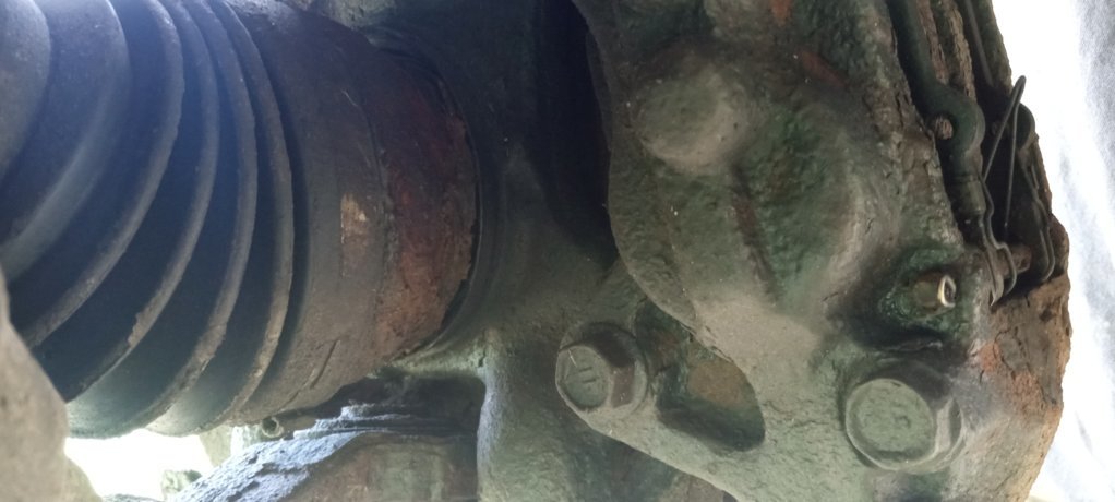

    CV axle. Where it goes into the knuckle it's rusty and sort of open, not sure how much this matters. The driver side is clean and looks nothing like that, driver side was replaced a couple years ago. This one has never been replaced. Consider replacing the axle?

    As for the CV, there are 2 dust seal where it goes into the knuckle.
    One on the CV, and one in the knuckle. It looks like your seals are worn (a lot).
    This is cause the "gap" you are talking about. I'd address it sooner than later.
    It's a big part of keep dirt (and water to some extent) out of the wheel bearing assembly.

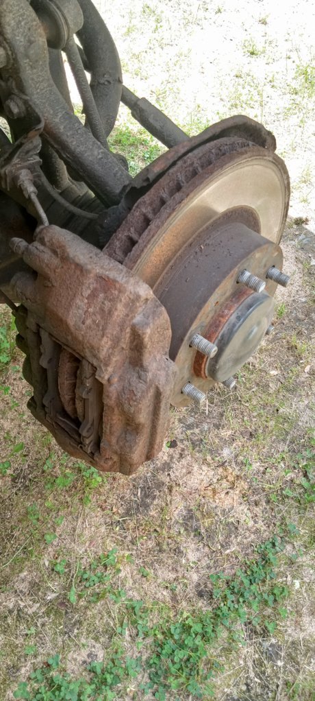

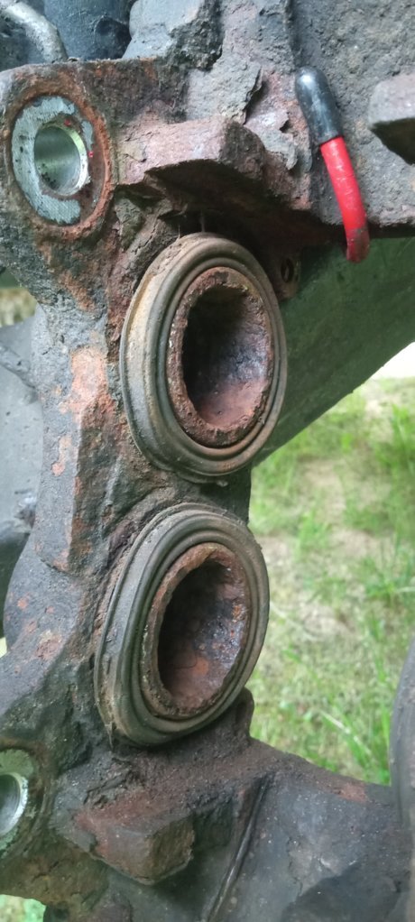

    Got everything out but it was a struggle. Pins were all seized in place and the pads on the inside (engine side) were stuck and difficult to get out. Here is what the calipers look like. The metal retaining rings around the boots were mostly broken.
    So I'm assuming at a minimum I should replace all the seals, boots etc.
    Pistons OK? If I can clean them up and be good to go I will, but replacing them seems cost prohibitive, I think I would be better off getting all new calipers at that point.

    Replace those calipers: They've had it. You'll either be back in there doing them in no time because of weeping/leaks from the pistons, or you'll lose the brakes. Retracting the pistons to remove the pads and rotors likely scored them even more than they already were. 75,000 miles isn't a lot for brakes and rotors, but 12 years is: and from the appearance of all of the parts (rust and corrosion) it appears it has been a very tough 12 years....

    Replace those calipers before they cause you trouble.

    Concur. Those calipers are beyond trying to save without a complete rebuild. Much better to just replace them with new/rebuilt ones. Take a good look at the brake lines to see if they should be replaced too.
