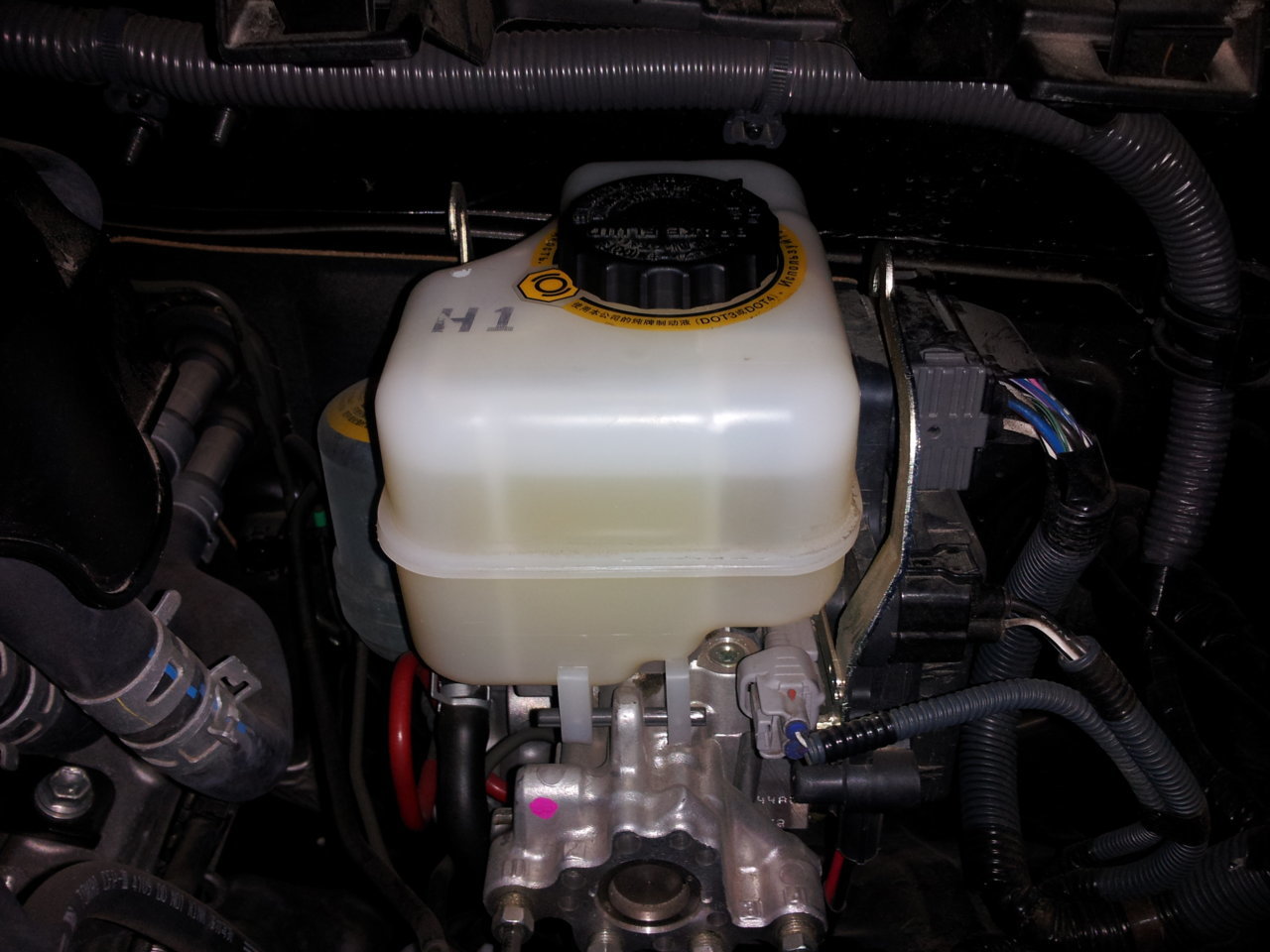

    ISSUE:
    No fluid comes out of the rear brake lines. I’ve replaces the rubber lines in the front & rear already
    when I replaced the rear, fluid was coming out so I don’t think there is a block.
    The only time fluid will come out is when I pump the brake once, after that nothing
    Front brakes are fine, fluid comes out & it’s been “bled”
    Any ideas what it can be?
    Solution:
    Per post #2 & #9, my truck has an automatic bleeder that all you do is put the key on the “ON” position & hold the brake down. This pushes out the brake fluid.
    Repeat this a couple of times until the fluid coming out is clear & no bubbles in the clear hose. Highly recommend to use a bottle with a clear hose connected to it so you can see the fluid coming out
    Always keep an eye on your fluid in the reservoir that it’s not running low while doing this.

    Turn the truck to ON (motor not running). make sure the brake fluid is topped off, press n hold the brake pedal, electric pump should push fluid out continuously until it build pressure (bleeder closed) or it runs out of fluid to pump... dont let it run dry.

    The brakes work fine but here and there they will sink in all the way .. makes it pretty unsafe when driving

    Only question is, do I need a 2nd hand or can I still do the 1 man brake bleeding job technique with the plastic bottle?

    When you have time - read the ENTIRE URL I pointed to in post #9. You will learn that the auto bleed function only works on the rears, so yes, you can do a 1 man tube submerged in a bottle thing to flush the fronts.

    I just mimicked what post #2 & #9 said. I’ll give it a test drive tomorrow morning and keep you updated.

    with the electric booster its easy. Top of rez, turn the truck to on, place a piece of wood between pedal and drive seat and slide forward so the wood holds the pedal down.
    Walk to the wheel you want to bleed n crack the breather... and let the electric pump do its job.

    It worked. The pedal feels just like normal again. Thanks bro

    So the problem continued after all this ..
    Last night I decided to flush every single line all over again. I used (2) 32oz bottles of brake fluid. I test drove this morning and it felt fine, I’ll post later on to see if anything changes
