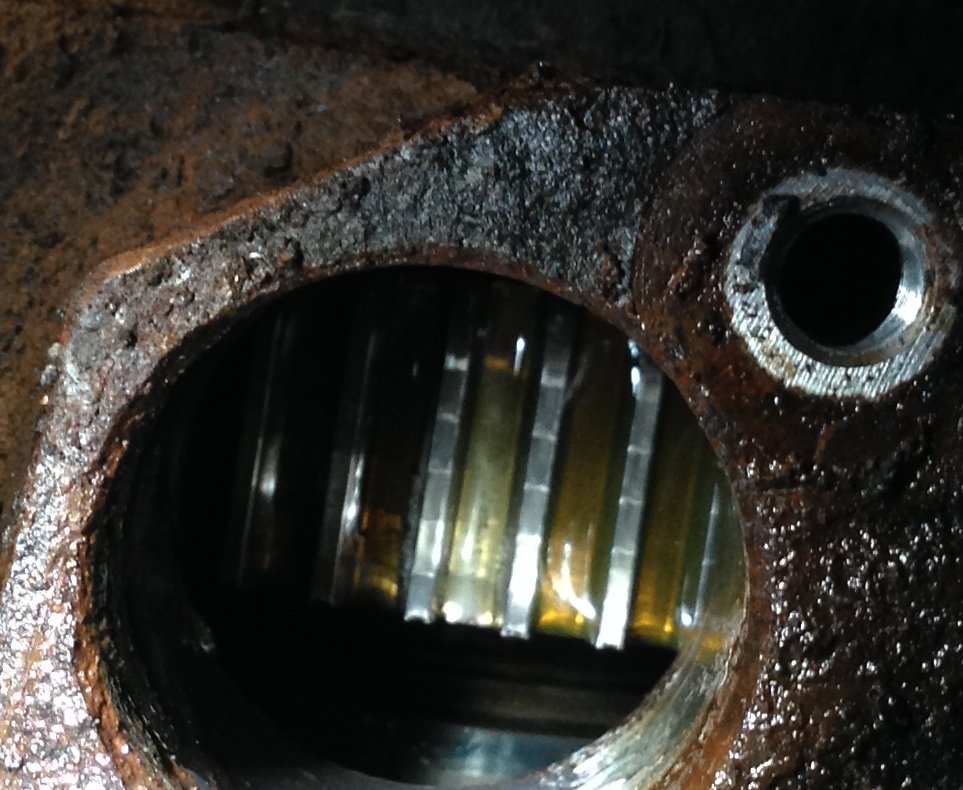

  10. Jul 12, 2017 at 10:36 PM
    toyotamd
    toyotamd [OP] Well-Known Member
    Jun 25, 2017
    #222409
    84
    Arizona
    2002 Xtra Cab V6 auto TRD
    like this? i assume the golden fluid is gear oil, meaning by axle seal has failed?
  11. Jul 13, 2017 at 6:04 AM
    nzbrock
    nzbrock Well-Known Member
    Jan 6, 2013
    #94572
    3,239
    Noah
    San Marcos, TX
    99 TRD Prerunner 3RZ
    SAW 2.0 Coilovers Wheeler's 5 Leaf + 3 AAL Bilstein 5100s LCE long tube header Flowmaster Delta 50 Muffler FJ Trail Team Wheels 4Runner overhead sunglass console 4Runner leather seats All LED lights Red/Clear Tail Light Tundra Brakes HID Projector Retrofits 4Runner Auto Up/Down Windows Bullet Liner Cargo tie down system E-locker axle swap w/4.56 Gears ARE MX Cap Prinsu Toprac Custom heated turn signal/puddle light mirrors Volant Intake Tube
    Yes that is correct. There should not be anything inside that tube right there except bare metal. The axle seal rides on the "retainer" that is on the inboard side of that tone ring (for abs). If you have a bad wheel bearing, it can cause the axle seal to fail. So it is usually a good idea to replace the bearing when replacing the axle seal, unless you know it's good.

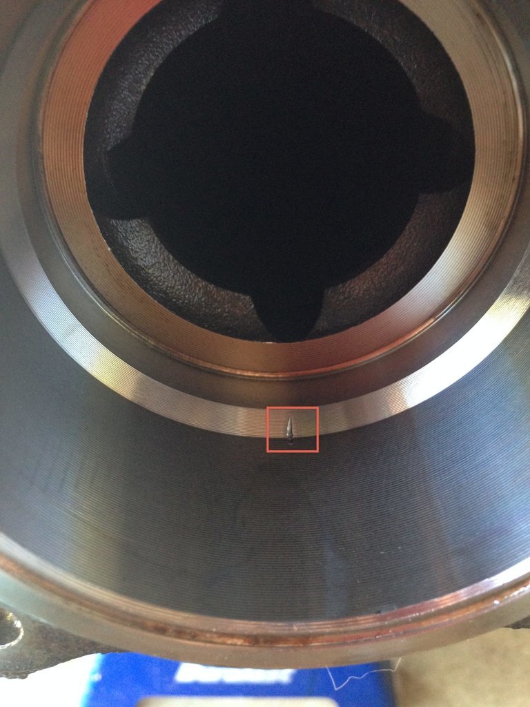

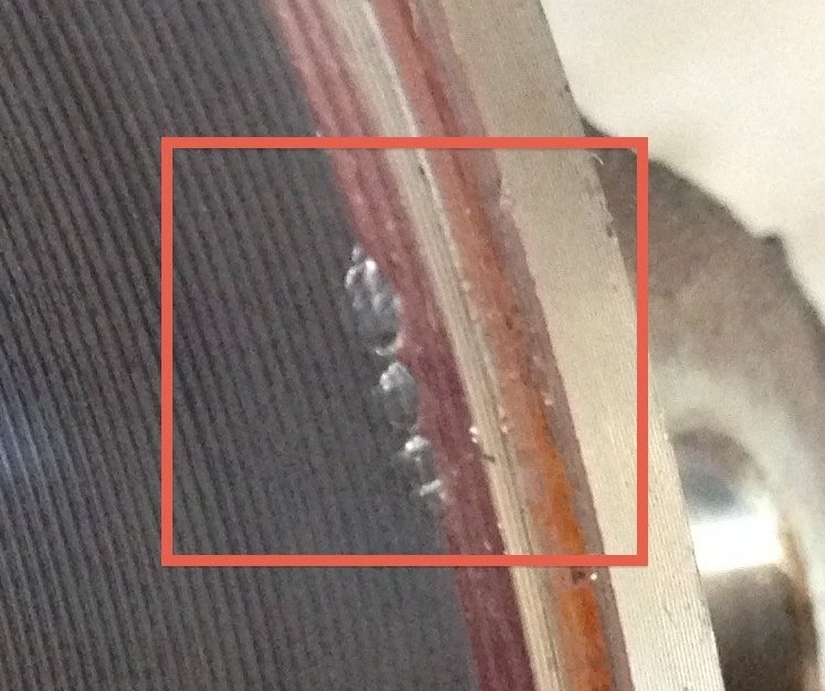

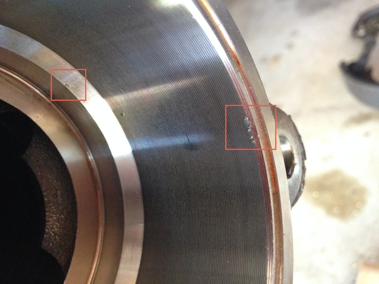

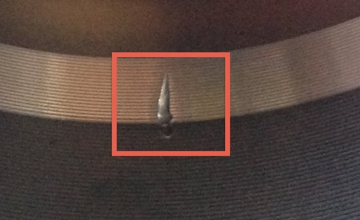

    so i removed the axle to replace the axle seal. unfortunately, when I was pulling the seal, i clumsily scratched the metal inside of the cylinder just outside of where the axle seal sits in a few spots. see pics.
    just wondering if anyone knows whether this is problematic. you can feel the scratches with your finger; the worst is maybe 1 mm deep. i was thinking maybe smooth them down with a dremel? it's just not clear to me whether these locations will ever be in contact with anything else in axle/wheel assemble.

  13. Jul 15, 2017 at 3:48 PM
    nzbrock
    Jan 6, 2013
    #94572
    3,239
    Noah
    San Marcos, TX
    Those shouldn't pose any problems. There is only an o-ring at the end of the tube to keep dust out. I would just make sure there are no burrs and you shouldn't be fine.
