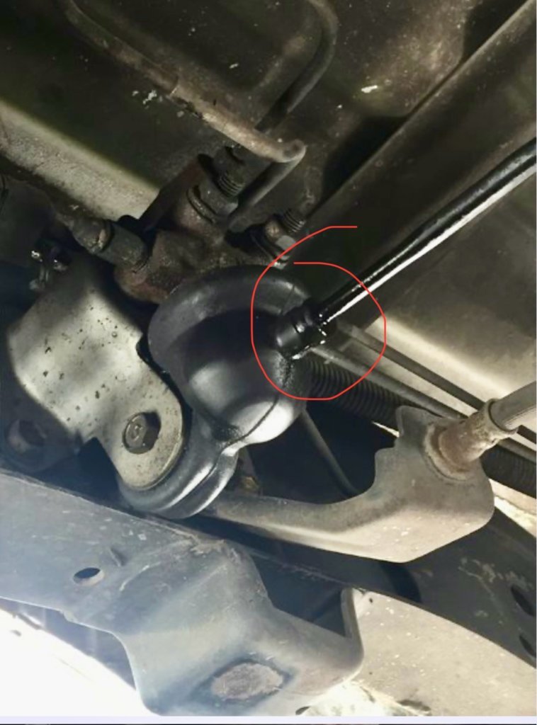

    I was wondering what to do with the boot of my Proportioning valve leaking could I just put a zip tie on this rubber part to stop the leak, and how much of a hassle is it to replace it or install a delete Kit? Thank you in advance.

    Brakes matter. A zip tie is not a fix
    Replace or remove the offending part. Either choice is a step towards safety.

    Needs to be fixed, you'll lose pressure eventually.
    They can be a bastard depending on rust, yours doesnt look too bad.
    Order it monday.

    Last I searched, LSPV was $268 from Toyota
    that’s why I deleted
    $40 from JEGS and $8 for fittings
    Lmk
