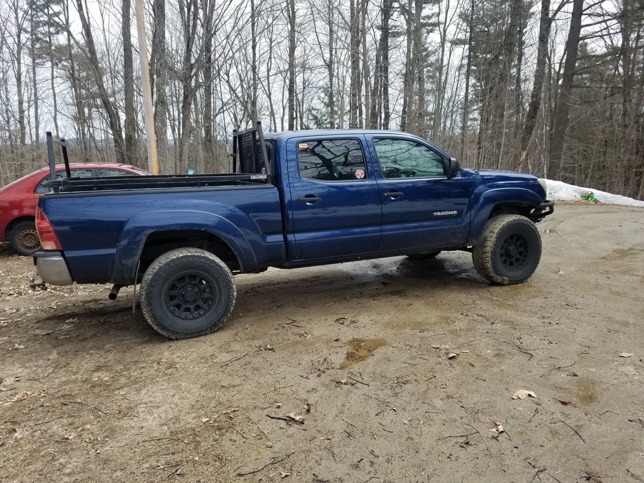

    Hey guys/gals, I have an '06 DCLB, bought a yr and half ago. It already had some modifications done, and I didn't think to save the list from the ad when I bought it. Occasionally I haul heavy crap in the bed (firewood, other heavy things). Upon brief inspection to see if my suspension is sick or not, it appears I may already have the HD spring pack on the rear. 4 leafs. 1 leaf broke recently, obviously looking to replace. Now the question is replace with the normal HD springs, or go even stiffer? I mean, could just get a bigger truck, but... different discussion.
    My ride heights to fender are about 22" on front and 23"-ish on rear. No spacers or body lift. Front cab mounts are trimmed, 285/75-16's on it. Love the truck!

    I'd go Dakar EL096R with double over loads
