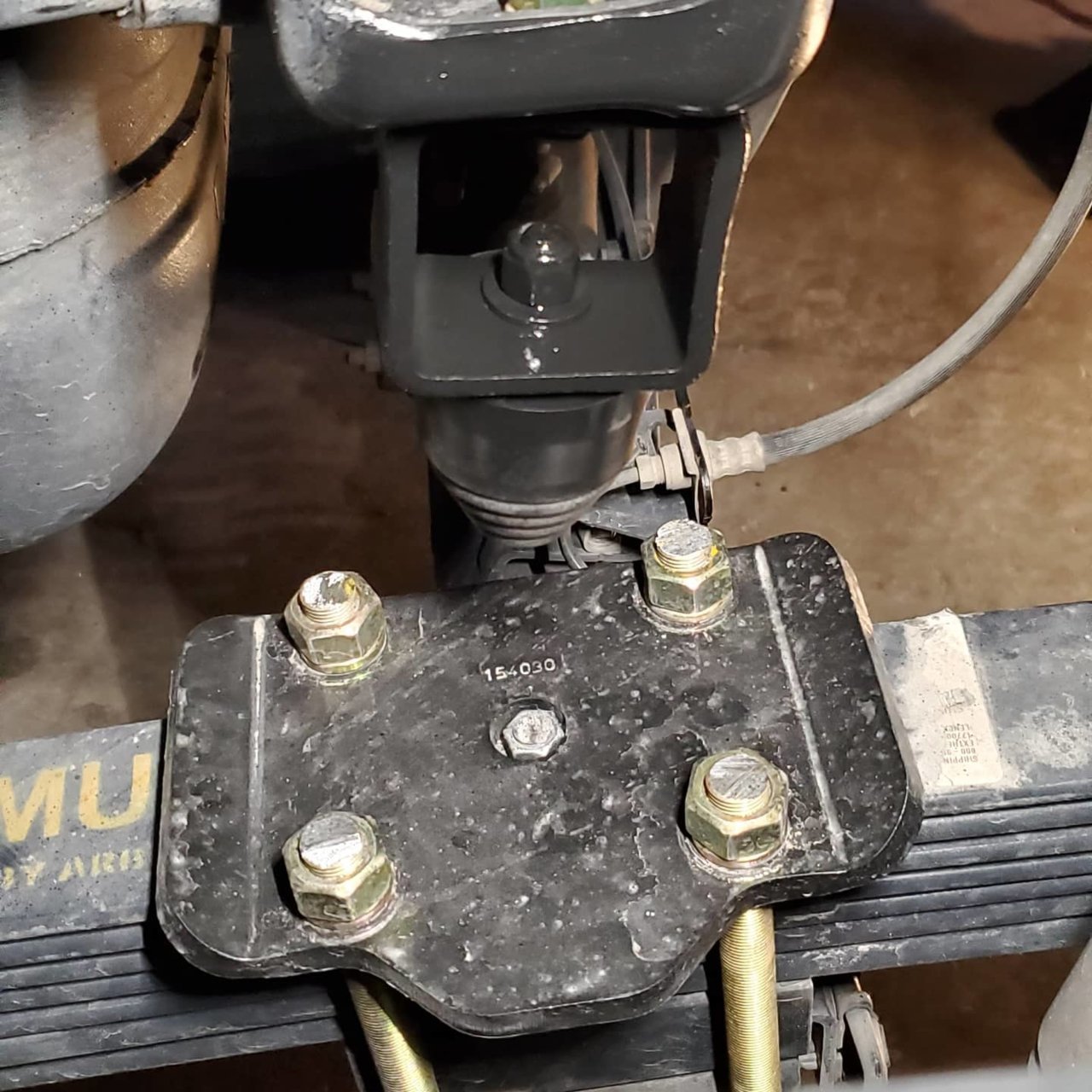

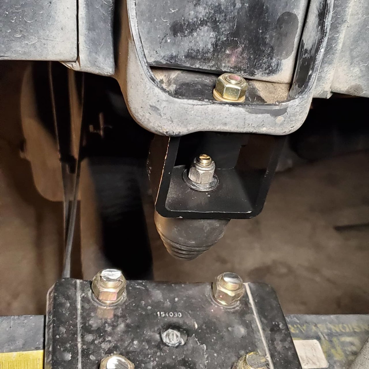

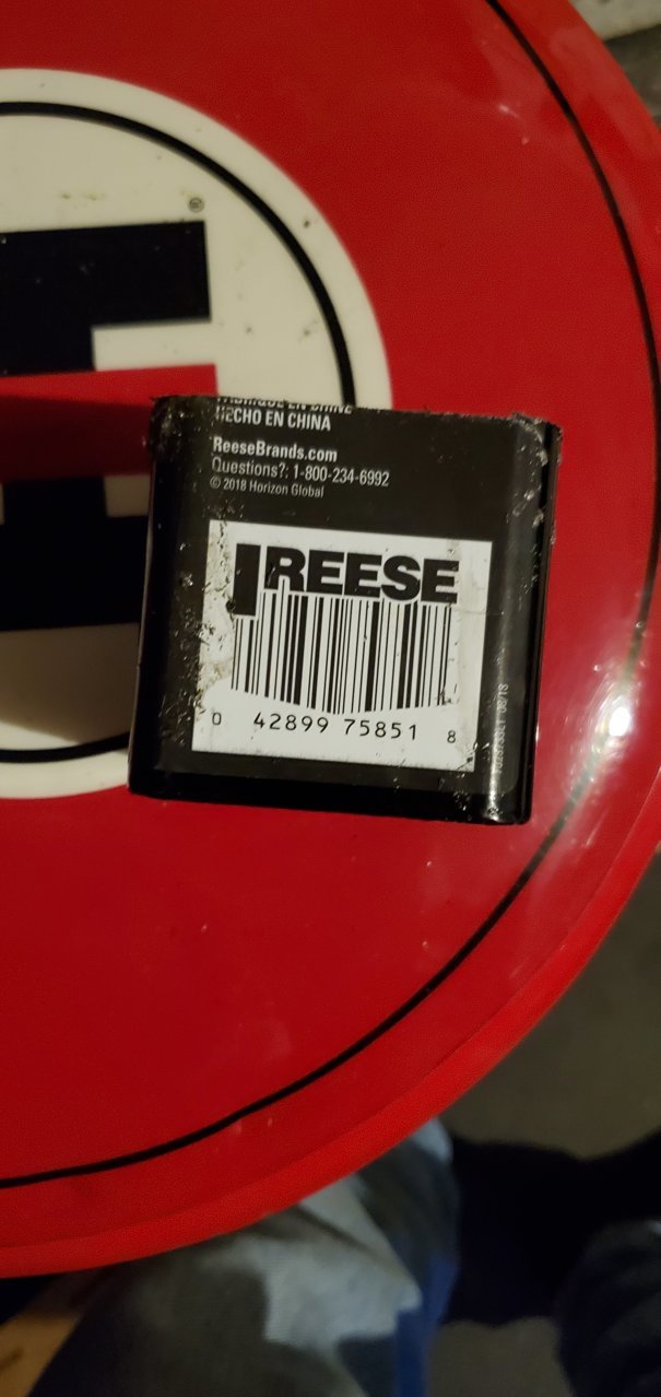

    well, I installed OME 2.75" HD leaf springs, and my solution to extended bumpstops was cheap. Maybe $45.00 all together. No phone order, no waiting, no over priced products (just my opinion). Here's how it went down.
    2" receiver hitch extension by Reese for $22.00 and seay-a-way cone bumpstops from Autozone. Maybe $17, or $18.00 and a few nuts and bolts. Cut two 2" pieces from the hitch extension, drilled top and bottom offset from each other to center the bumpstop, and rattle canned the edges to keep rust at bay. 20200921_193922.jpg IMG_20200921_204537_380.jpg
