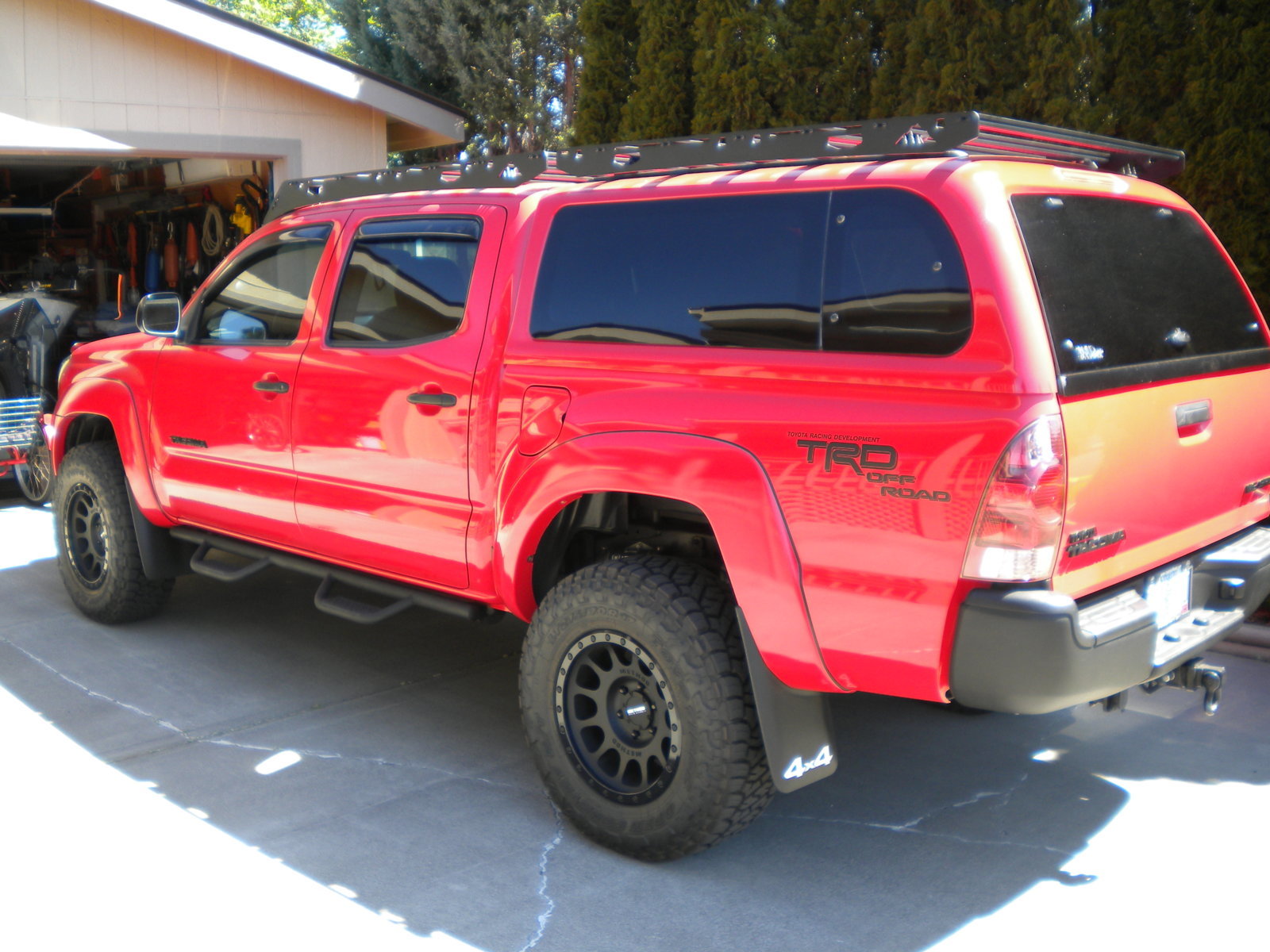

    depending on the condition your bumper Bumpershellz might be an option. Installed it on my 07 couple years ago to cover the chrome and it's held up great. Also, you can get it color matched.

    It has a lip that goes underneth the black plastic parts on the bumper and the outside edges are secured with 3m tape. Install on a warm day to help form the part around the curves/contours.
