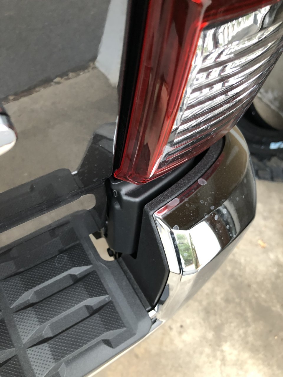

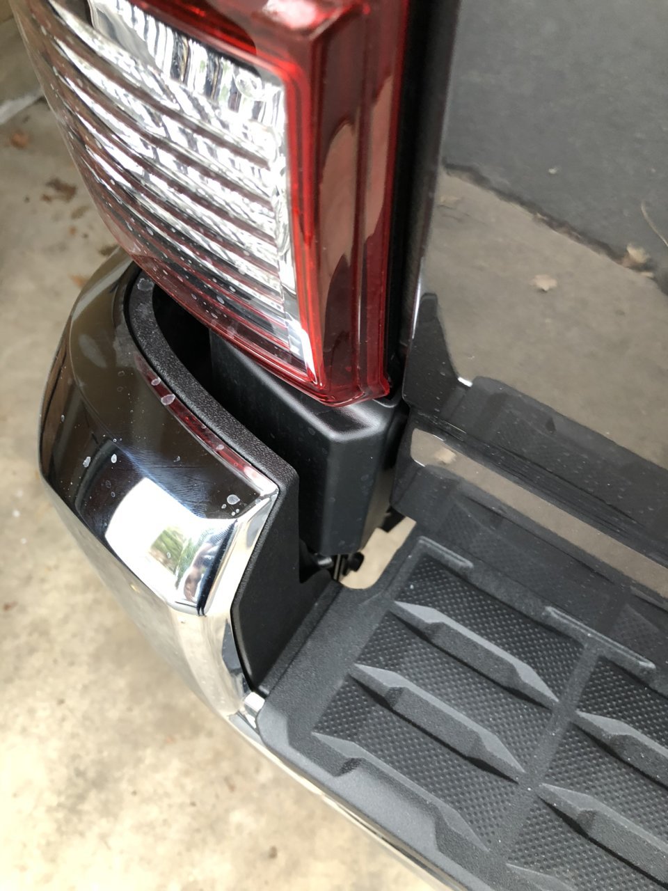

    So was cleaning my truck today and noticed my rear bumper is misaligned and doesn’t have equal spacing. Pretty sure no one hit me and it’s a 2 week old truck. Take it to dealer? Granted I’m a little OCD, but seems like a decent gap and not normal.
    Driver side:
    Passenger side:

    Mine was identical to yours up until last Saturday. I removed the rear bumper, aligned my bed correctly, and then aligned my bumper to the bed. Easy to do all on your own.

    Yes, almost every single one is somewhat not aligned. Some worse than others.
    There is a thread on here with a great video of how to remove your bumper. I should be able to find it for you.
    Also, I would not have been able to align my bed to the cab with how the bumper was sitting. That is why I had to do both the bed and bumper. YMMV

    They're all like this, completely normal.

    I think some people have had their dealer do it. Some dealers have told people its impossible to do too haha I'd rather not have them shove on my bed and bumper. I did it myself no problem. Bed moves very easily once you loosen the 6 bed bolts. Most difficult part was removing the license plate lights.

    So nothing is bent/damaged or anything, just installed misaligned? If so I might ask dealer at 5k service to do it or just live with it until it bothers me more. Also, is a misaligned bed obvious? I never checked it but didn’t notice it being off.

    Its all looks, nothing bent/broken. I was installing bed stiffeners so I went ahead and did it all at once. Had to remove the rear two bed bolts to install the stiffeners anyways.
