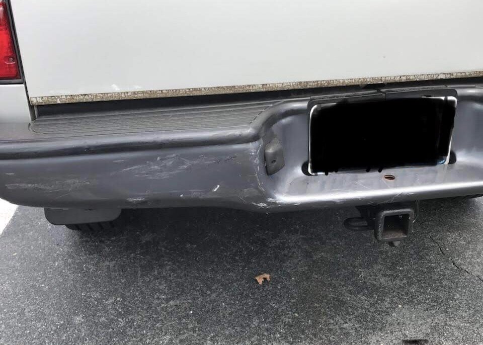

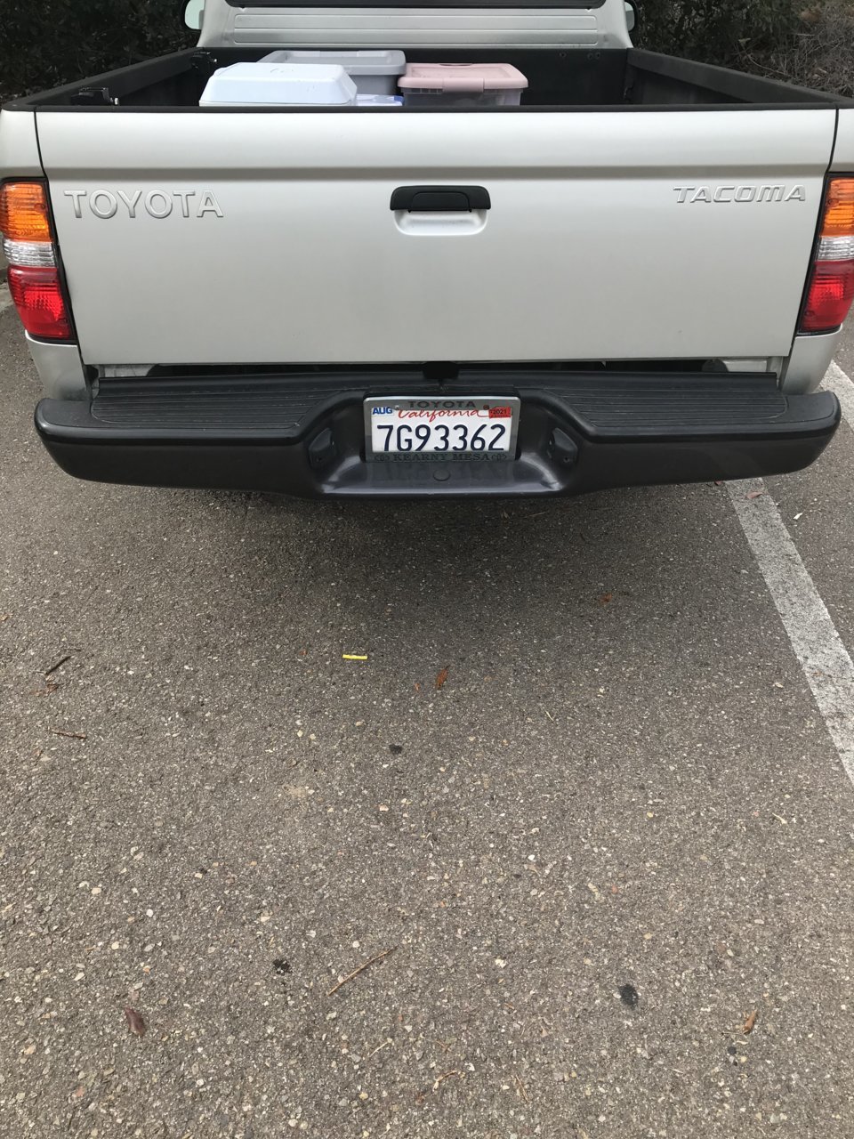

    before:
    after:
  7. Feb 13, 2021 at 10:21 AM

    yeah, the after is the aftermarket one. They are very similar except fir the gap between the plastic cover on the new bumper and the tailgate when it is open is much better. It also doesn’t ride up in the center where the tire lowering pipe goes. Also, the plate lights are a little better.

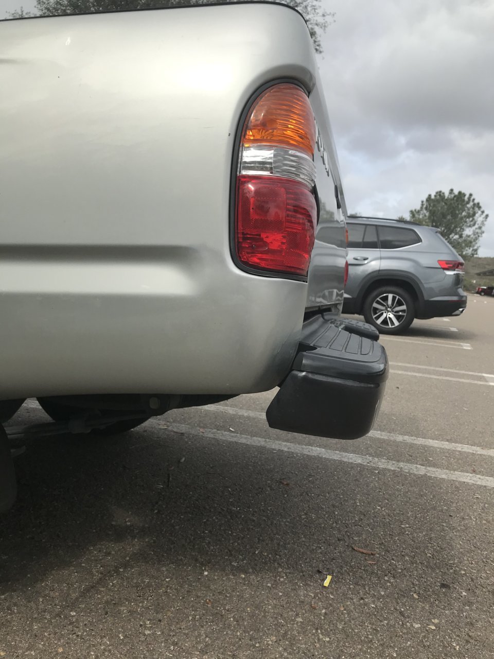

    Not too much to see really. I needed the cash at the moment but will eventually get it back to normal one way or another.7D6A6D52-80A1-4BBE-9A3D-1633C3B35064.jpg E6393A25-92F8-4802-9049-3E0512B619E7.jpg

    That really doesn’t look too bad. what if you used a floor jack below it as if you were going to lift it from where the hitch would be?

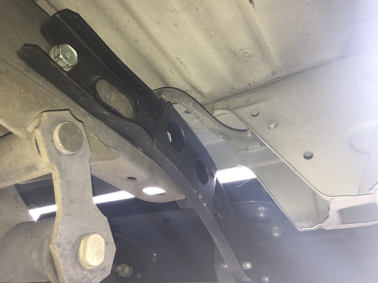

    Before I would do anything I would loosen all the bolts on the bumper and attaching brackets and see if it can be pushed back into place then tighten the bolts. I think there are four on each side.

    Loosen the mounting bolts and adjust it up.
    Close enough.
    At the most a couple brackets from the junkyard.

    Second this. Loosen all bolts that attach the bumper to the mounting brackets and see if you can adjust to a flatter level. If that doesn't get you straight- go with the other advice in using a jack to bend it back- however, as another mentioned it won't be as strong.
    If the loosening doesn't work, and you're not comfortable with the strength, get some new bumper mounting brackets for $32 .
    That should be all you need, as the bumper itself is fine- just your brackets are bent. I had the same issue on my truck, got rear ended, and just the mounting brackets were damaged.

    Guys...I may just try the jack up fix if the wheels don’t start lifting off the ground. Looking at it I can’t even see what exactly got bent, it’s that unnoticeable. I’ll just have to try jacking it up and see if it raises the wheels too, then go with plan B.

    that almost looks adjustable. I wonder if loosening the bolts with the jack then retighten is all you will need to do.

    Looks bent
