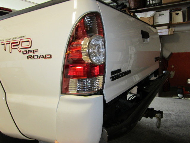

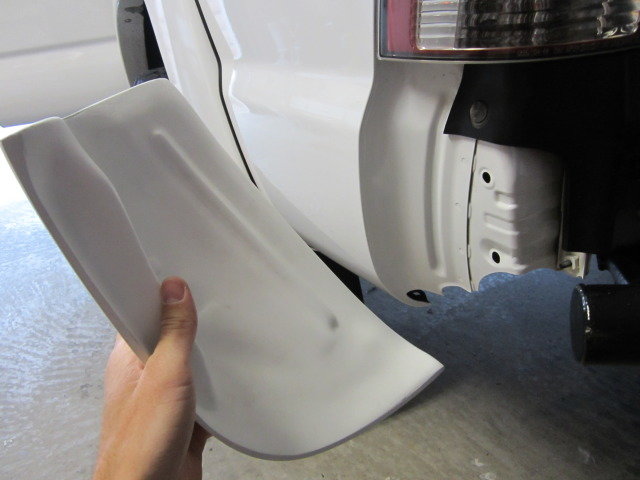

    So after pulling teeth and breaking arms I finally got Tim at glassworks to make these rear bumper caps and fill in the uglyness.
    These parts are extremely rare and nobody ever buys or seems to need them. How exactly do you attach these? I'm thinking drill holes and screw them in, but maybe there is that ONE guy out there that has actually done this before and can give some feedback. Check it out...
    IMG_4583_8c15ca84d49df9101f18cc390690cedb1c0ff292.jpg I already removed the black plastic tab in this pic

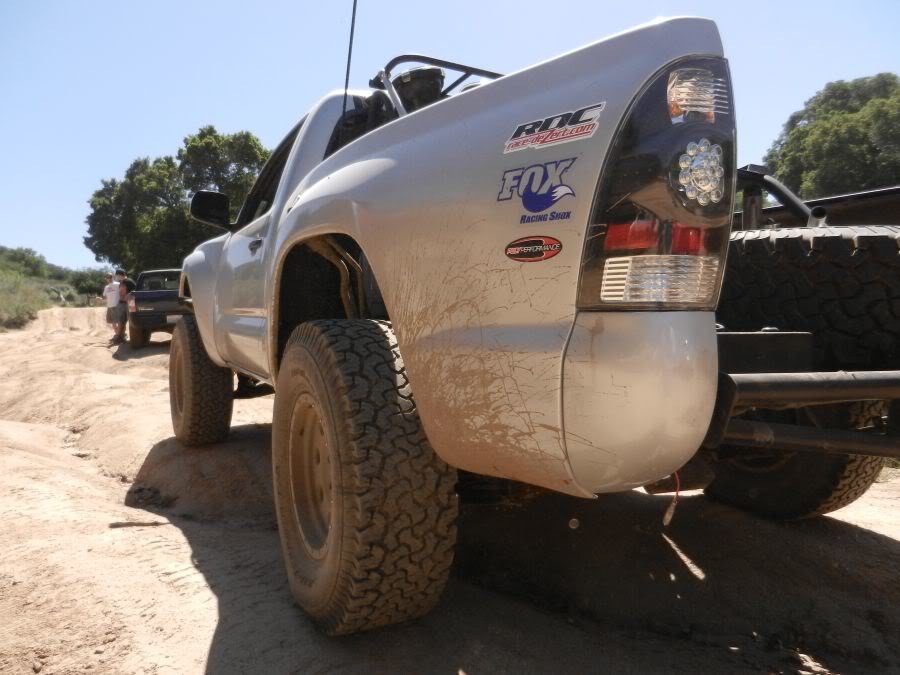

    He had those on the shelf when I went in there. AllPro has a different style too. I keep meaning to put a set on mine, but can't get around to it. Now if someone would just make something similar for the front.

    You have to glass in two bolts on the backside of each the cap. The bolts will then go through the two open holes that you can see in your pic above. Probably best thing to do is to line the caps up, and using a couple of sticks you can tape to the back of the caps, you can get the spacing and angle down properly, then replace the sticks with the bolts.
    I can take one of mine off and show you what I mean if you want.

    I drilled some holes and screwed them in, then took it to Perry at McNeil racing who is going to reinforce with glass. They seem to stay pretty good by just drilling holes and tightening. I used the existing holes and also made some additional ones just to keep it solid... I'm getting them back tomorrow color matched.
