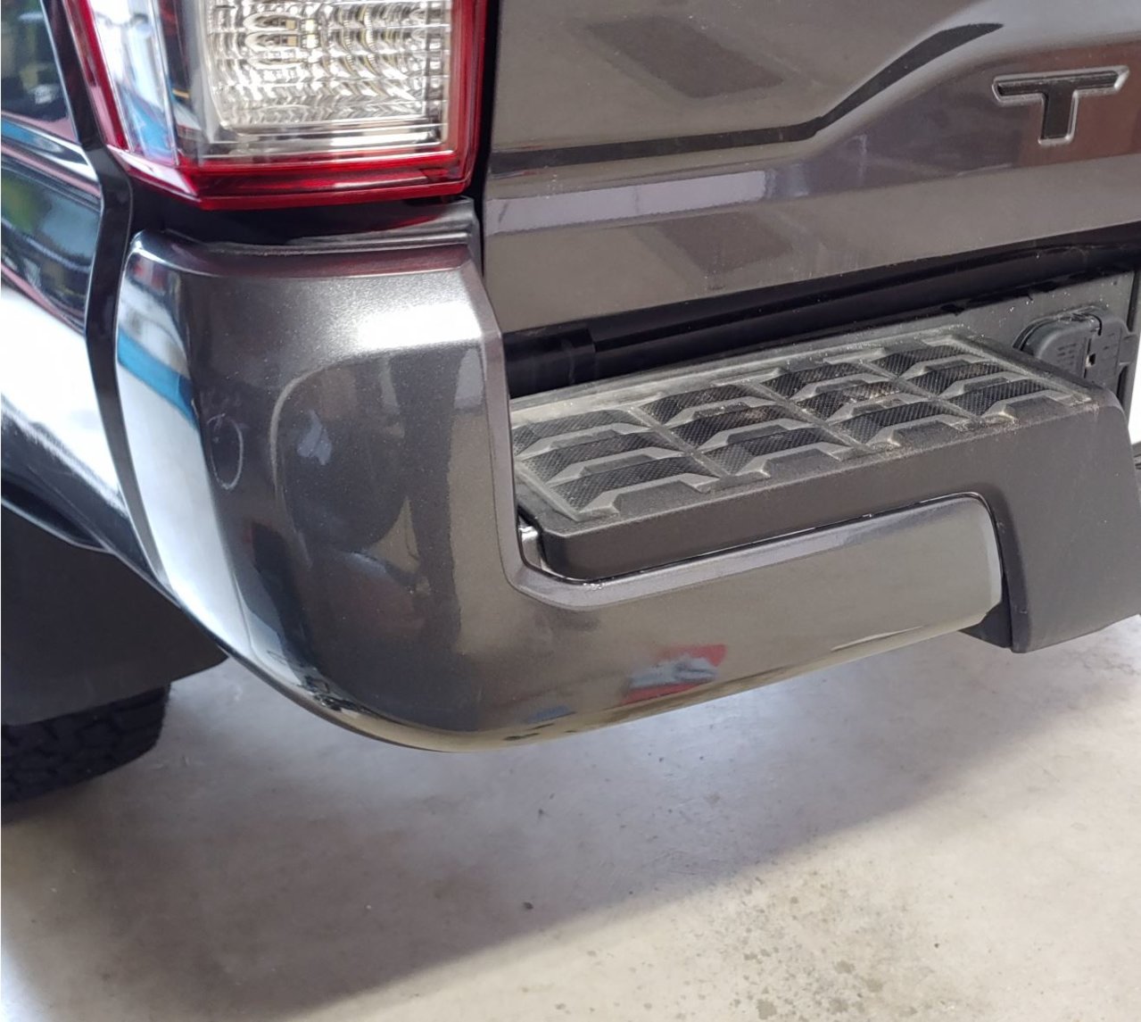

    You can try your luck at wraping the bumper caps as I did. Wasn't too difficult to do it just takes some patience and a heat gun. Search tacoma bumper wrap on ebay cost about $45 for two color matched sheets.

  13. Apr 27, 2020 at 2:57 PM
    Sw8nkie
    Sw8nkie New Member
    Apr 5, 2020
    #323935
    4
    Michael
    2017 Tacoma SR5
    Did it come with a kit or just the wrap?
