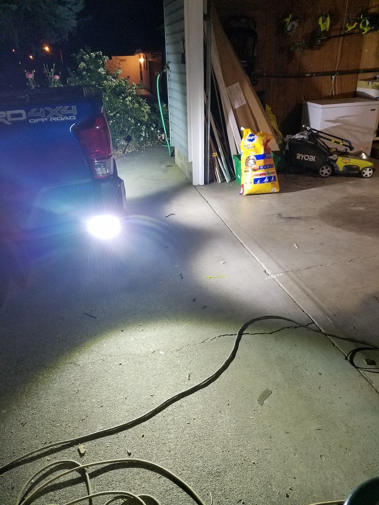

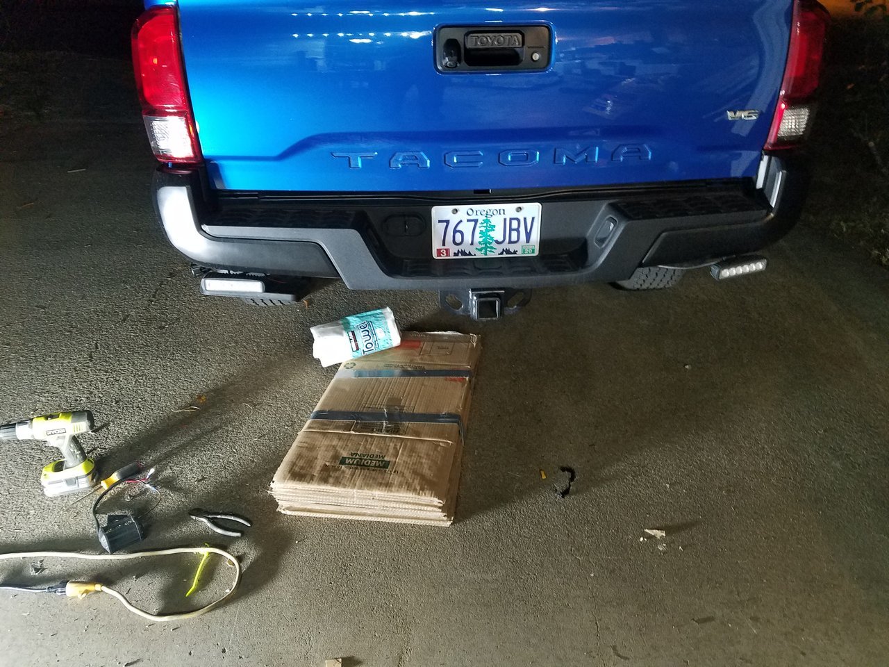

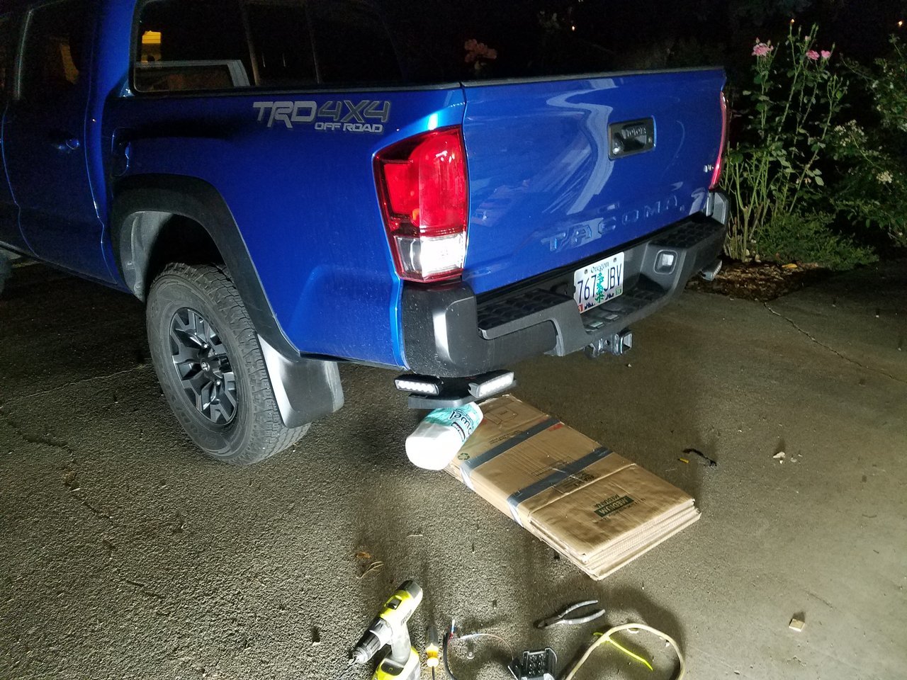

    Ive had a set of these cheap 18w lights facing directly backwards for a while, and i really like them. The price point is down enough, ~$6/light, that i bought another set just to have as a spare.
    I got to thinking, i could mount the other set facing a little more sideways.
    Is anybody else running two set of rear bumper lights? If so, lets see them. Picture is just one side mounted.

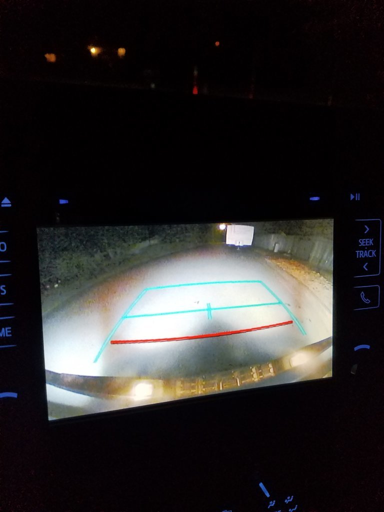

    Looks good, I was thinking of picking up a cheap set of leds for reverse lights. With the shell it's hard to see at night with the backup camera. These are cheap enough that I may actually do it. Thanks for posting, truck looks good.

    They are super easy to mount like this too. There are push screws that are holding the bumper caps to the bumper, pop them out, bore out the hole a little bit, and you've got the mounting holes.
