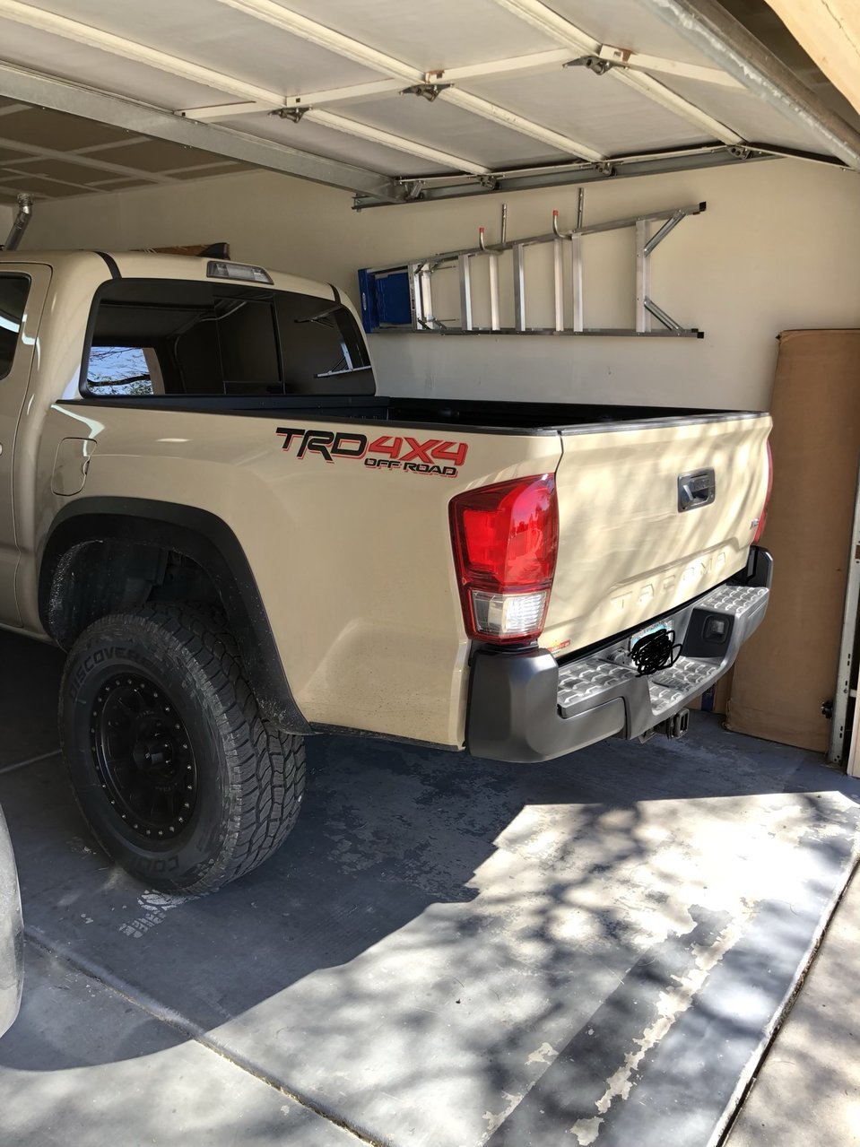

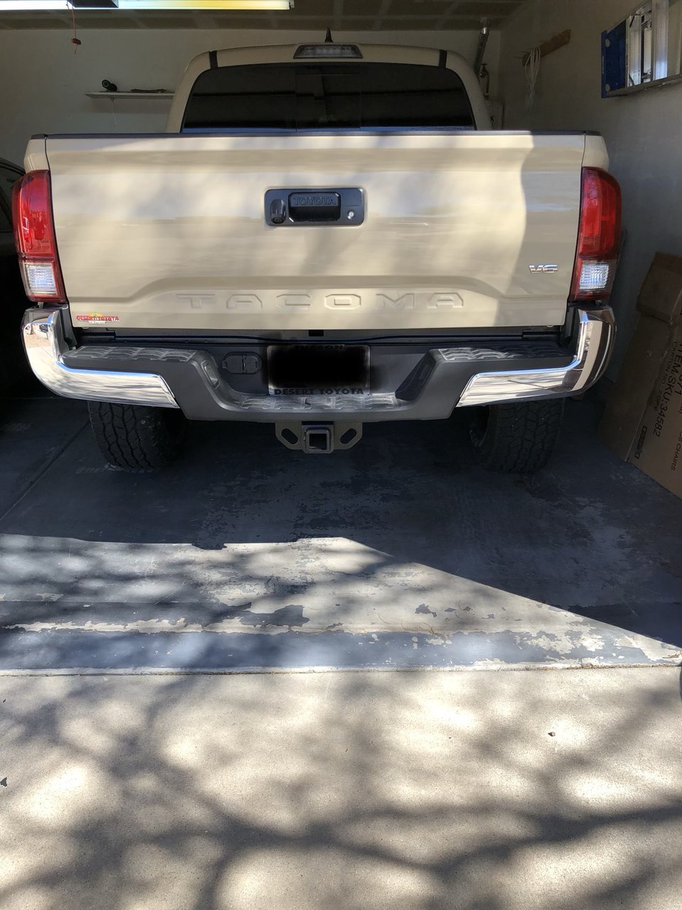

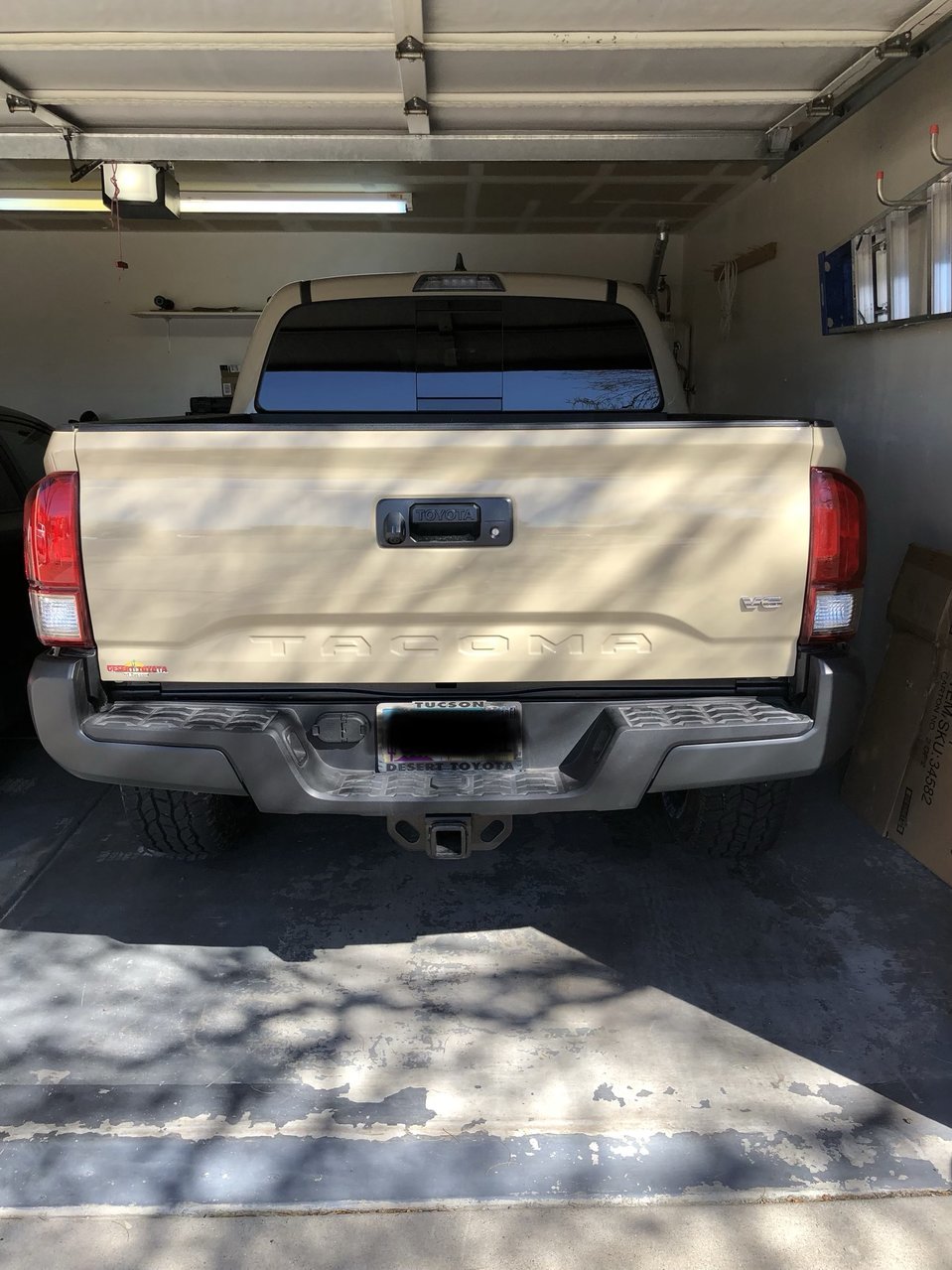

    Super quick, got my caps from RockAuto

    I just ordered the same bumper caps from Rock Auto. They were the "black" ones right? I couldn't tell from the pictures if it was matte black or painted black.
