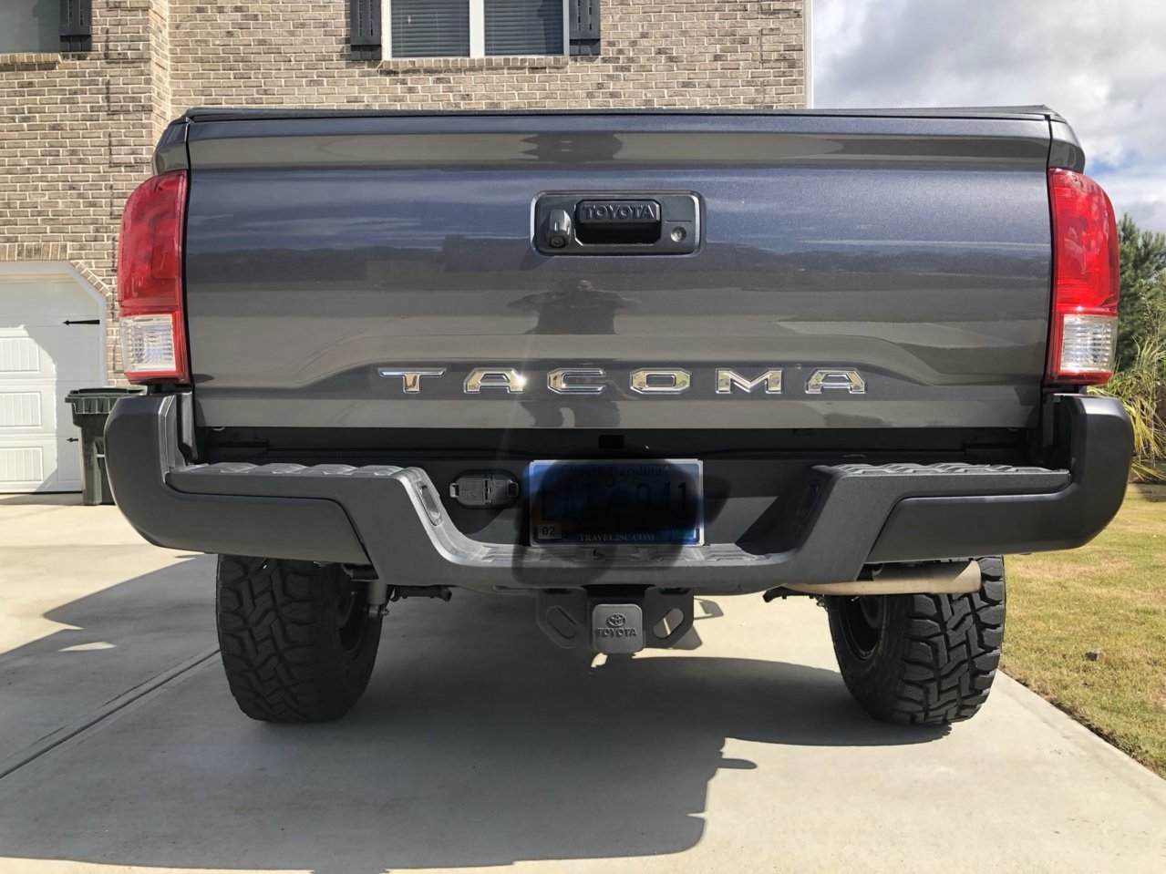

    Just did mine. I recommend removing the caps, there is a video on YouTube that was helpful. (search Tacoma bumper cap removal)
    The Rust-Oleum flat black is pretty much spot on color wise

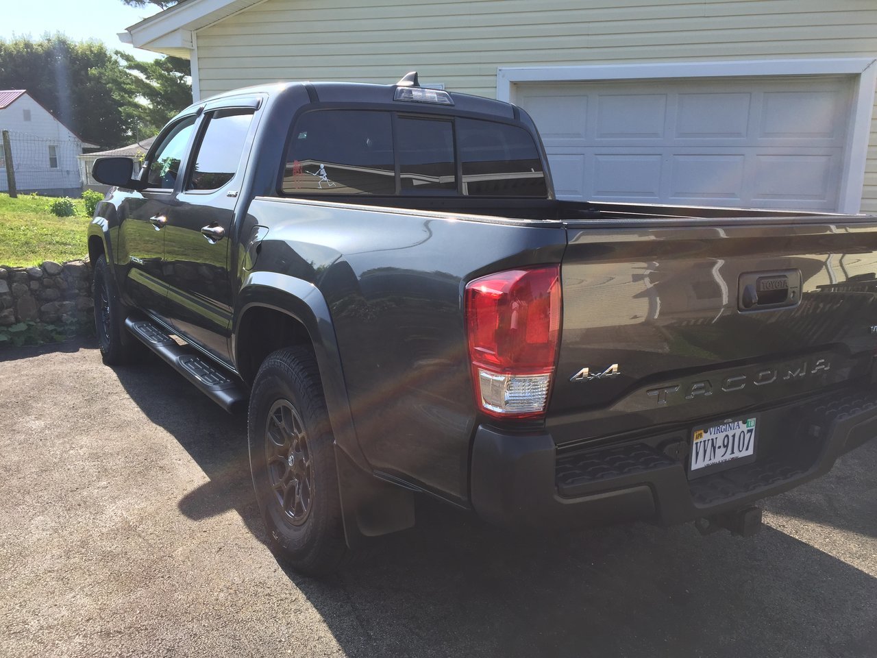

    Here is mine. I used Plastidip and could not be happier with the results. A few months old and holding up well. I dd not remove the caps, just taped it off well. Sorry for the glare.IMG_2009.jpg
    nibrwr likes this.

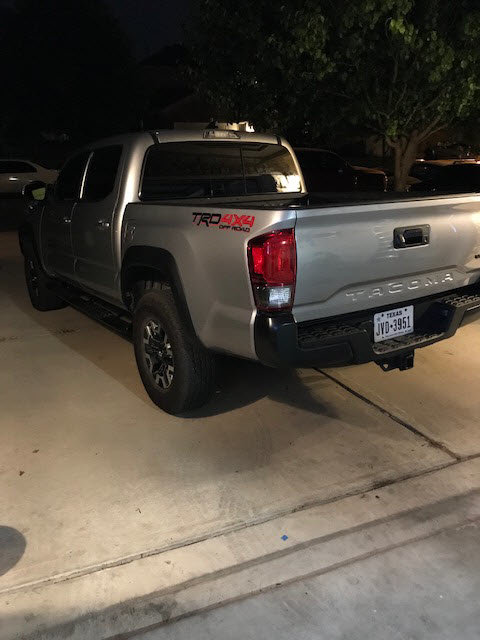

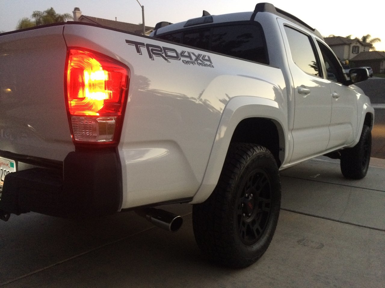

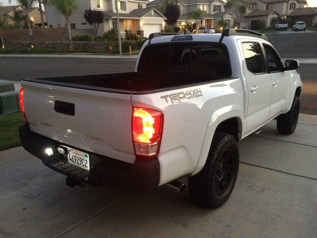

    Just finished mine last night. Turned out great.

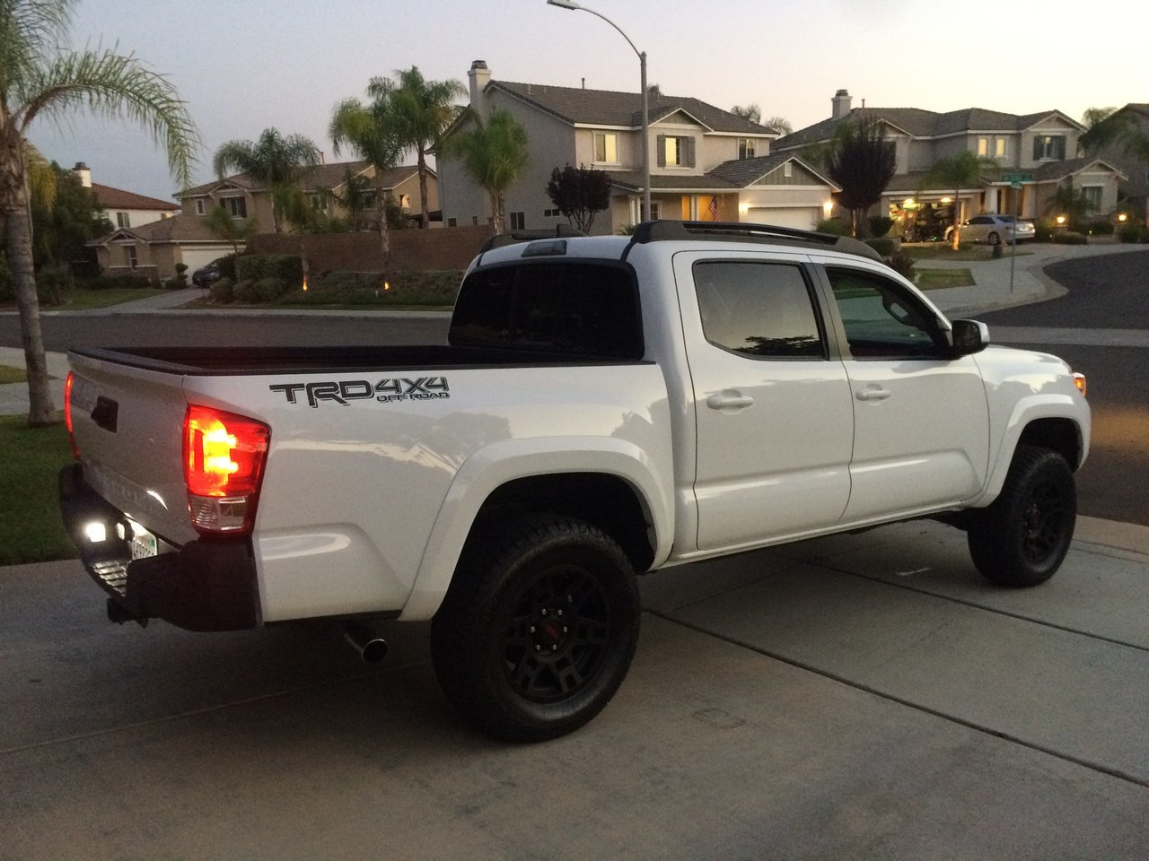

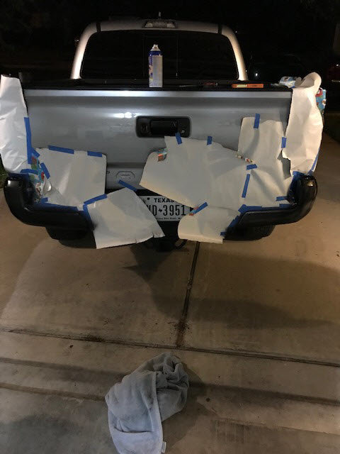

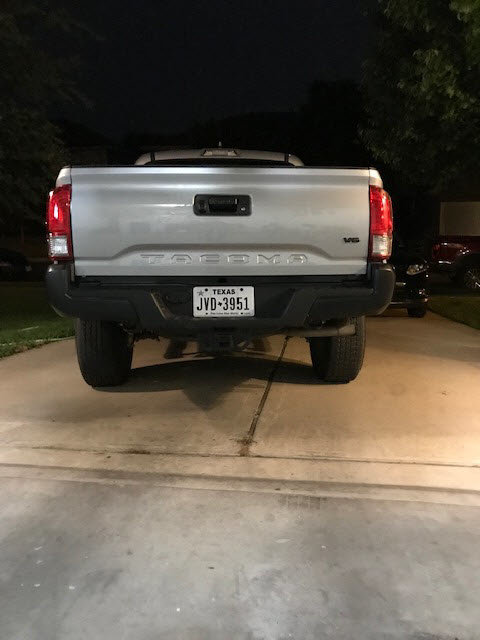

    Did mine with some friends and cold beer. Still holding strong after about 7 months. I used about a can and a half. The glossy look in the picture went away once it was fully dry. Think it ties everything together being black!

    Just did it last weekend. First coat had me worried because it looked horrible but came out good, it was 7 coats I did
