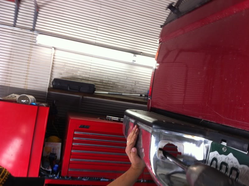

    Here's a little trick to get to the rear most bolts on the bracket. Go through the license plate lights' holes
