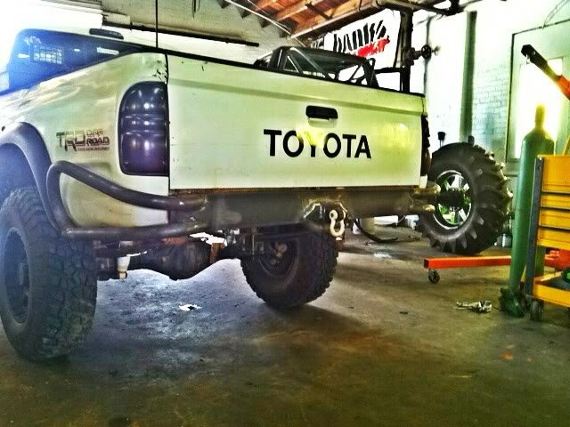

    What kind of rear bumper is this? It looks great. Here's an idea... Let OP (skeezix) buy my stock rear bumper (great shape) for $200, and I'll get one of these. I'm in Boulder, CO, just like Madjik_Man

    I wouldn't paint that (the subject in the 2nd photo) - chartreuse is fine with me :D :D

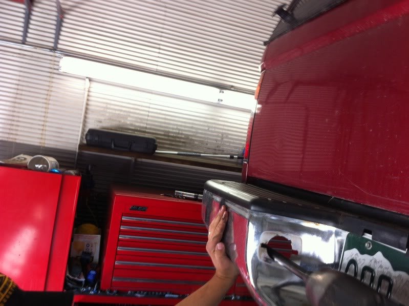

    I was fortunate enough to have a generous TW member give me his stock rear bumper.
    My original one was dented to all hell (see my sig) and also dented my body just under the taillight.

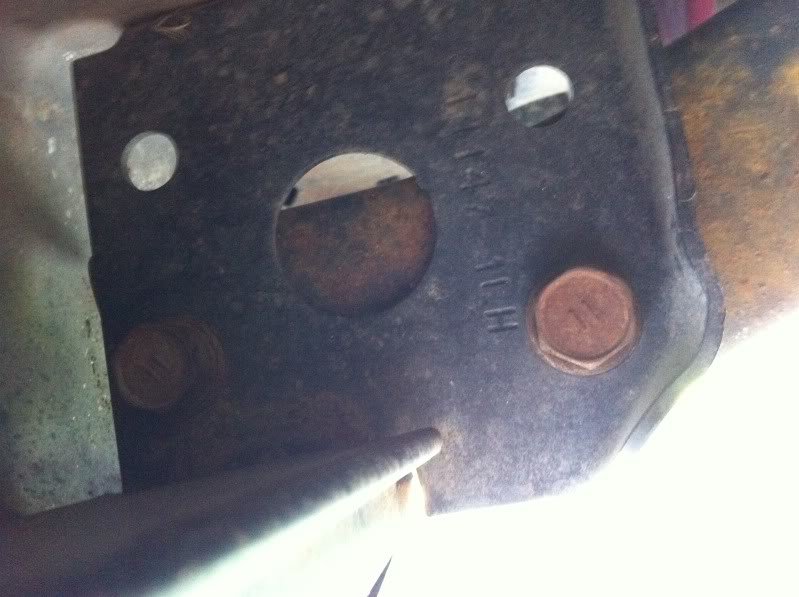

    When I replaced it I just took the four bolts (two per side) that attach the bumper to the two brackets that are bolted to the frame. The two bolts shown below:
    For the bolt furthest towards the back (the one on the left - driver's side) the best angle to hit it at was through the hole where the license plate light resides:
    Hope that helps

    >>For the bolt furthest towards the back (the one on the left - driver's side) the best angle to hit it at was through the hole where the license plate light resides<<
    NOW he tells me... took me quite some time to get those rearmost bolts out - never thought about going thru the lamp holder holes...
    Great tip!!

    I'm looking to replace my damaged rear stock bumper. Can you tell me what brand of bumper that is in your photo? I can't quite tell from the image.

    It's the All Pro tube rear bumper
