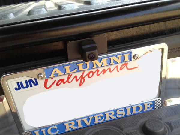

  14. May 28, 2013 at 10:44 AM
    Buell
    Buell Instagram: @thebuell
    Mar 27, 2011
    #53851
    1,255
    Michael
    Culver City/Santa Monica
    2011 TX Pro MGM 4x4 Tacoma DC
    Had a bracket built up and used the original housing for mine to relocate right above the license plate
  15. May 28, 2013 at 11:10 AM
    Seer
    Seer Well-Known Member
    Apr 7, 2013
    #101537
    222
    Tom
    Bayfield, CO
    13 Double Cab 4x4 stock
    Cool, what's it look like on the screen?
  16. May 28, 2013 at 1:12 PM
    #16
    Buell
    Mar 27, 2011
    #53851
    1,255
    Michael
    Looks basically the same but a little lower. We adjusted the angle down to make sure we had a good picture. Can't complain.
