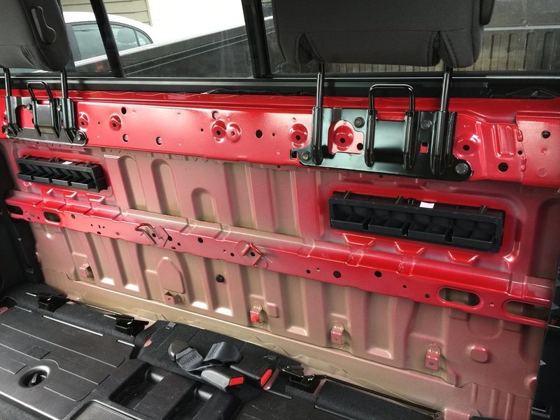

    Rear cab vents stuck open? Or water being unnaturally sprayed into them?
    Edit: vents in the back wall of the cab... visible with the bed off.

    Added subwoofer behind the rear seats that could be pressing onto those vents?
