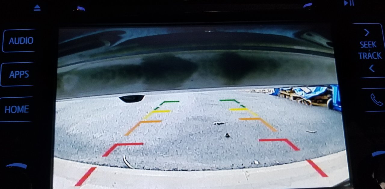

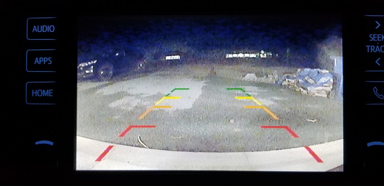

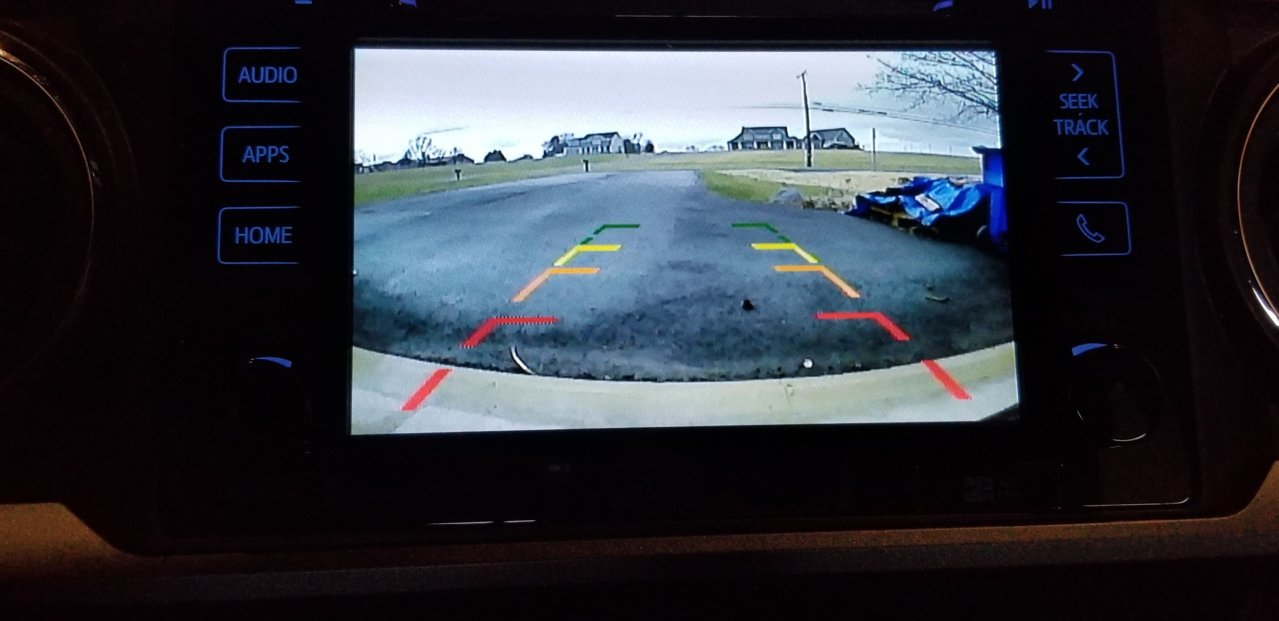

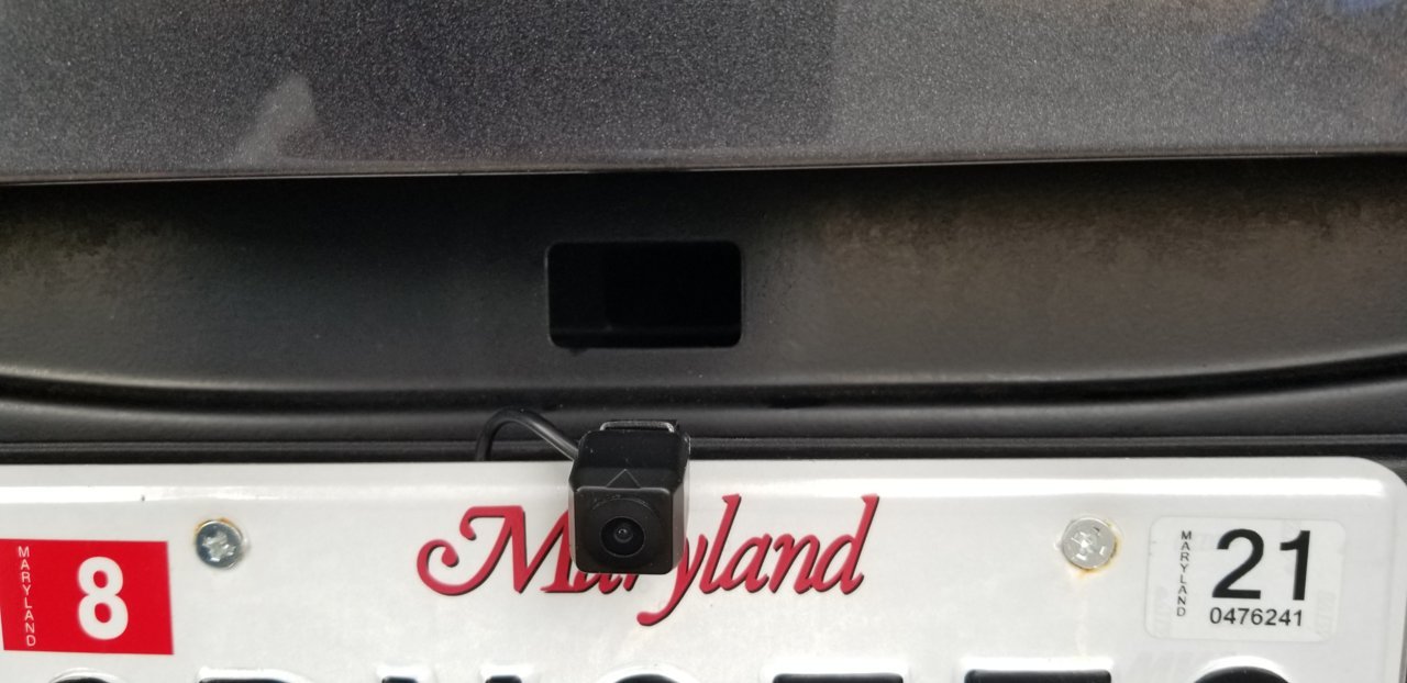

    Got the license plate backup camera today and it was a 15 min installation (plug and play). It arrived very quickly from the west coast.
    https://tailgatecamera.com/collecti...-tundra-hd-camera-kit-with-oem-wiring-harness

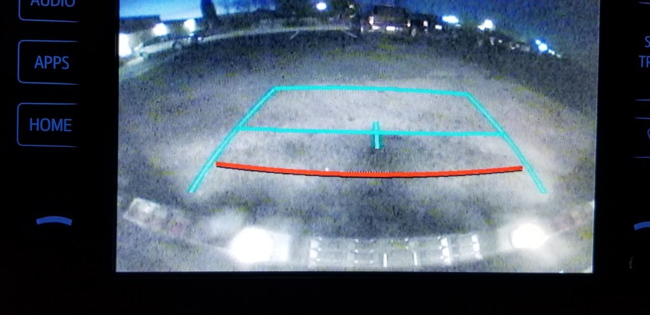

    This the original at night in daylight it's OK.
    New camera at night
    New camera daylight
    With the gate down (since I have a short bed I leave the gate open for the extra length.
    I find that it's better at night due to it does not face the license plate lights.

    You don't even need to remove the old camera I just plugged in the new one behind the license plate where the OEM plug is and used the blank plug that comes with the truck (for when you remove the gate) to protect the old set up. That way you can always go back to OEM.

    It comes 2 other brackets so you can screw on or stick and a few feet of wire but it's made to be centered.

    This bracket
