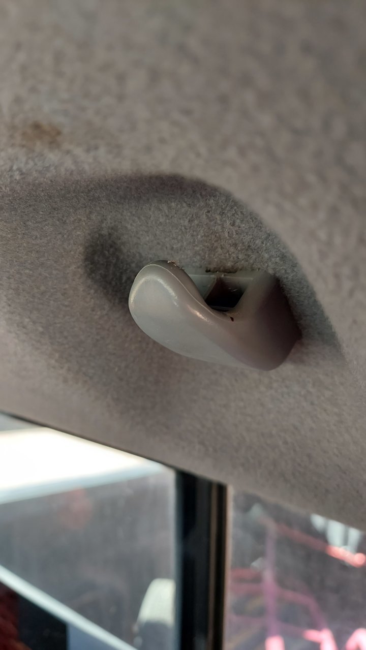

    Hey All
    Does anyone know how to remove the coat hook on an 06 Prerunner? I don't see any "screw covers" or anything.

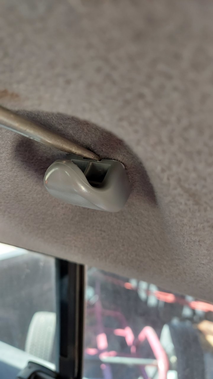

    Never mind. Figured it out. STUPID easy!
    If you don't know, get a flat head screw driver. Stick into the slot where the inside of the hook meets the headliner. Give it a 1/4 turn and pull.

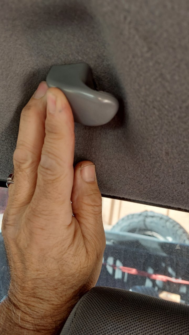

    Turn the hook 1/4 turn

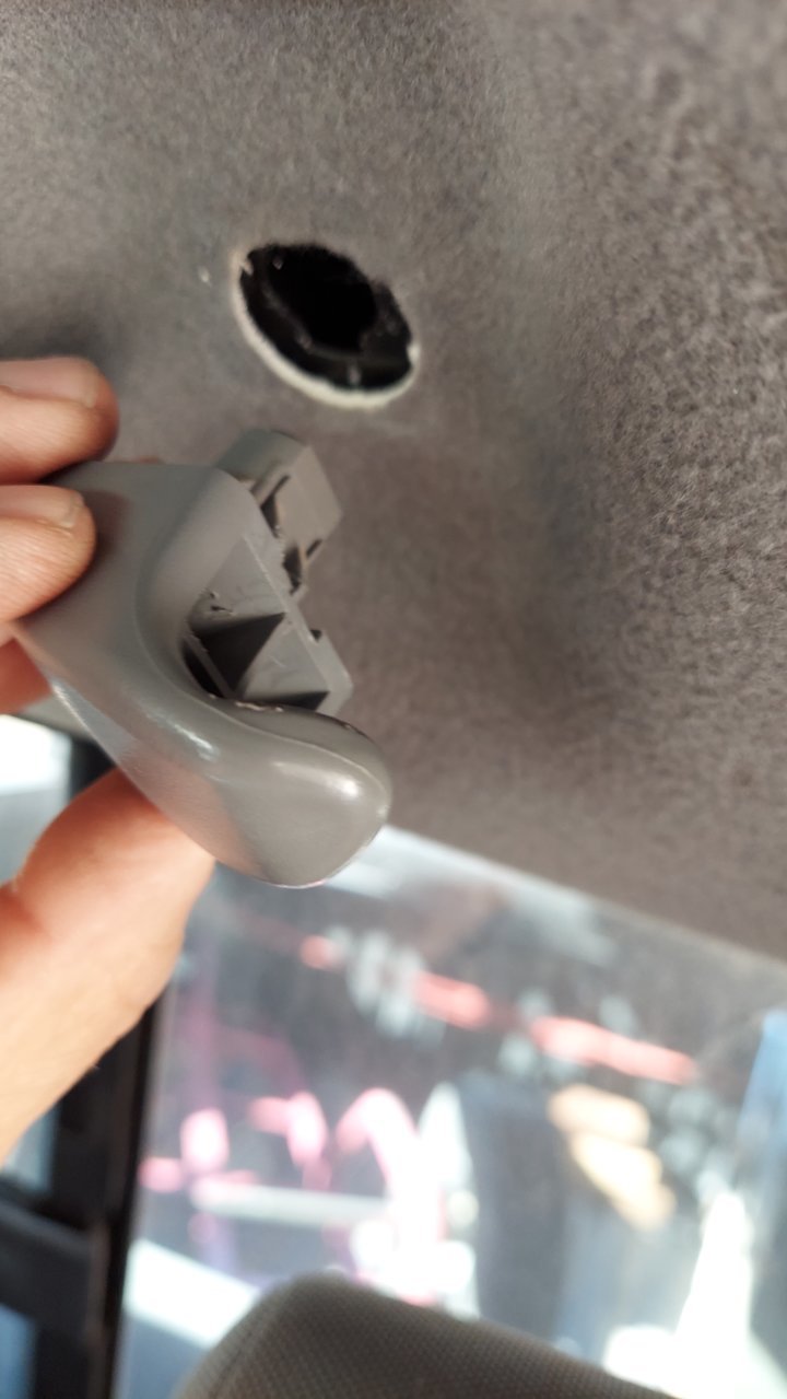

    Then with a firm grip, pull the hook out.
