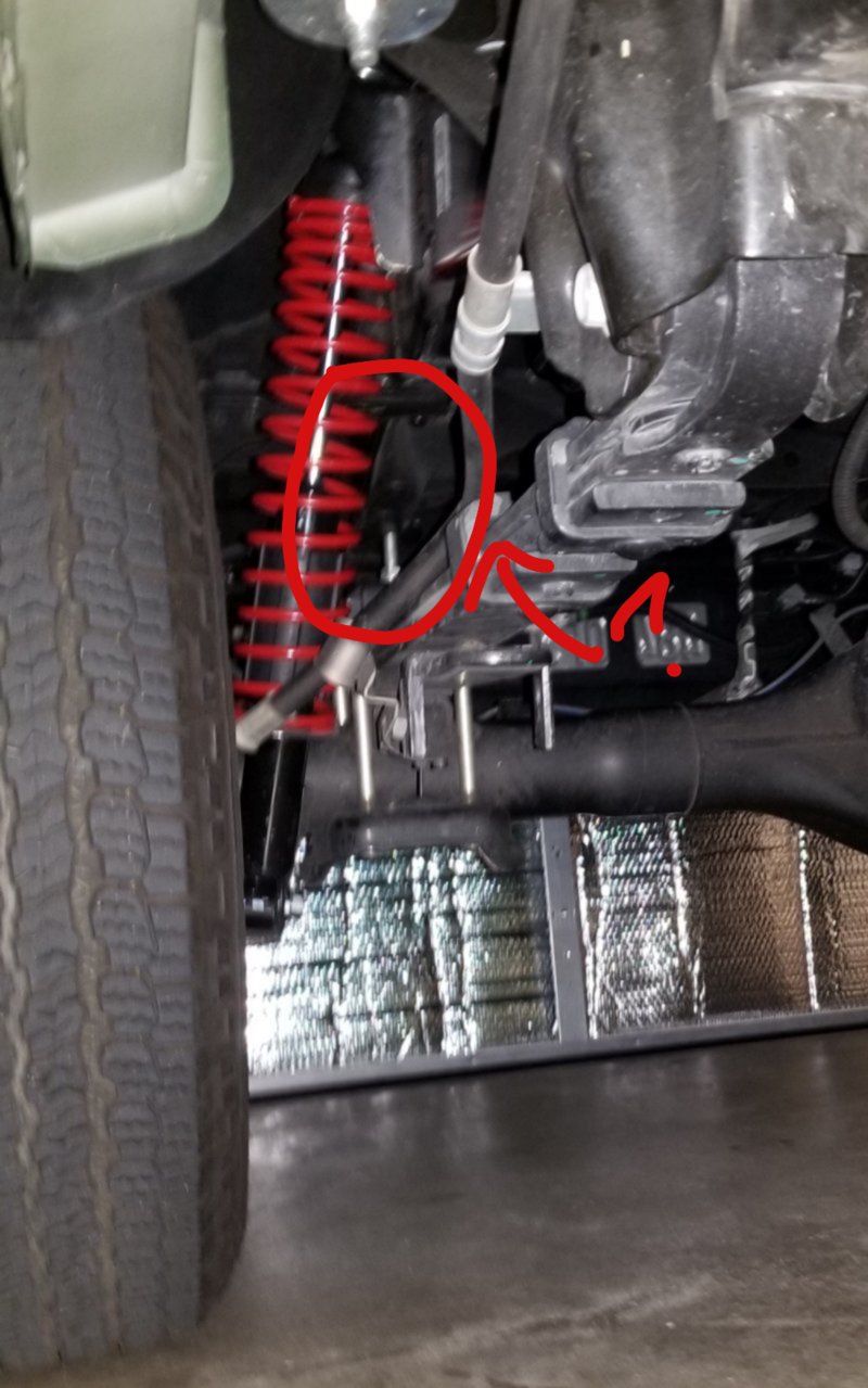

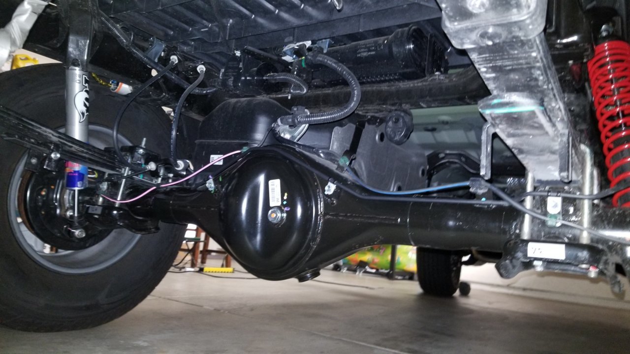

    20221224_111020.jpg 20221224_110930.jpgheres how it looks
    I jumped on the bed left side and right side and the right side with the coils is actually softer than the fox shock side on max stiff. Driving there no noticeable diff because we want the driver side stiffer to account for driver weight. It is super stable at speed and rides like a skateboard.

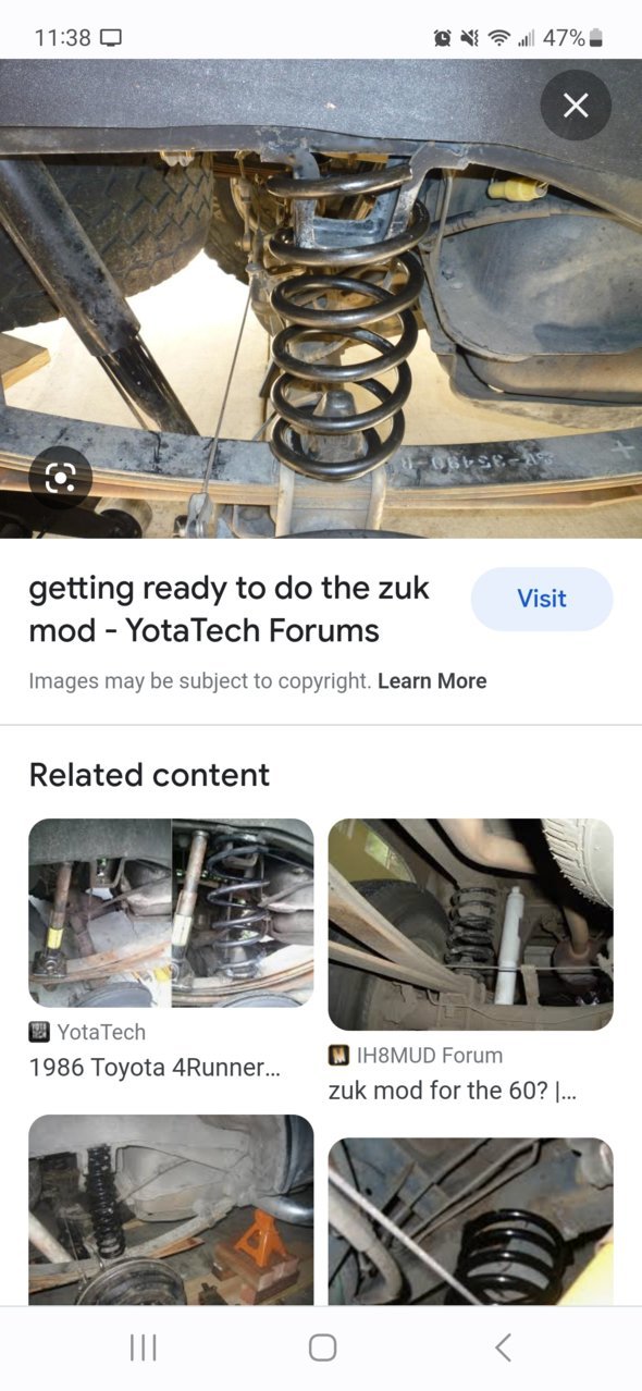

    10-15 years ago the "Zuk mod" was a pretty common thing to do. Basically wedge a 12" #100 coil in between the leaf and the frame, usually giving the oldee trucks 3" of lift and adding weight carrying capacity.

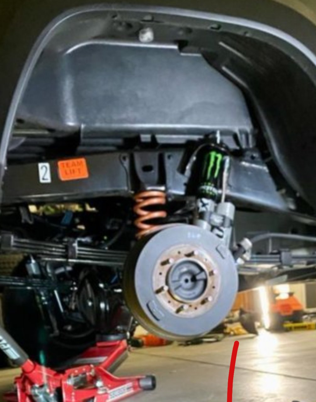

    Anyone else notice this mod?
    Bumpstop delete... And redbull can shock boot...
    Must feel real "planted" when that bolt punches through the frame.
    Just found a Monster can shock boot too.

    I’m more concerned about the engineering of the modifications. For example, using a shock mount point to carry the weight of the truck is sketchy; albeit it’s only a fraction of the weight if the leaf spring is left in place. A number of other design decisions also require some scrutiny. I’m confused what the goal is of combining a coil spring with a leaf spring. Couldn’t one simply install a stiffer leaf spring or weld a solid steel tube from the frame to the axle?

    Another concern of mine is the spring rate of the coil springs. Assuming they were designed for an IFS, they will be extra stiff to compensate for the motion ratio (about 2:1 on a taco). However, on the rear solid axle suspension the motion ratio is 1:1. There’s a chance that the coil spring is carrying more load than the leaf spring which doesn’t bode well for the shock mounts.
    To be done “correctly” the coil over should be mounted to some fabricated mounts on the axle and frame. There is a recent Dirt Lifestyle video on YouTube that demonstrates this idea. It’s in the one on trailing arms.
    I must be really bored to be giving this thread serious thought.
