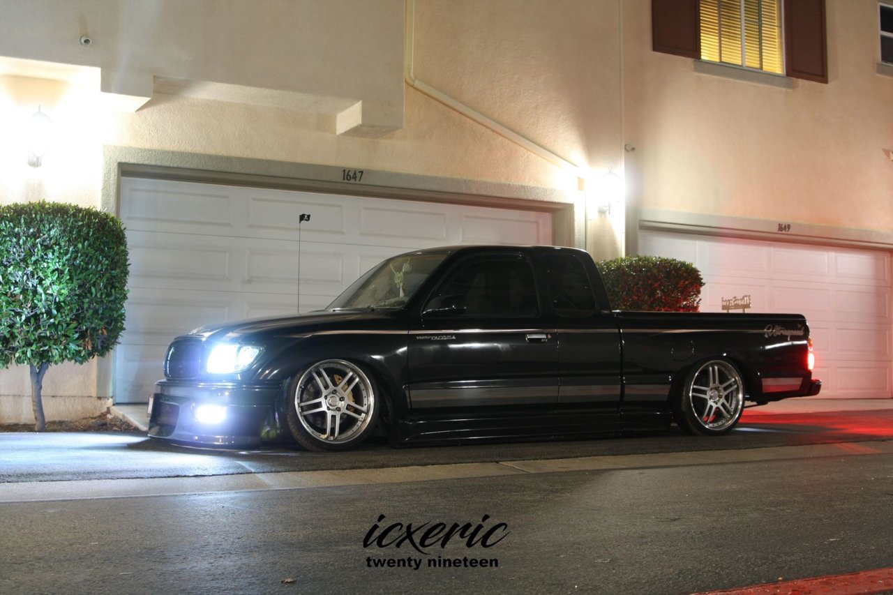

    there are a lot of options out there all being custom most relocate the fuel tank. if you want to lower it a little bit (i don't know how much is a little bit) just take your middle leaf out. that is good for about 3-4" I don't remember. I have a 4" block, 1" bolt on block and middle leaf removed and air'd out my bedside comes about 3/4" to my 19" wheels. 79115197_575940129616303_3919601005599129600_n.jpg
