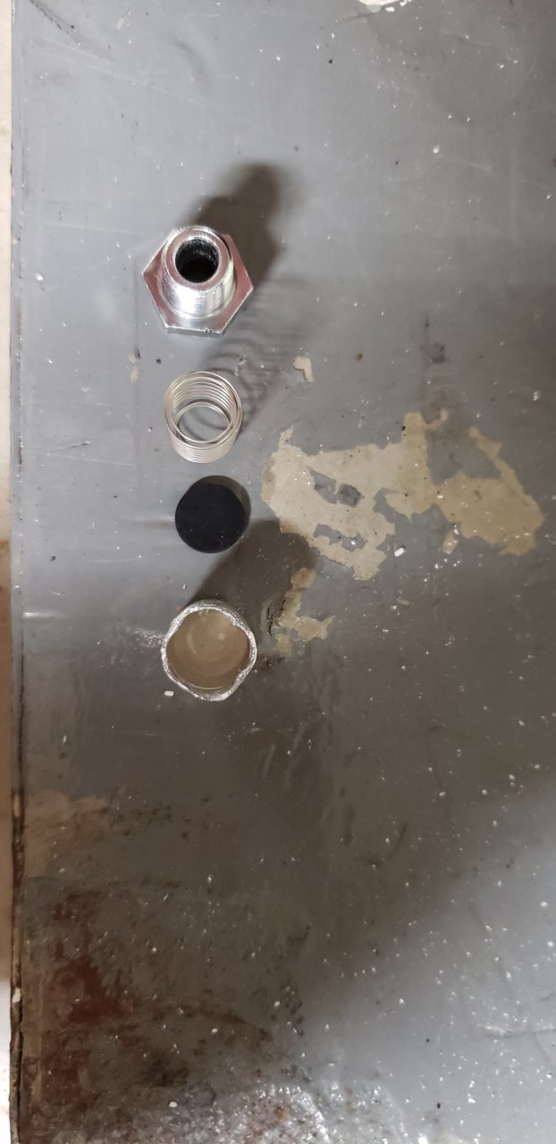

    What's the part number for the 2 way breather?, thank you. The dealer wants to sell me the one way...i think the two way is the only way. Does the state 48overland sell the addapter and the two way kit ?

    It has been a while since I did it and remember reading a lot of conflicting information on part numbers. I remember landing on these and they worked for me. I confirmed the breather was two-way (basically an open end with cap over it)
