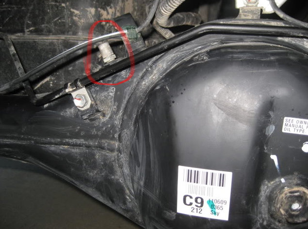

    all models have the breather sitting on the axle itself since the 1995 tacos and probably before that too, Im not sure if they have it extended on the 3rd gens but I don't think they do, not sure why they haven't fixed this yet if that is the case. Just look on your axle and if you see this thing, you should do the diff breather mod.

    The problem is that thing is not really a breather but is a one-way, spring vent.
    It will expel expanded gasses from inside the differential but will not let air in during a vacuum condition (caused when you drive into cool water when the diff is hot).
    When there is a vacuum, air (or water) will try to get into the differential to cancel the vacuum. It will do this by passing through the axle seals.
    A true breather, like what they put on the front differential, up high above a water crossing depth, will let air into the differential thus breaking the vacuum and stop the natural tendency for water to be drawn in through the axle.
