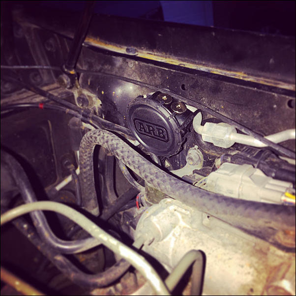

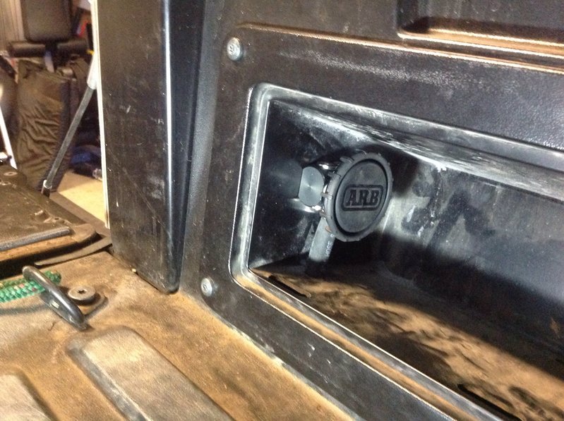

  14. Oct 20, 2016 at 9:29 AM
    #34
    MilkTeacoma
    MilkTeacoma Well-Known Member
    Feb 6, 2015
    #148023
    369
    I have seen behind the rear tail light. The ARB is really fancy, I am interested where you finally get to install it. Please share photos too. :thumbsup:
    Here is a quick search of what I found online.
    372705d1419085403t-what-did-you-do-your-_4b10e6233485dda66b06855c719103f4262f6209.jpg
